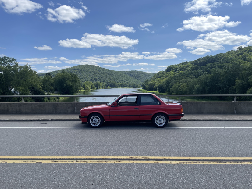

    I've had a bunch of people ask me to make one of these threads, so here goes.
    Click image for larger version  Name:	IMG_2115.jpg Views:	1 Size:	191.4 KB ID:	10152877
    Background:
    I've spent the last 4 years traveling the world, living out of a backpack. In early 2020, I was looking to move overseas permanently and had $30k saved to make the move. 2 days before my flight, all international flights were canceled indefinitely due to Covid. I knew lockdown would be more than 2 weeks, so I decided to pick up a good driver's car instead.
    I knew I wanted something analog and fun, and eventually knocked my list down to an E30 318is, a 944 S2, or a Miata. Since I wanted a car that could still do car things, that knocked the Miata off the list. And I happened to find a good E30 before a good 944.
    I bought this car April 1st 2020 with 94,6XX (correct) miles and zero rust. The cylinder head was cracked, the tach was wrong, and the exhaust was soaked with oil. But overall, it ran okay. The engine was kind of glued together with silicone, so I didn't know about the cylinder head at first. It had a wood shift knob but was otherwise totally stock. The car was owned by a doctor in Charleston, South Carolina, and left in storage from 2002 until I bought it. Upon taking it out of storage, I drove it home 1,915 miles with zero preparation.
    Factory options:
    Type AF93
    Model 318is - USA
    Engine M42B18
    Displacement 1.8
    Drivetrain HECK
    Transmission MECH
    Production Plant REGENSBURG
    Production Date 1990-6-28
    242 Driver Air Bag+series
    281 Lm-rad 6 1/2 X 14
    300 Zentralverriegelung Elektrisch
    410 Window Lifts, Electric At Front
    481 Sport Seats F Driver/front Passenger
    530 Air Conditioning
    556 Exterior Temperature Display
    925 Shipping Protection Package
    VIN:
    WBAAF9310MEE68640
    Color:
    Brilliant-rot (308)
    Interior Color:
    0192 - Natur Vinyl
    Engine:
    110k miles on the original M42
    Dsylva tune, 93 octane
    Baffled catch can installed
    All new OEM hoses and cylinder head
    Timing + Profile gasket resealed
    Upper and lower oil pans resealed
    "Mess under the intake" intentionally omitted
    Exhaust:
    Supersprint Catback, single oval tip
    Transmission:
    Getrag 240, manual 5 speed
    Brakes:
    OEM, fully refreshed
    Steering:
    Z3 1.9 steering rack
    E36 inner and outer tie rods
    New OEM rubber steering joint (NLA)
    One-piece Sparco strut brace
    Refreshed OEM power steering
    Modified sway bars intentionally omitted
    Rear strut brace intentionally omitted
    Suspension:
    Koni Sport Adjustable shocks, set half a turn from full soft
    H&R Sport springs
    E46 OEM rear spring pads
    Z3M Coupe rear shock mounts
    New OEM control arms, ball joints, rubber bushings
    Shifter:
    Z3 short shift kit
    Garagistic DSSR
    Full OEM shifter rebuild
    Differential:
    Small case 168mm LSD, S4.10
    Fully restored, factory 25% lock
    Treated with REM polishing
    Wheels:
    15x7.0 original BBS Euroweaves (1993)
    205/55R15 Yokohama Advan Fleva tires
    Interior modifications:
    New 370mm Mtech 2 steering wheel
    Bavrest custom cluster, KMH converted
    Continental TR7412UB-OR
    Maestro CS 6508 audio system
    ZHP shift knob
    Euro clock
    External Links
    The original sales advertisement:
    A featured article from October 2023:
    Online automotive forums are a treasure trove of information written by enthusiasts for enthusiasts. While they may not have the pizzazz of more modern platforms like TikTok, Instagram, YouTube, or whatever else the cool kids are using these days, forums still have deep roots in the online automotive community. Given the world wide web’s global nature—it’s literally in the name—many forum members will converse for years via detailed do-it-yourself posts or inspirational project threads, but […]
    Full photo album:
    Special Thanks
    - Advice, direction, and guidance: getouth, Jordan, mike.bmw, agent
    - Diff rebuild: https://danvillediffs.com/
    - Cluster work: http://www.bavrest.com/index.html
    - replacement cylinder head: roguetoaster
    - Mechanical work: https://www.facebook.com/RennSport-T...7854077915422/, https://www.bimmerbuddies.com/
