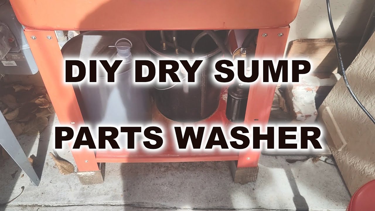

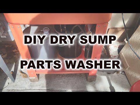

            • I realized that I was amassing lots and lots of parts, many of which weren't being labeled and put into storage because they're super dirty/greasy, and they were just piling up in a queue to be cleaned. So I've been spending the last month or so putting together a parts washing station. Never one to take the easy way out, I decided to modify the hell out of a Harbor Freight unit. Still a work in progress.
                  Well show us some pictures of this!

                      I'll post an update on the parts cleaner when it's up and running. My current project is planting a few trees in my yard to ameliorate the intense afternoon sun we get (especially in the summer). There's always another project, and it's just a matter of which one is top priority. Once the trees are in the ground I'll wrap up the parts cleaner. :)

                        It took me an absurdly long time to "complete" my parts washer upgrade, but it's finally "done" and ready to be shared with the world. You can check it out here!
                        As for the rest of this project, it will remain slow going for the time being. I have my hands full with some other priorities, and I always knew I was jumping the gun a little bit on being ready to take this project on. I am still slowly amassing parts, and once I start doing some of the subsystems I plan on posting them to video and keeping this thread updated.
