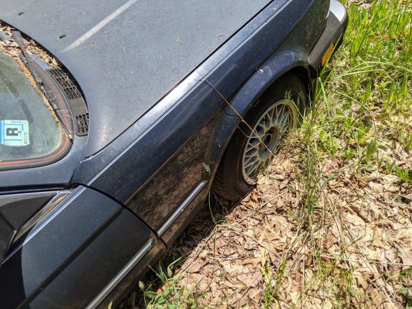

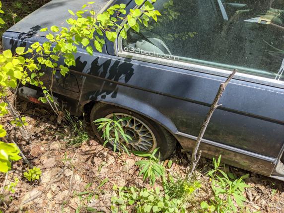

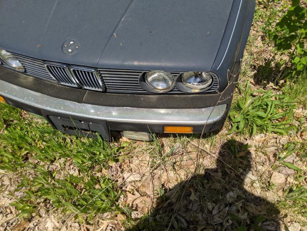

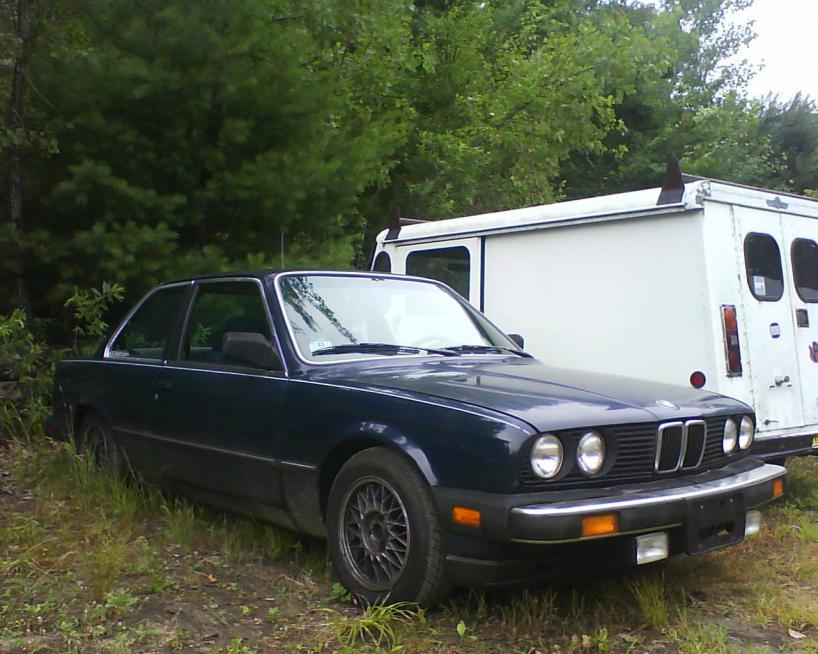

    So without further ado, here's the car in it's current state as photographed by my brother a few weeks ago:
    Click image for larger version  Name:	PXL_20210516_162421390.MP.jpg Views:	0 Size:	74.6 KB ID:	10021191
    Click image for larger version  Name:	PXL_20210516_162414843.MP.jpg Views:	0 Size:	72.9 KB ID:	10021190
    Click image for larger version  Name:	PXL_20210516_162406310.MP.jpg Views:	0 Size:	71.5 KB ID:	10021188
    Click image for larger version  Name:	PXL_20210516_162355143.MP.jpg Views:	0 Size:	48.0 KB ID:	10021187
    I think it's fair to say that only an enthusiast, and maybe only an enthusiast about this *specific* car would take on this project.
    Next month I'll upload more photos during my evaluation, including under the hood. I guess in the meantime: For anyone who's pulled a car out of a field and got it running: What parts do you wish you bought beforehand? I'm placing an order with FCP Euro for all the aforementioned stuff, but is there anything I need just in case or almost certainly as a result of sitting for so long? I assume the brakes and tires are all toast, but probably good enough to get the car on a trailer, which is that counts right now.

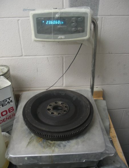

      Original (dual mass flywheel) was 23.6 lbs:
      Click image for larger version  Name:	1935871_600685464595_2981936_n.jpg Views:	0 Size:	47.0 KB ID:	10021258

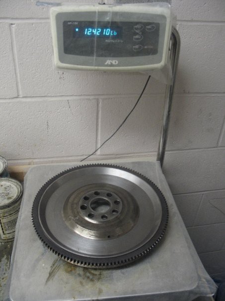

      And the single mass flywheel that I machined down, weighed before balancing and surfacing, so it would end up slightly lighter than this: 12.4lbs
      Click image for larger version  Name:	1935871_597638166405_454853_n.jpg Views:	0 Size:	53.6 KB ID:	10021259

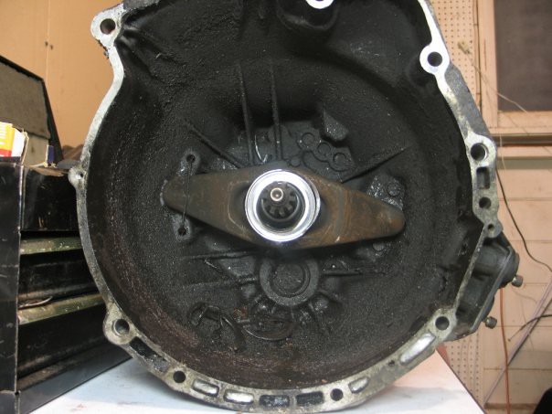

      And here's the state of the throwout bearing when I replaced it. I drove the car for a long time (a year or more?) with the throwout bearing on its way out. I drove it until it completely failed. Based on my facebook post from 11 years ago, when it completely failed it still sort-of disengaged the clutch, but it would stall the engine because of how much friction it caused. Supposedly I only pushed it once in this state. I recall as it was getting worse and worse, I started practicing shifting without the clutch. I vaguely remember when it failed I had to drive home a few miles, and I would shift without the clutch. If I came to a stop I would shut the engine off and then start it with the starter to get going again. Oh the silly things one does in college. These days I would replace the throwout bearing well before it gets to that point, but I'm also not a broke college student anymore.
      Click image for larger version  Name:	1935871_597638181375_443260_n.jpg Views:	0 Size:	69.6 KB ID:	10021260

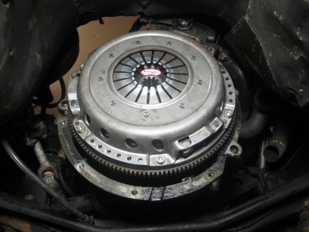

      Here's the new assembly of the e30 M3 pressure plate, flywheel, and a 6-puck clutch in there somewhere. Again this photo is almost 12 years old at this point:
      Click image for larger version  Name:	1935871_597638211315_3755655_n.jpg Views:	0 Size:	59.1 KB ID:	10021261

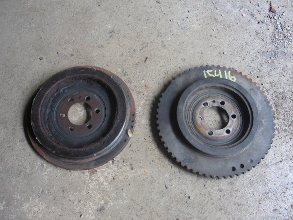

      So digging into old posts I see that it's not the flywheel that has the sensor/features for Megasquirt, but rather the harmonic balancer (which is at the front of the engine, rather than the rear). Quite frankly I don't remember this part. I know there's an engine speed sensor on the gear teeth for the flywheel on the eta cars. Not sure if it's present on the i cars, or if it's just the harmonic balancer.
      Click image for larger version  Name:	1935871_600685449625_2185079_n.jpg Views:	0 Size:	82.0 KB ID:	10021262

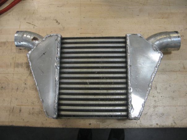

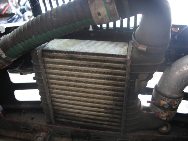

        I had used a Saab intercooler that was cluged together for a long time. This is almost embarassing to share, but again: broke college student, and hell, it worked:
        Click image for larger version  Name:	1935871_597752033215_5279777_n.jpg Views:	0 Size:	59.1 KB ID:	10021269
        When I did all the upgrades I took the opportunity to make and weld on custom aluminum end tanks. I suck at welding aluminum, but again, it worked. This fit very well in the space previously used, however it's small and may have been too small for 14.7psi of boost, hence the detonation issues I had.
        Click image for larger version  Name:	1935871_597752063155_4666505_n.jpg Views:	0 Size:	59.2 KB ID:	10021270

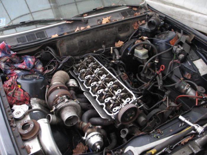

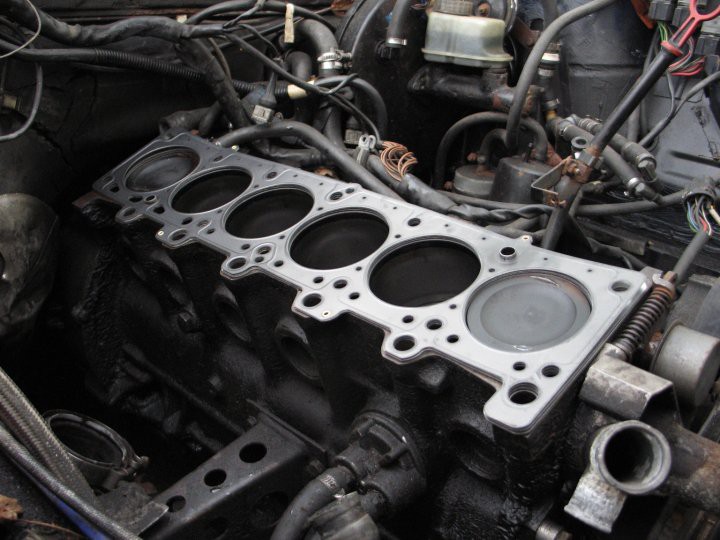

        I didn't get into it in my first post, but I actually blew the head gasket twice. Both times are probably a result of overtorquing the non-stretch head bolts I used, and consequently stripping out the threads in the cast iron block. I'm sure detonation didn't help, and maybe even contributed to the head bolt thread failure. In any case, as a last-ditch effort I put on an MLS gasket. So many people on the forums have mixed reviews of these gaskets. Lots of people seem to run 14.7psi on stock engines with stock gaskets without issues, there's no reason that my 2.7i stroker motor shouldn't be able to do the same. Thus when I go out to check the car out next month, if I can get to it, I will replace the MLS with a stock gasket.
        Click image for larger version  Name:	29481_640676991255_6500030_n.jpg Views:	0 Size:	97.6 KB ID:	10021272

          Any of the M1.1 or M1.3 cars just have the trigger wheel on the balancer. M1.0 and L-Jet cars were that dual sensor flywheel trigger setup

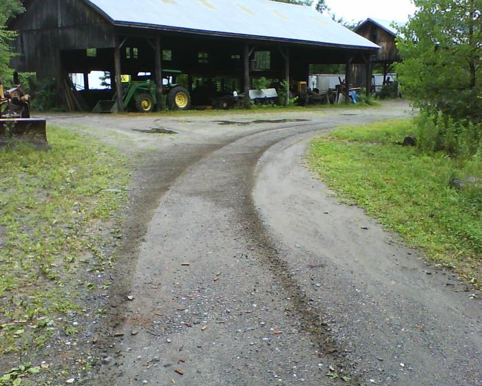

              Anyways I found this old photo, taken July 10, 2010 of when the car was parked in it's current location:
              lapis blue bmw 325e
              And this photo, taken 3 hours earlier indicates that I parked the car under it's own power (with a blown head gasket, but still running at the time).
              tire marks on dirt

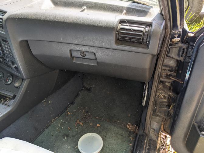

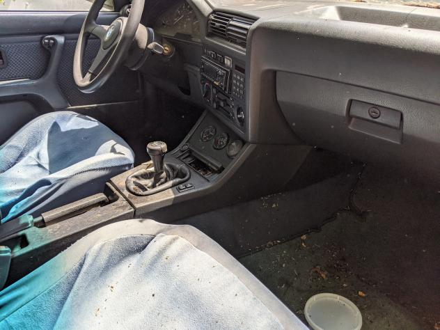

                Inside the glove box: What are the chances you think Megasquirt still works after being covered in acorns?
                Drivers' side footwell looks like a disaster. Lots of cleaning in my future. Right now I'm just hoping that the floor pans and carpet are salvageable, but both things are fixable if not. One of the reasons I want to salvage this blue car rather than getting a clean new one is that while I'm not sure of all the options, it always seemed to me like this car was optioned with most if not all of my favorite equipment, and all/most of it still worked: The curvy 3-spoke steering wheel (Not sure what it's officially called?), the On Board Computer, check control, power windows, power sunroof, blue cloth interior with sport seats. I'm crossing my fingers (but not holding my breath) that most of this stuff still functions as intended.

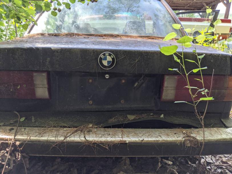

                Rear license plate panel: Way back in the winter of ~2009 or maybe 2008 some guy backed his truck into my car in a parking lot, immediately after I parked behind him. Apparently he knew there wasn't a car behind him when he got in his car, and then didn't check his mirrors and proceeded to back up - directly into my car. Could be worse I guess. I could have pulled straight into the space rather than backing into it. His bumper went over my bumper, and bent the license plate panel. Being a broke college student I took the $3000 insurance payment for other expenses and just chose to drive the car like it was (the trunk still latched/unlatched just fine. Anyways, I'll do a lot of the sheet metal repair work myself, but when it comes to stuff like this I'm almost certainly going to take it to a pro. I don't have the skill / patience for body work, and this car is likely going to get a full paint job when all's said and done, anyways. Will probably drive it like this for a couple years while I'm sorting out everything else in the meantime.

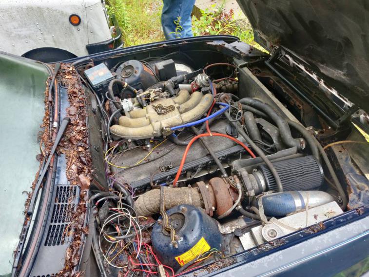

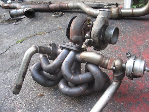

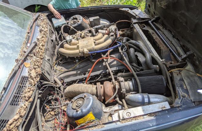

                Speaking of sorting out everything else, check out this rat's nest! This is what you end up with when your turbo build is built and modified over the course of time, and never really finished. One of my major goals for taking this project on is a significant amount of planning for the plumbing in the engine bay to make it presentable. If anyone knows any sweet tips for turbo coolant line routing and crankcase breather venting, those ones appear the most out of place. Pretty sure I can clean up everything else without too much trouble.
                The exhaust manifold was built for a garrett turbo with a tangential flange housing. My turbonetics turbo had a center flange housing, pushing the whole thing closer to the strut tower/wheel well than intended. Getting the right turbo in this location should help the plumbing somewhat.

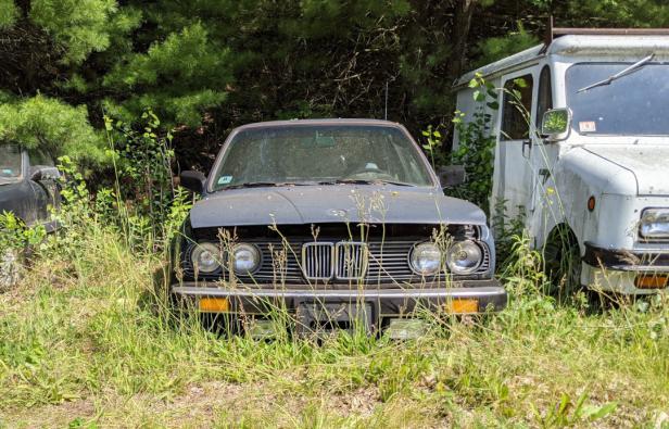

                And last but not least: A decent front view.

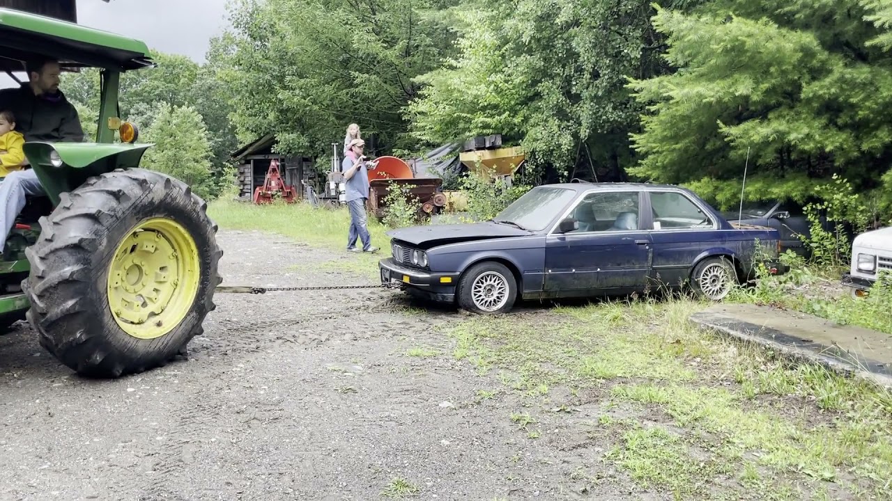

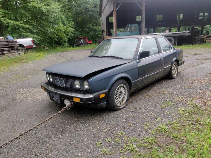

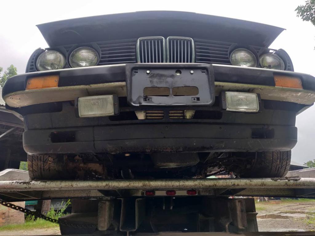

                              We pulled the car out of it's 11-year parking spot with the help of a tractor. Or rather, two tractors:
                              As you can see from the video, the front brakes were seized. When I got quotes from car shipping companies (~$2000 to ship across the US, for anyone wondering) they didn't seem to care that much if the car was not running (adds a little cost, but not much overall). However, they did ask if it "rolls, stops, and steers" so the bare minimum threshold is to get it to that point. I needed to get the car into my dad's shop to give it a once-over to see if it was worth restoring, and then get it into transportable condition. Ideally the car would also crank and possibly run, but that was not necessary.

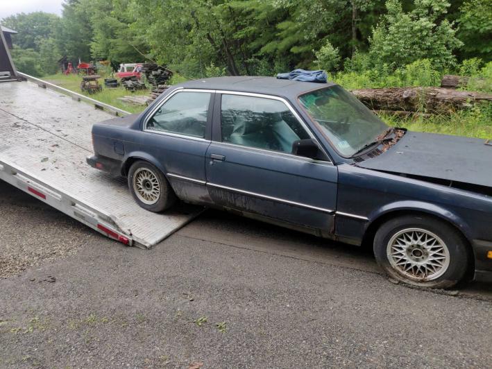

                              Once the car was "pulled out of it's grave" and a bit more exposed we could get a better look, including inside the trunk. All that stuff in the trunk is a mess of boxes of spare e30 parts and parts for another unfinished project (a Kawasaki KLR 650 motor that I was going to rebuild and never did, for those wondering). All those boxes got wet and the rodent treatment over the years. It was a foul mess. Also note the passenger's tail light sheet metal was bent in - Some guy backed into my car in a parking lot 11 or 12 years ago. I never fixed it.
                              Do I look unreasonably happy to have a rust bucket project?
                              Click image for larger version  Name:	IMG_1564_small.jpg Views:	0 Size:	86.8 KB ID:	10024531
                              Better view of the front of the car out in the open.
                              Click image for larger version  Name:	2021-07-08 11.13.11_small.jpg Views:	0 Size:	86.1 KB ID:	10024532
                              Loading it up on a truck to take it to my dad's shop. Growing up on a farm has it's perks: this is my dad's truck.
                              Click image for larger version  Name:	2021-07-08 11.51.37_small.jpg Views:	0 Size:	82.5 KB ID:	10024533
                              And finally loaded up onto the truck. Nice view of the little IC. I hear those fog light lenses are discontinued now. Glad to see they're still intact.
                              Click image for larger version  Name:	2021-07-08 11.54.39_small.jpg Views:	0 Size:	83.8 KB ID:	10024534
                              Next up: In the shop!
