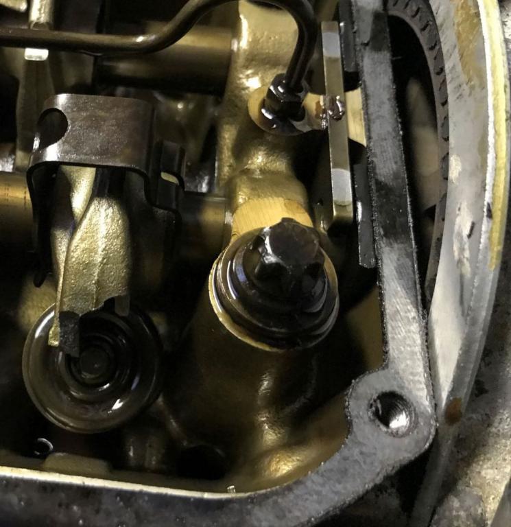

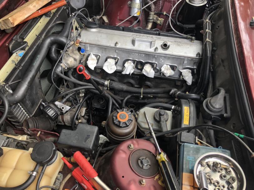

    I bought a 1990 325i back in October 2019 for 4500 bucks. Had been sitting a while needed to be gone over. Enjoyed it thoroughly until July of last year (2020). I broke a rocker arm while revving to 7,000 RPM. Got a new head and replaced it. Drove for a while but was slowly leaking coolant and weeping a small amount of oil from the head. I figured I had an issue with the seal of the head gasket. Removed the head and replaced it with OEM bmw head gasket. No leaks but I ran into a different issue. I threw all the rocker arm clips on the intake side and 4 of the 6 rockers walked on the shaft off the valve springs. Upon closer inspection it appears the retaining pin was bent and allowed the rocker arm shaft to twist. (this was exacerbated by me having the rocker shaft plugs in backward.)
    Anyway I'm waiting on a new rocker shaft bracket and I'll have this thing running properly and on the road for years to come.

    My rocker shaft retaining pin comes in this week, I'll update the thread when I get it in there, my old one was really bent pretty good

      The “bracket” 11331264677 came today. Check it out compared to the old one.
      this is the little clip that holds the rocker shafts in place at the front of the cylinder head.

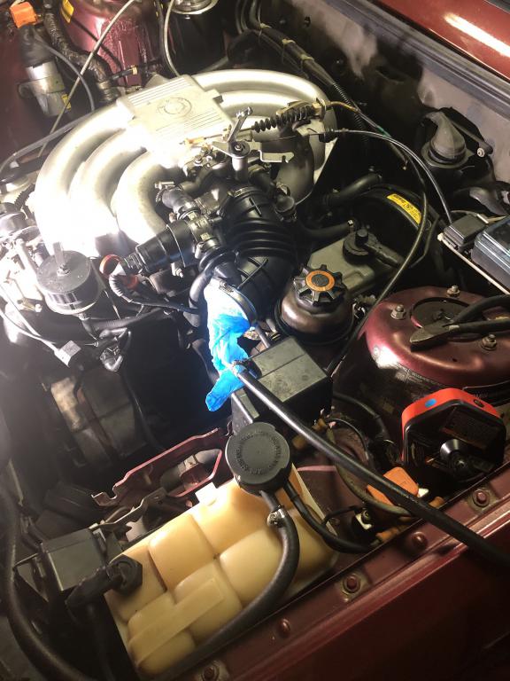

                  Replaced some things I had been neglecting and ran a smoke test this evening with troubling results. First I’d like to say everyone should get one of these cheap smoke test kits from eBay/Amazon. Mine was less than 50 bucks and I’m so impressed with how it performed.
                  new parts. A 170 dollar parts shotgun at the problem: o2 sensor, new intake boot, new coolant temp sensors new breather hose (goes under intake mani and into valve cover) icv hose.

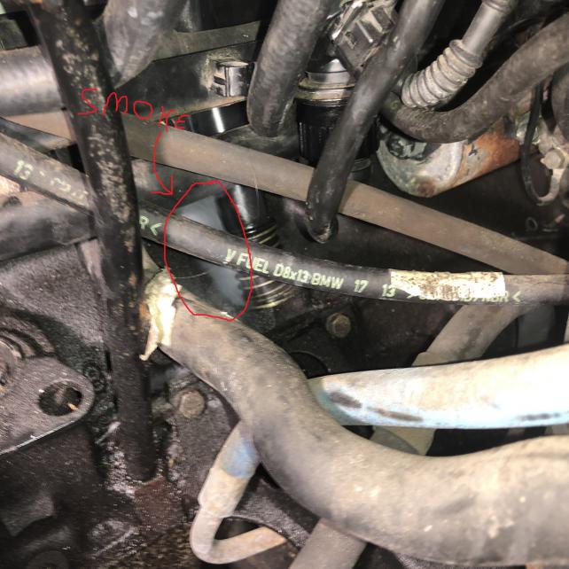

                  now the smoke test within 1 minute of getting up to temp revealed a huge billowing cloud coming from the oil return tube. I’ll post pics tomorrow.
                  so now the intake is going to come off and we’ll see what the problem was.
                    Here I am with he hose from the smoke machine in the intake boot. Have the throttle body wedged open with a wrench.
                    the oil return tube emitting plumes of smoke looking like Spicoli's van lmao

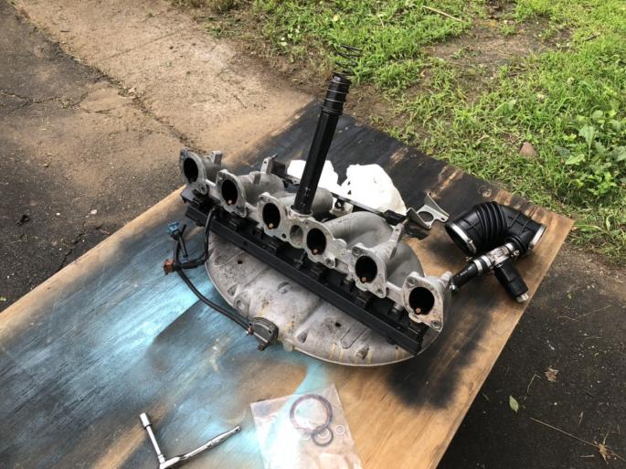

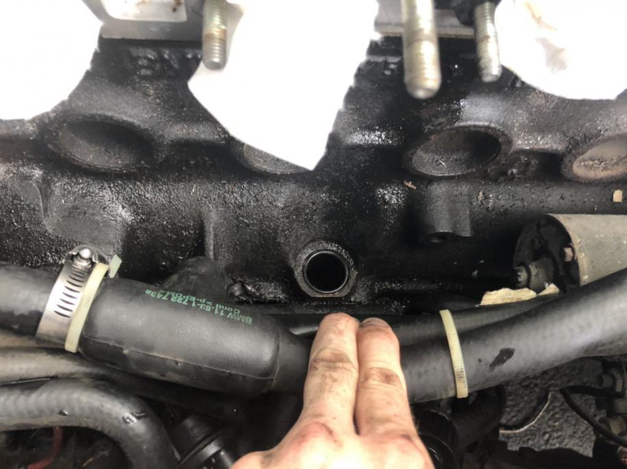

                        Got the intake manifold off and sure enough I was missing the bottom o ring. Ordering new IM gaskets to be safe as well as a new valve cover gasket as it looked like a had a leak from there too when I smoked it.
                        Parts come Wednesday will get her together the end of the week and check back in.

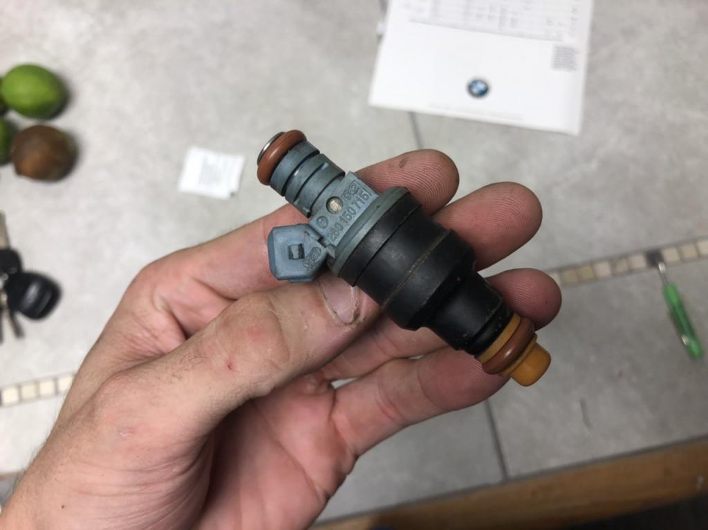

                        alos I pulled the injectors and out and replaced the plastic and rubber parts with a rebuild kit I bought on eBay. The “caps” are different than the old ones, should I try to source more original looking version with the ribs on the side?
                        • moatilliatta
                          • 6152
                          I’d just consider new Bosch Gen III injectors from five-o Motorsports.

                            After a long series of busy weekends away from the car I got everything buttoned up today and must say it’s so much better. Idles around 750 no more stumbling, no more hunting just silky smooth.
                            what I replaced:
                            o rings on bitch tube
                            intake manifold gasket
                            hose from icv to throttle body
                            hose from throttle body to valve cover
                            valve cover gasket and end plugs
                            temp sensor plus
                            injector filters o rings and caps
                            o2 sensor
                            a lot of that is routine maintenance stuff I needed to get to. the biggest culprit to my poor running was the bitch tube leak and leaks from the other hoses mentioned.

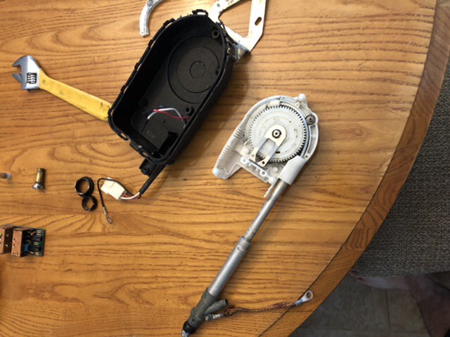

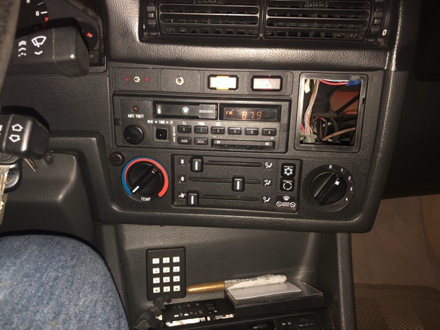

                              have moved on to other matters - rebuilt the power antennae and got it in just this evening. Radio is still a work in progress. Now that I have the antennae working I’m getting nothing but a loud static. I can tune in to stations (with my now working power antennae) but there’s a persistent banging static. Same is true in tape mode.
                              I have always had trouble with the speakers. For instance sometimes the rears work, sometimes just the fronts, sometimes left side, sometimes right side. There is a lot of dodgy wiring in this car. I looked at the radio and it appears that a switch (seen in the blank panel) is wired into the white wire for the radio. I’ll get pics of this later. But when you switch this off the antennae goes down yet the radio unit stays lit. I’m guessing this is some sort of bypass to run the CD player which has its own controls mounted to the ash tray.
