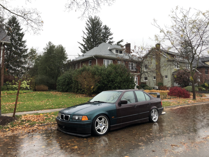

          Originally posted by hochiminh
          I've always liked this pic. Clean enough to have a little class, but beater enough to ask if a 17yo Edgar has a payment on it. Something about tidy beaters are so enjoyable, like the OG variant of Roadkill's 68 Charger before they did the Hellcat swap.
          Absolutely, the multicolour had a vibe for sure! At least it still lives on in the project name.
          I like this shot too. Shame that I didn't have the rear wheel fitment sorted yet here:
