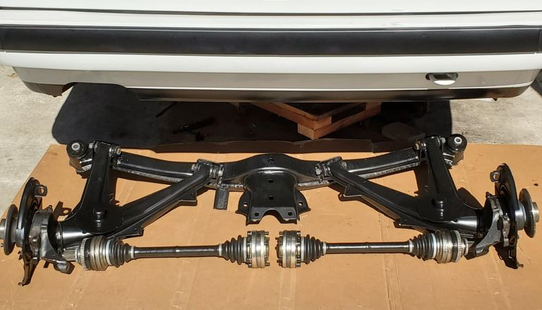

    Next up was dropping the rear subframe, totally not necessary for a suspension refresh but I decided I wanted to run street polyurethane bushings. I disconnected the driveshaft, took out the two main subframe bolts while the differential was supported on a jack and it came right off!
    The trailing arms and differential disassembly was straight forward. The diff was unacceptably dirty and clearly needed new seals and a thorough cleaning. I put the diff in a de-grease bath and scrubbed, and scrubbed, and picked, and scrubbed and scrubbed some more until I was satisfied all the grime was off of it. As for the subframe I spent several nights researching how to remove the old bushings and ultimately decided to just burn them out!
    Now I had all of the parts I wanted to have sand blasted off the car: Subframe, Trailing Arms, Brake Dust Shields, & Differential cover. I had them professionally blasted and brought them home for primer and enamel coating (besides the diff cover). I also took some time with a brush wheel and brushed/cleaned the under carriage (incredibly dirty job!) and then sprayed the undercarriage and wheel wells with a rubberized undercarriage rust shield spray (or) black enamel for bare metal parts, I didn’t get any pictures but it looks brand new!

    I ordered new front and rear bearings and restored the original rear hubs by de-greasing and wire-wheeling them, one of them had a bearing sleeve stuck on it that I had to use a cutting wheel to get off. I then re-assembled the rear subframe with the new bushings and re-mounted it to the car without the differential attached (I regret not putting the diff back on while the subframe was off because the 6 bolts that hold it to the frame turned out to be a PITA to get re-seated) I then pressed the rear bearings into the trailing arms using the same rent-a-tool I used to take them off with using techniques I learned on YT.

      Nice work. Would have been a good time to reinforce those trailing arms, or replace them with a reinforced set, but really solid work either way.

          Thank you! Yeah I started calling around asking for local shops to quote me for the re-enforcment but they all came back a little high on price and wanting like 6 weeks to get to it...I decided to fore-go the re-enforcments for now. Wish I knew how to weld!
