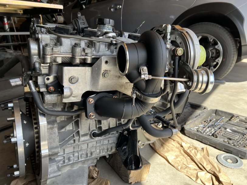

          Still making progress. Now that the engine is back together I got the adaptor plate installed for good along with the flywheel. Click image for larger version

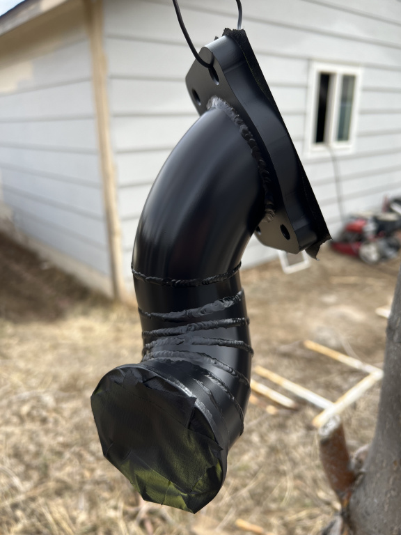

          Waiting on a clutch alignment tool so I've been doing some painting. I coated the exhaust parts in Cerakote ceramic coating. That was quite the process as the parts have to be meticulously clean, then you sand blast them, clean again, then paint.
          I ended up doing it all myself with the cheap harbor freight outdoor sandblast gun and touch up paint gun. It seems to have come out great, we will see how it holds up.
