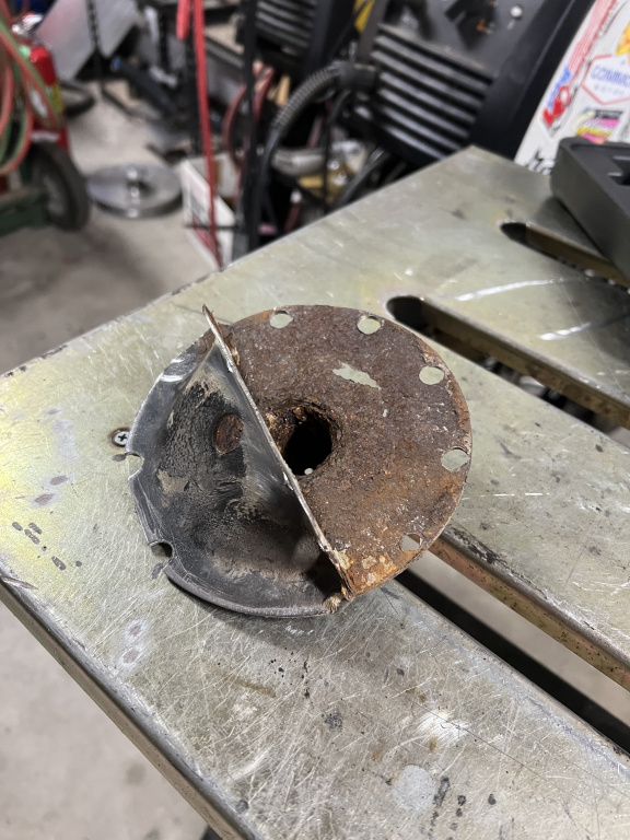

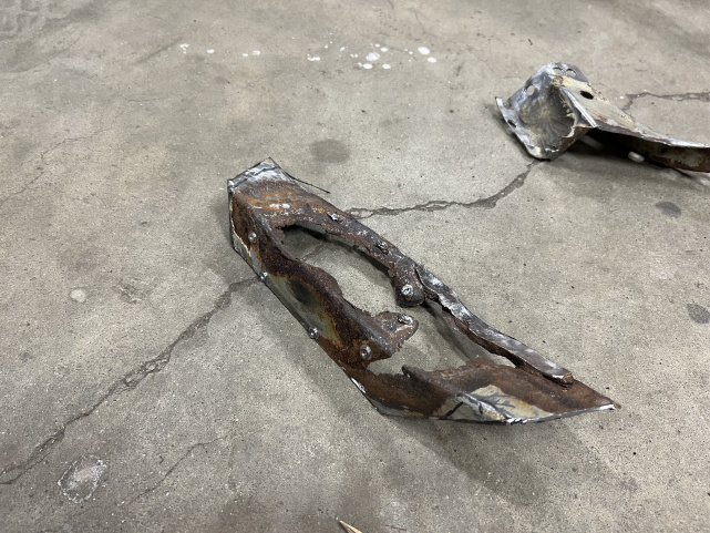

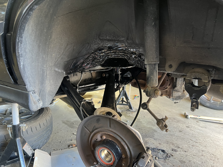

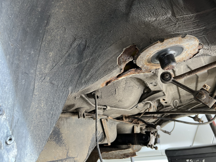

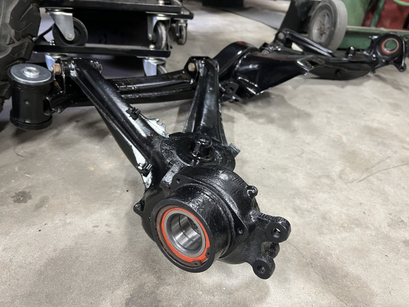

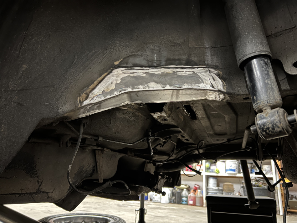

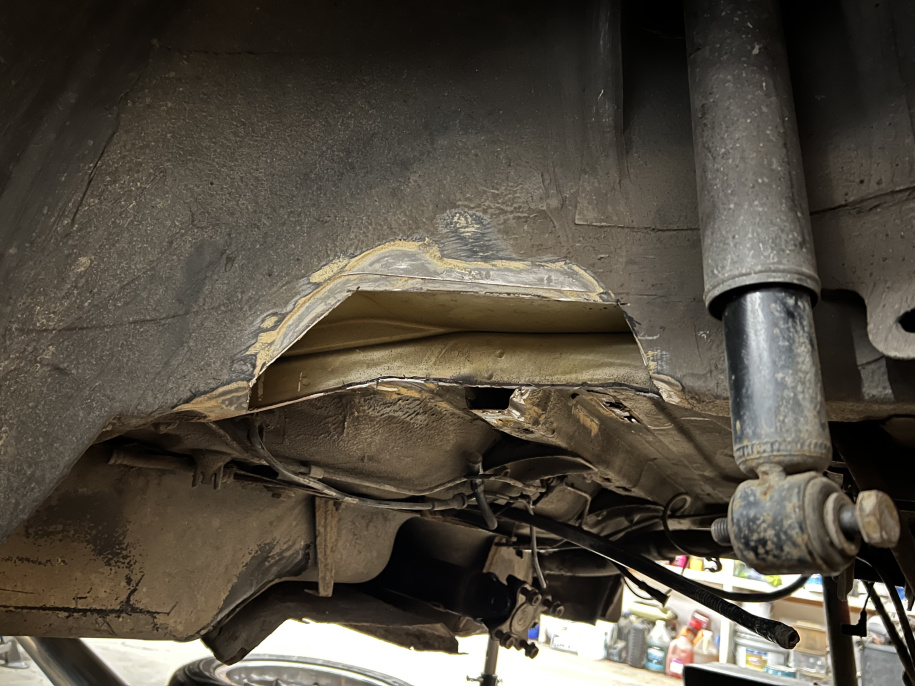

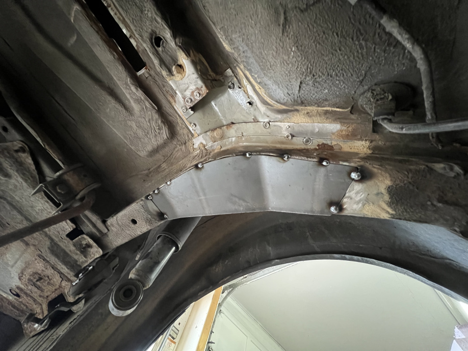

                  I did find a bunch of rust on one of the rear spring perches when I was refreshing the rear subframe/swapping the diff to the 2.93. That was really fun to deal with but I got it fixed.

                    More from the rust repair.
