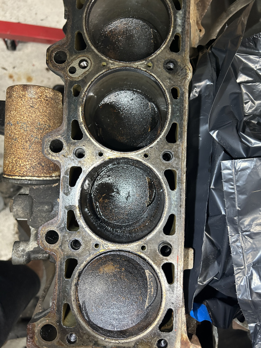

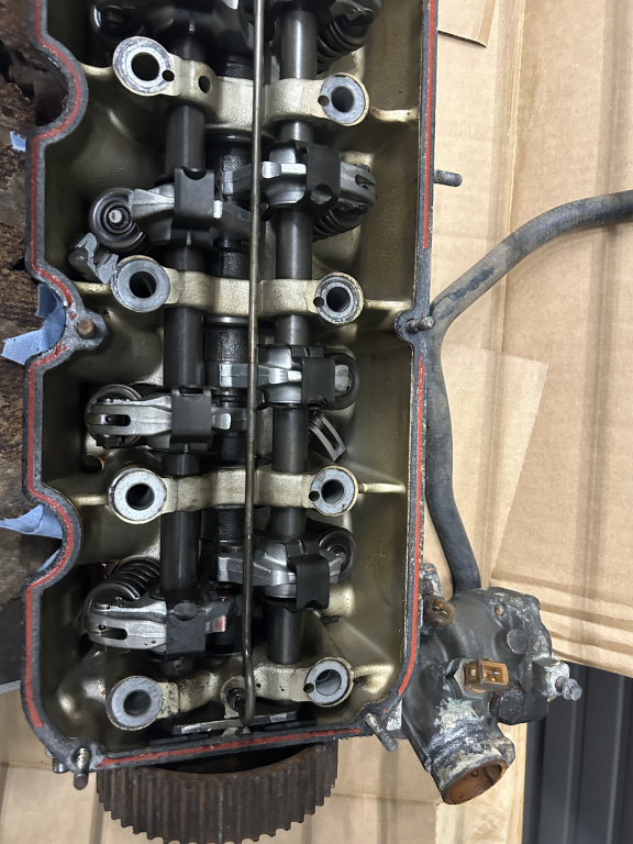

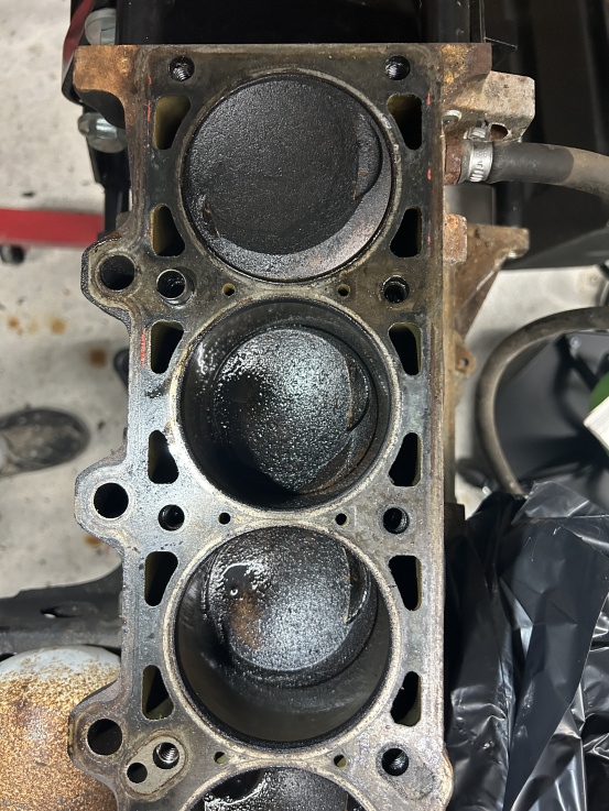

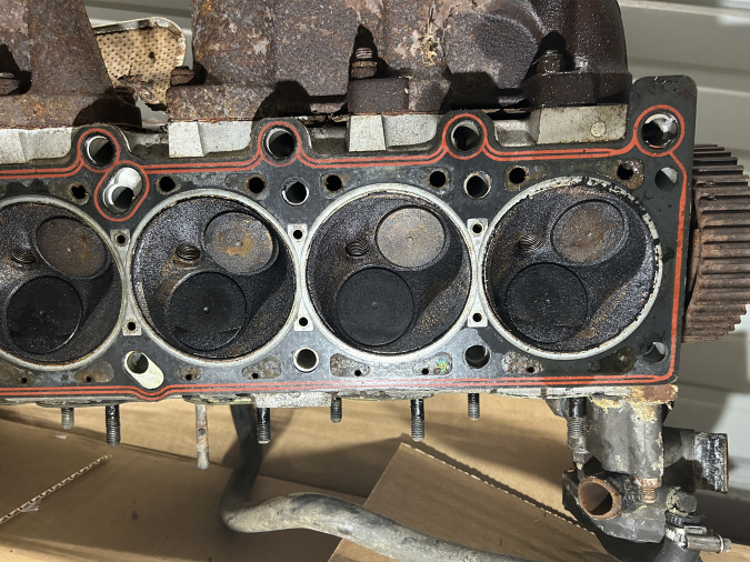

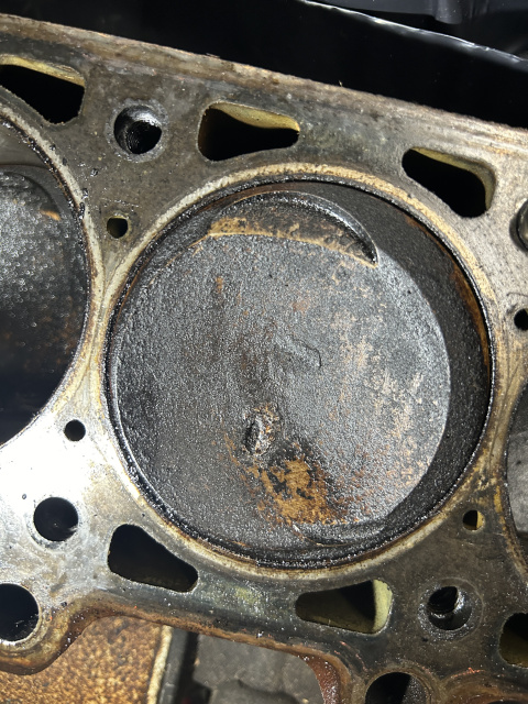

          Well after getting everything torn down and getting ready to work on the belt I realized that the belt was broken. After a day of crying I pulled the head to see the damage.
          Looks like 3 broken rockers and a nice hole in the piston. Luckily I have a spare block that I can use.
          What does a rebuilt head go for ? Would it be more cost effective to do it all locally or send it to a specialized rebuilder ?

            Inside that head looks suspiciously clean and the rockers look even more suspiciously cleaner.. My guess is, that is the second TB snap for the motor...
            If the Rocker Shaft Journals check out ok, and thickness is "OK" I assume the head is good for another round. Everything needs triple checked considering this could be a multiple offender.
            What part of the country are you in? I assume South East if you're motivated to build a spec E30..

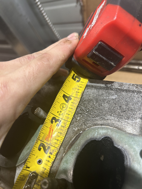

              Yeah that was my guess too, I just finished pulling the rockers, shaft and cam. Still waiting on a tool for the valves.
              I took a measurement of the thickness of the head and got 5 inches not sure how thick it should be.
              I am in jacksonville FL
              • moatilliatta
                • 6124
                Should be 6 inches.
