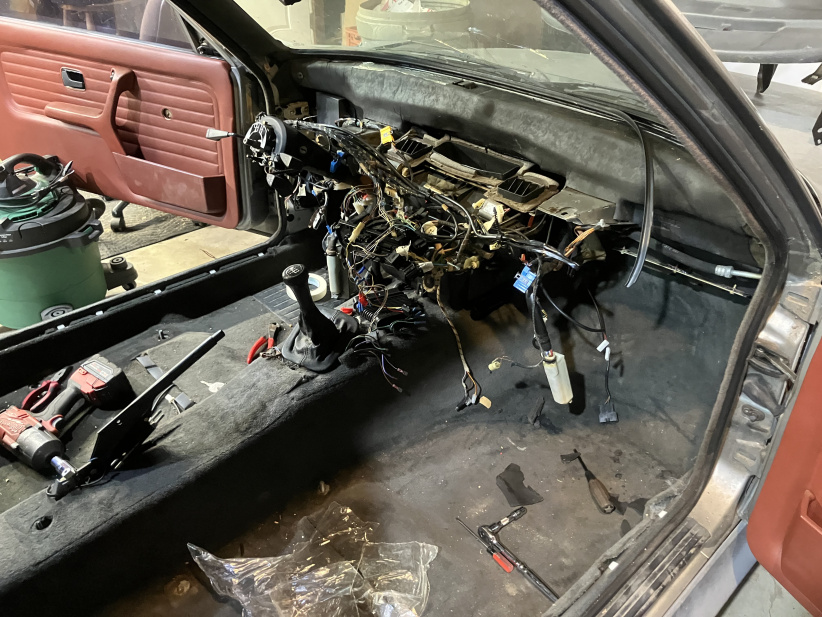

                      Got the dash pulled and hung my hood on the wall. Thanks grandeswag for the idea.
                      I feel like I should've had the HVAC box out yesterday but I wasted way too much time dealing with morons on marketplace. Trying to sell SRT parts from a 300c I scrapped. Never touching a mopar car again ever.
                      Working on the HVAC box tonight hopefully.

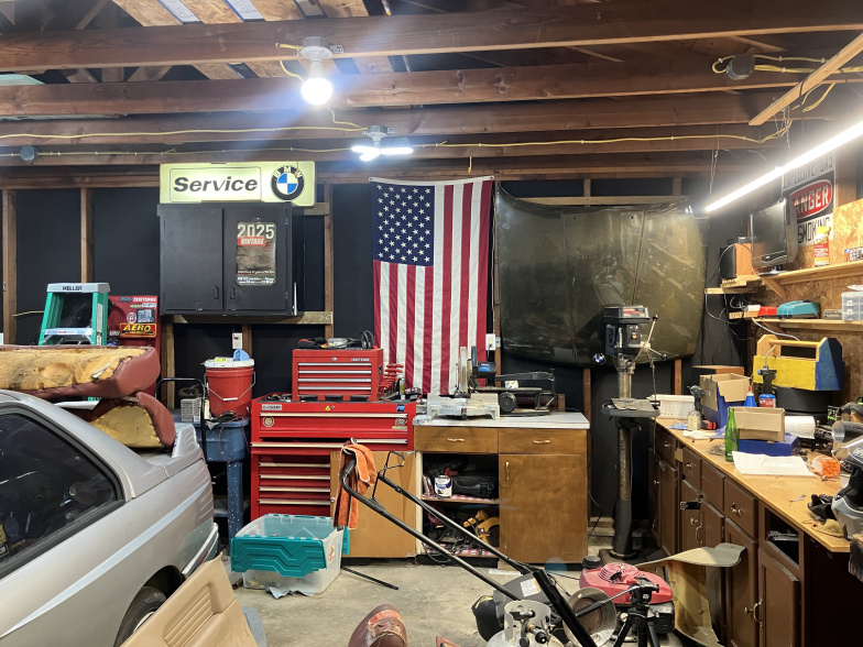

                      I desperately need a shed and some time organizing. Get stressed just looking at the mess.

                        That's a nice big workshop you've got!
                        What about putting down some plywood across your rafters to make space for light stuff? (seats, door cards, carpet, etc.) That and some organizing would give you plenty of usable space.

                          I already have stuff up there haha. It has to come down when I eventually insulate and put a ceiling up. I need to get rid of junk.

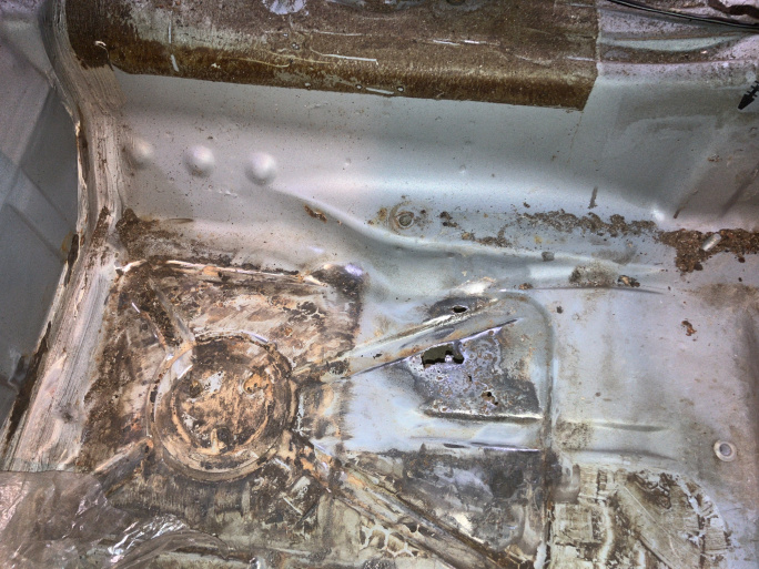

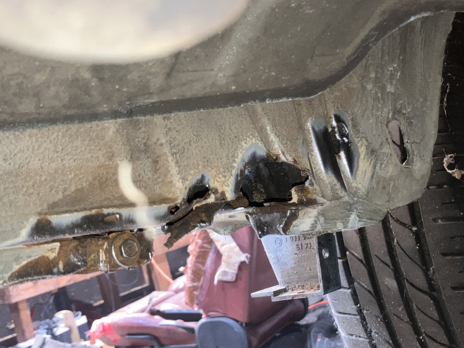

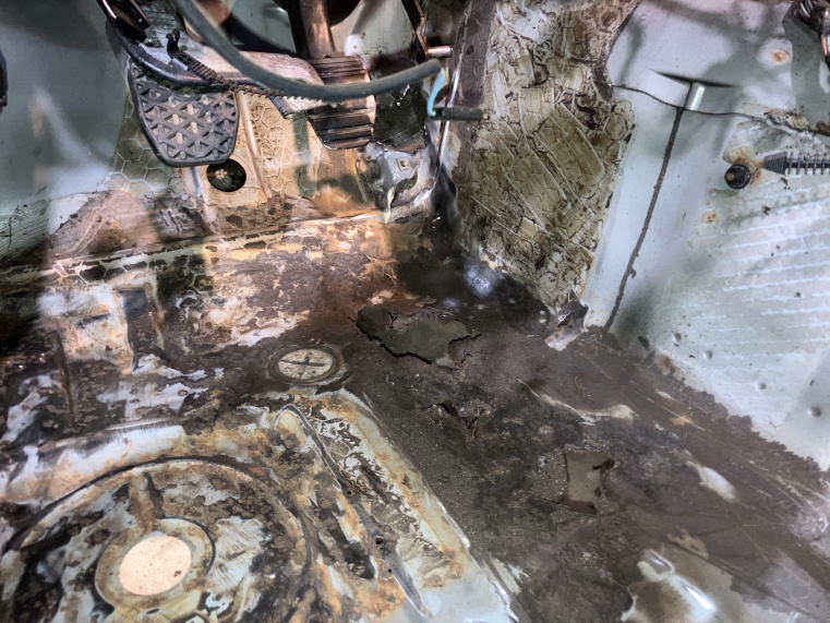

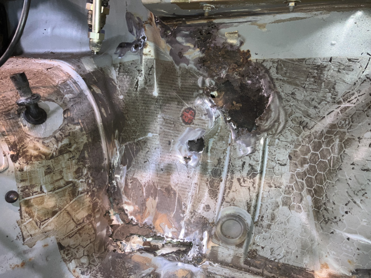

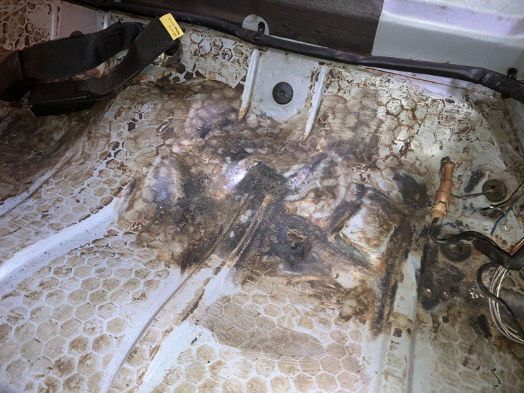

                            The car is rusty. I got every spot I could find cleaned up enough to see how bad it is.
                            Click image for larger version  Name:	BgvFNY2.jpg Views:	0 Size:	253.9 KB ID:	10152239
                            Click image for larger version  Name:	TYbIRnO.jpg Views:	0 Size:	217.2 KB ID:	10152242
                            Click image for larger version  Name:	I9NJ0MW.jpg Views:	0 Size:	251.5 KB ID:	10152243
                            Click image for larger version  Name:	8DCE2kB.jpg Views:	0 Size:	282.8 KB ID:	10152244
                            • patrick88m3
                              • Nov 2025
                              • 55
                              I guess the next steps are going to be order floor pans, a bead roller, air hose, filter/regulator, and some air tools. Can't do much with an angle grinder in some of these spots.
                              May be a while of no progress because I also need to buy Christmas gifts and whatnot. Since the engine needs to come out to patch the firewall, I could set up a fuel pump in a bucket and try to start the thing.
                              Would like to try before it comes out.
                              • McGyver
                                • 4636
                                That's a lot of rust, but it still seems manageable.
                                Assuming the engine turns over by hand, I would definitely try to start it before pulling it. Check the oil and try to prime the oil pump before starting it, hopefully it just fires up!
