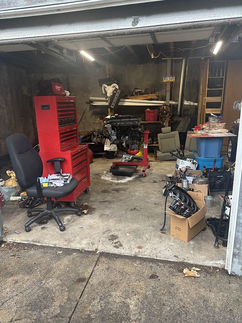

Then I organized the garage a little to work on the M52
M52 upside down to do the oil pump nut, pickup, gasket, pan

And here are the engines side-by-side. The crappy part of the timing was that I had just finished doing ALL the gaskets on the M52 and was about to install the exhaust manifold. Good news is... S52 makes me happy. So had to play some juggling with getting the m52 off the stand and the s52 on it.

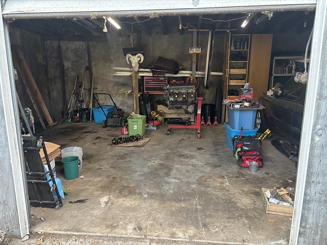

Also, at the same time decided to move my toolbox that was in my laundry room to the garage as I was getting fed up with my garage setup. Now I actually use the toolbox like you're supposed to do.

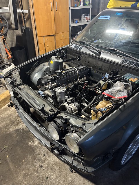

S52 accessories all done. Also mocking up the A/c compressor, as I am going to actually get the a/c going in this version of the car.
Cleaned up more, but almost ready to drop it in
Trans going on

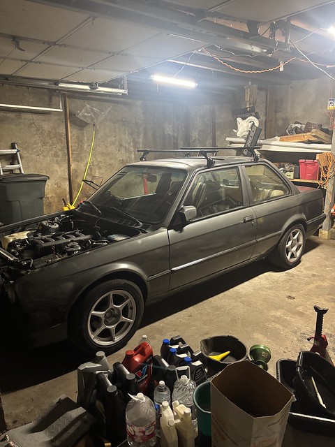

And we have landing. I didn't stop for too many action shots. I did the drop-in solo again. However, learned from the past two times. I took off the sway bar and bolted the downpipe from the headers onto the engine before dropping in. This saved so much headache of having to secure the downpipe while in the car. Can't believe I didn't just remove the sway bar before. Took less than 15 minutes. And dropping in the engine only took like an hour.
Not pictured... but
1) got the shifter linkage sorted
2) bolted trans to chassis, and torqued down engine mounts
3) hooked up power steering lines to pump
4) got the e-fan, coolant hoses, and radiator all buttoned up
5) Then wiring harness all connected

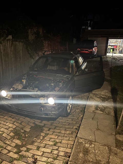

Did the pivot in the garage to get the car out

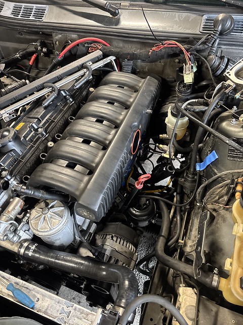

First test drive went ok... have a couple issues I need to address:
1) Getting codes P1188, P1189, and P0170. This all points to fuel/air mixture. Guessing I have a vacuum leak somewhere. So working on diagnosing that.
2) I'm also getting a horrible shake when I come to a stop and idling. Doesn't happen at startup. Only happens if I'm driving then come to a stop, and let it sit for a second. At first I thought it was the clutch, since I was clutching in when coming to a stop. But I was able to rule it out as drove the car more, the clutch being pressed in or not, had no effect on the shaking/shuttering while idling at a stop. I think it is related to the vacuum issue. If it doesn't sort out after that, I'll have to check all the mounts again. Maybe I forgot to torque down something.
3) I think it is related to the codes as well. It feels very low on torque/power down low especially. Gets a little better as the RPMs increase, but not much. I know it won't be the same as my cammed S52, but it doesn't feel right. Also, I can feel the power breaking up as I accelerate. Which points back to fueling/air issue. We will see as I continue to diagnose.
Any tips on the above issues would be huge help. I'm already replacing o-rings around vacuum lines/plugs, and replacing the PCV hose to the valve cover. I might buy a cheap smoke tester, and try that if I can't find anything obvious.

YES! I am pumped to see it running again, and with an S52 no less.
Good work.
As for the issues you mentioned:
An erratic/low idle speed can cause the shaking.
I see you are running the M50b25 intake manifold. How did you sort out the ICV & cyclone separator? That's a common area for vacuum leaks depending on what parts you used for the manifold conversion.
Smoke tester is a good idea.
For reference I ended up with the "MaximumPSI M50 Boost-proof ICV hose kit with Billet ICV barbed fitting", and used some sealant and a ziptie for good measure.
I deleted the cyclone oil separator but for something naturally aspirated you'll want to keep it installed to pull vacuum on your crankcase (which helps to seal the rings)
ayyeee awesome update, stoked to see that you're reunited with an s52 and the car is rolling again!
a smoke tester will help tremendously with finding vacuum leaks, and the good part is that it will be useful on almost any car. Mine has been passed around my friend group more times than I can count
as for the shaking, is its not related to the A/F issues - honestly, check your driveshaft/guibo bolts. Especially if the shaking/vibrations occur upon low gear low acceleration moments too. This happened to me one time after reinstalling my transmission, somehow forgot to tighten one of the guibo bolts and it backed its nut off and the bolt began to follow.
also worth considering- are your current engine and trans mounts the same ones from the crash?Comment
