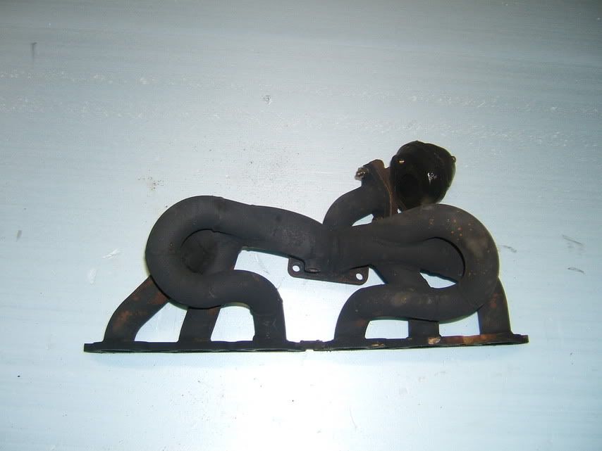

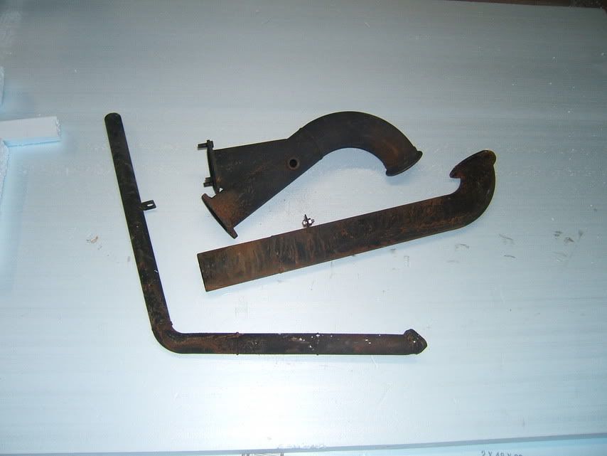

                  I am PRETTY sure that is (or is very similar to) what I had on my 240sx (satin black). It got all rusty after about a month. I was pretty bummed out. (side note, check out that brake booster placement... that was an RHD CONVERSION, lol... I'm a ricer)
                  Before:
                  After (don't hate on my manifold too much, it was my first one ever...):
