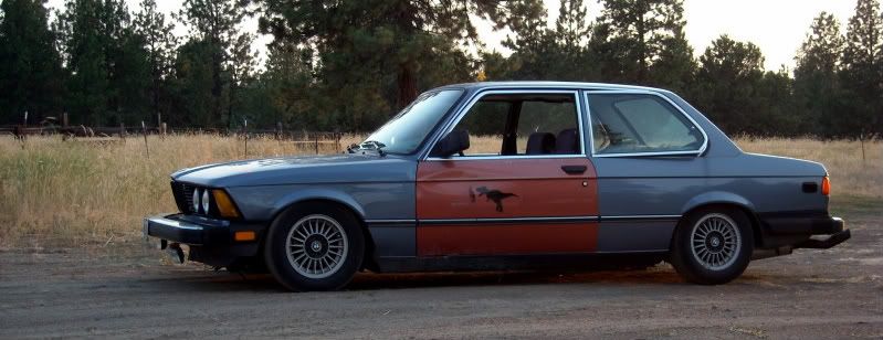

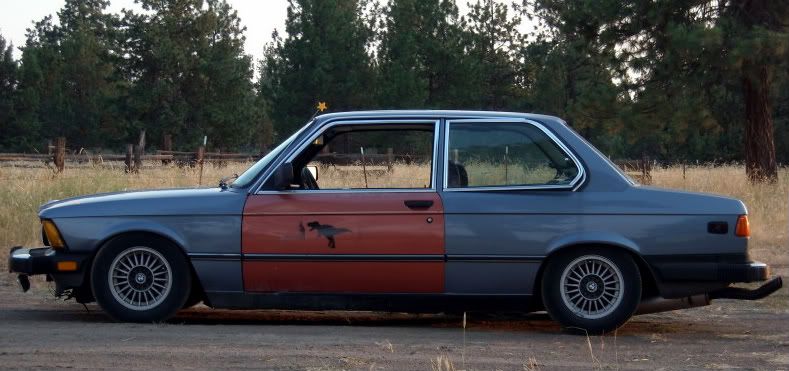

    bummer that his got destroyed, good to know they are safe though. I was a bit curious about that. I was never a huge fan of E21's, but always liked them, came across my first one (the one in my signature) for free. I liked how it was small and "right wheel drive", then I came across the one I have now which is better, and scrapped the first one. Wasn't too partial to E21's until I took the coils out of the one I don't have anymore, then I lowered my current one, I will always love E21's from now on as a result.

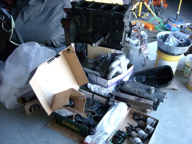

      #32

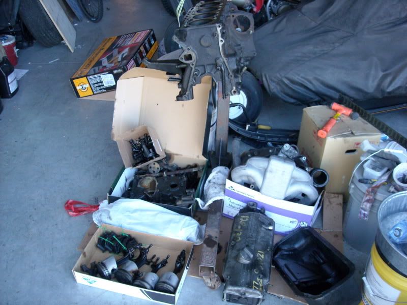

      so after realizing that it's going to cost over $400 to properly re-build my non-seized m10, I decided that wasn't worth it. I am set on buying my friend's 12A rotary and trans and some other necessary odds and ends for $250
      any thoughts? apparently E21's are 100 pounds lighter than 1st gen RX7's and mine will be even lighter with a rotary. sure it won't have a ton of power, but it's looking like the cheapest way to get my car running.

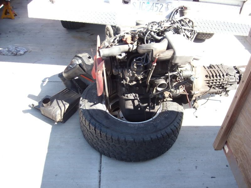

        oh schnaap!
        any one want to buy all my M10 stuff?
        almost ready for a rotary!

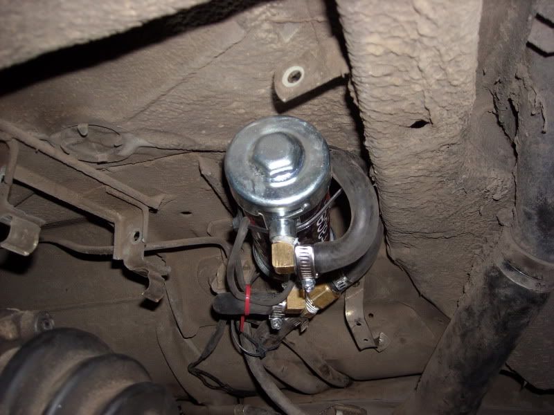

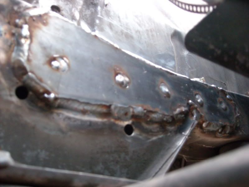

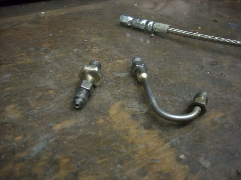

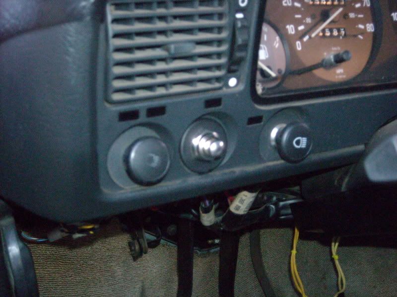

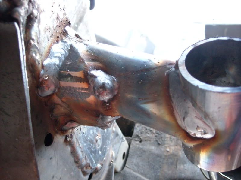

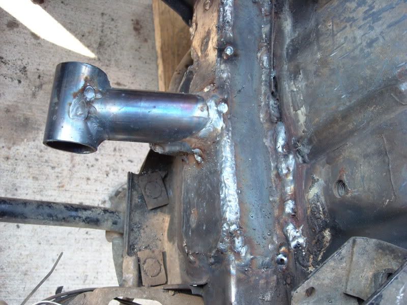

          Big, and vague update:

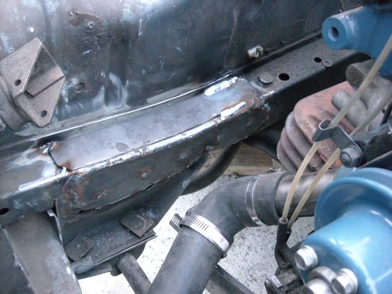

          unibody reinforcement plating and engine mounts:
          RX7 radiator mounted with stock E21 air box mounting hardware off the old parts car and this one:

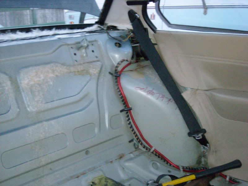

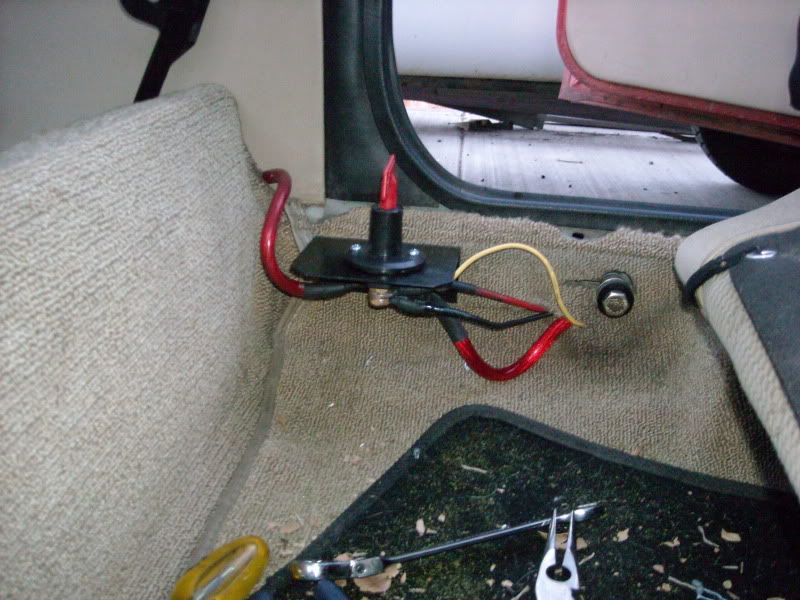

          in line fuel pump, battery switch and battery cable routing, start button in de-frost button location, and clutch line with custom made ends (not in that order exactly)

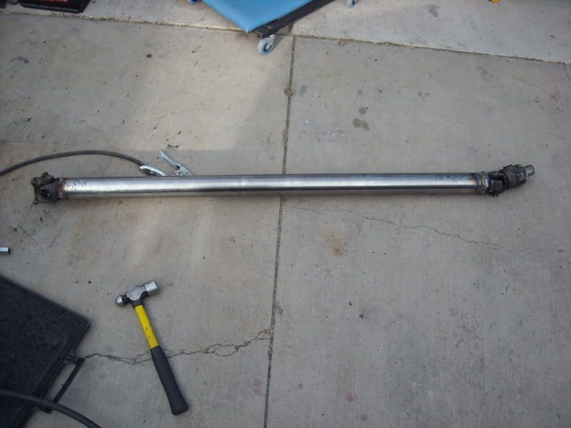

          the drive line I had to make, the drive line shops around here just couldn't do it, so I had to do it technically incorrectly.
