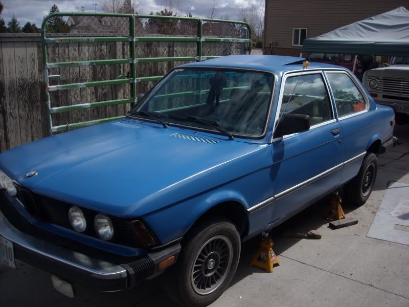

lmost there, just waiting on the steering parts. I could technically run the stock rod ends temporarily despite the fact that they are in poor shape, but I stripped one out trying to get the castle nut back on.... yea, they barely didn't bind at nearly full bump, and only at full lock, other than that, they'd be okay i think. the good news is that i know I don't have to space a heim down very far at all to be much better off than I would be with stock rod ends.
full droop, possibly less fender gap than stock height? :)
basically full bump
I was a bit concerned about this ball joint, but I gave it a good look over at this nearly full bump setup (coilovers are in the same place as before with 2-1/4" off the strut tube and I added 1/2" of bump stop since the bumps weren't doing the trick on their own) and they look like they still have a bit further to go, and it turns beyond lock to lock without binding, the rod ends however, that's another story... although not nearly as bad as I thought they'd be as stated above.
basically full bump
