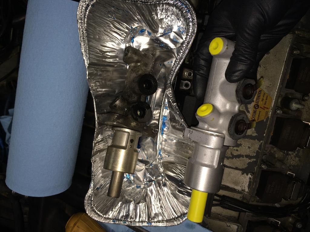

    Mine's already adjusted to be as far down as possible. Some people cut and thread theirs further down; I don't have that capability. That said, the main reason was for the biasing. E32 master cylinder is a symmetric bore whereas the e30 has a stepped 22mm/17mm bore. Therefore the 735 master gives you considerably more front bias, something this car doesn't need. Better bias is better brakin', not to mention trail brakin'.

    Yup. If anything, these cars need more rear bias. More front bias feels like you're stopping harder, more rear bias actually does make it stop better.

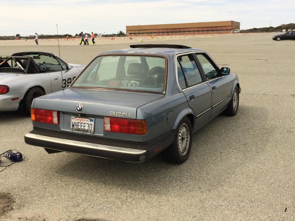

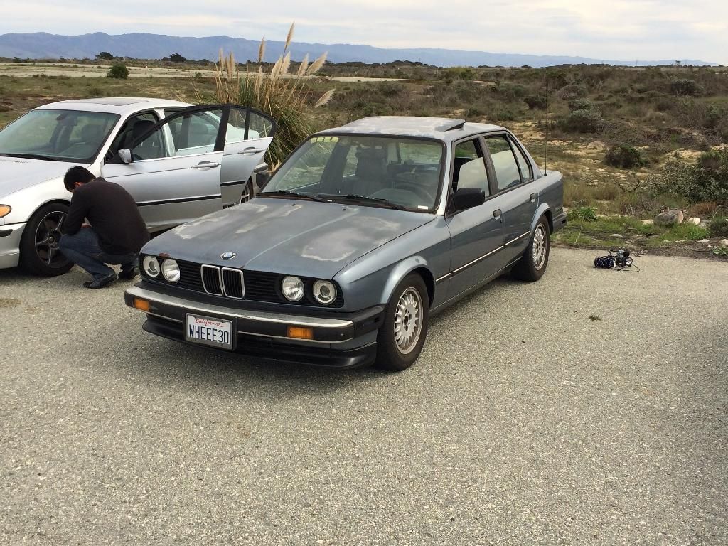

    Okay I haven't updated in fucking forever. So here's a recap of what's been happening lately. Also, sorry for terrible image quality.
    I did an autocross thing
    (car had terrible brakes for this so I barely used them)
    Also I borrowed a set of bcaps and plebeian tires so now it looks stockish
    teehee

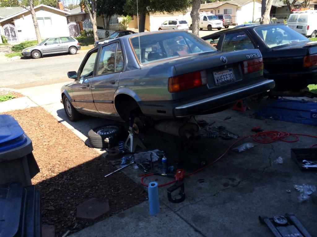

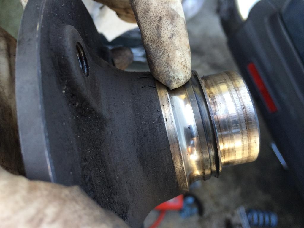

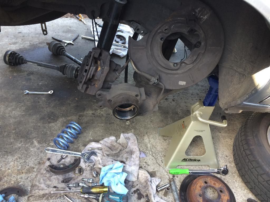

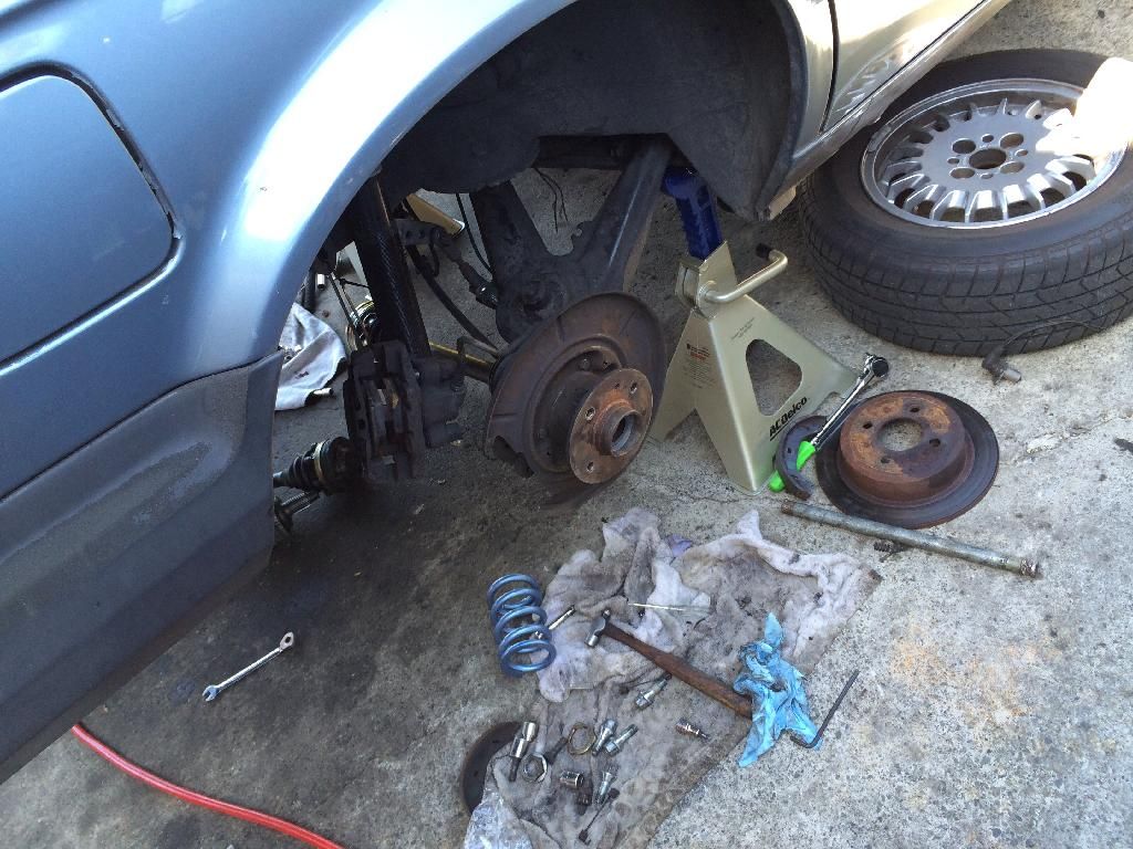

    Doing rear wheel bearings and axles
    Bearing out!
    Fuck this thing
    New bearing in
    Bearings and new axles in

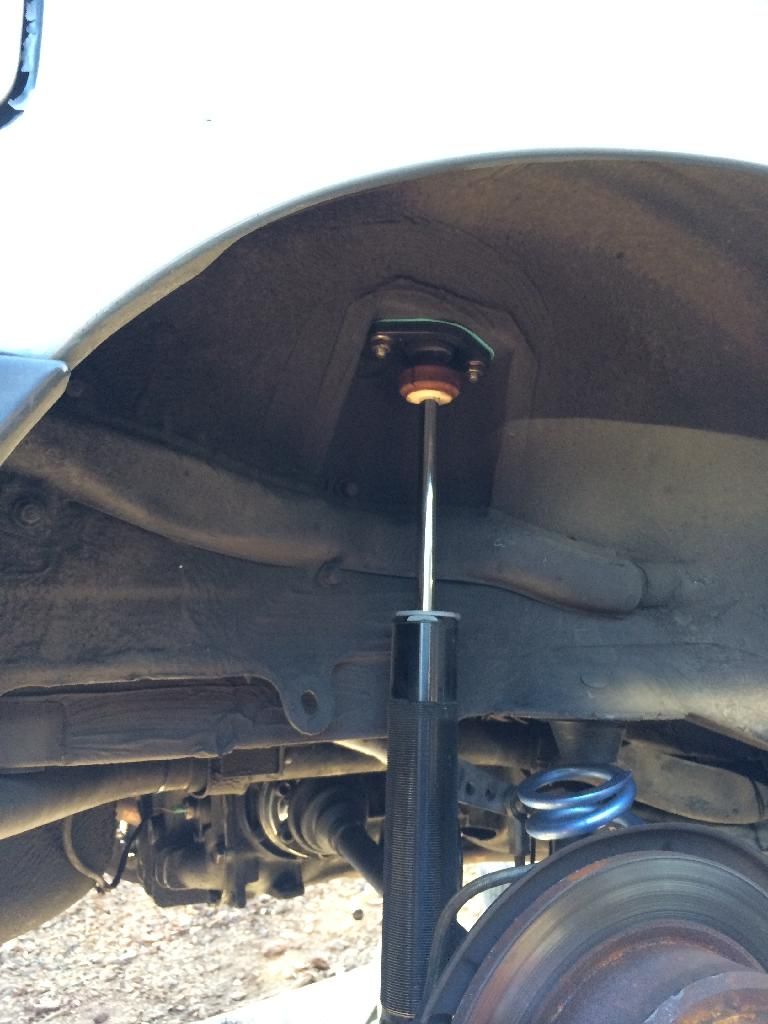

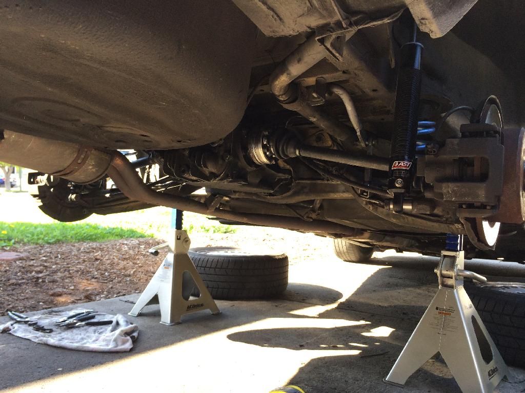

    Cut the AST's bump stops since there wasn't enough compression travel

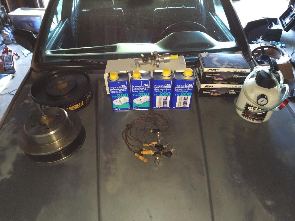

    This thing needs brakes, and bad. These should help (PF11, I didn't get no street pads bitch)
    ABS is also not working, scored some good condition sensors off a guy who did a 5 lug swap.. oh and there is other brake stuff

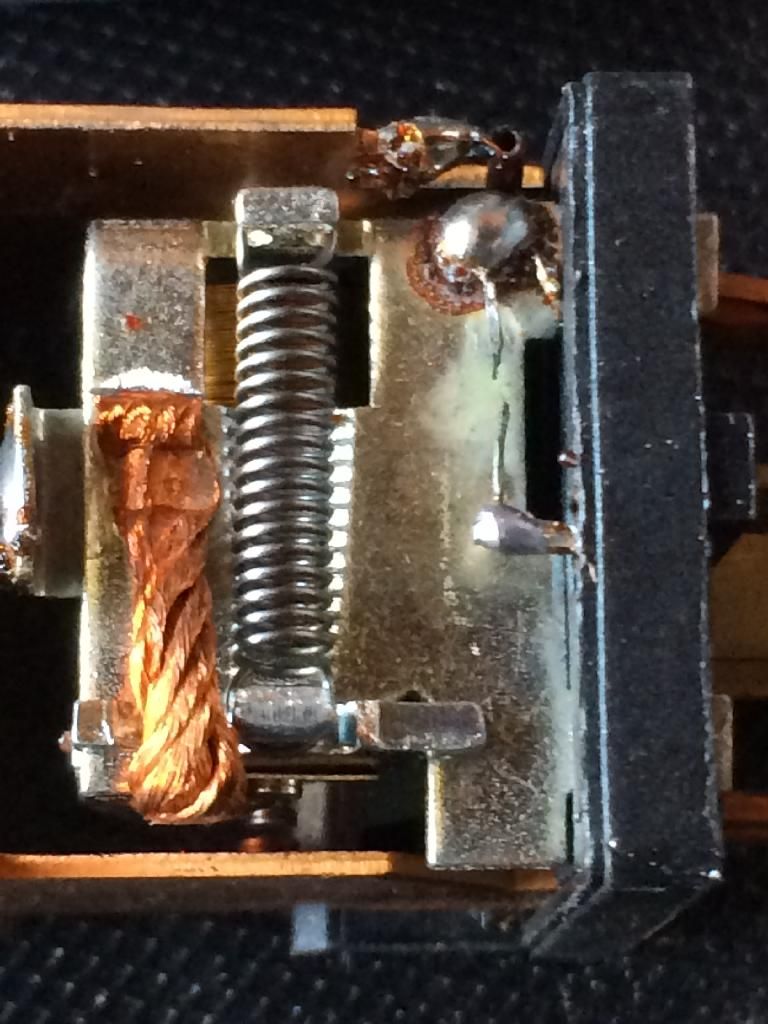

    Here was my ABS relay... fuse link popped. Just soldered in a new one (read: small strand of wire) and that did the trick.

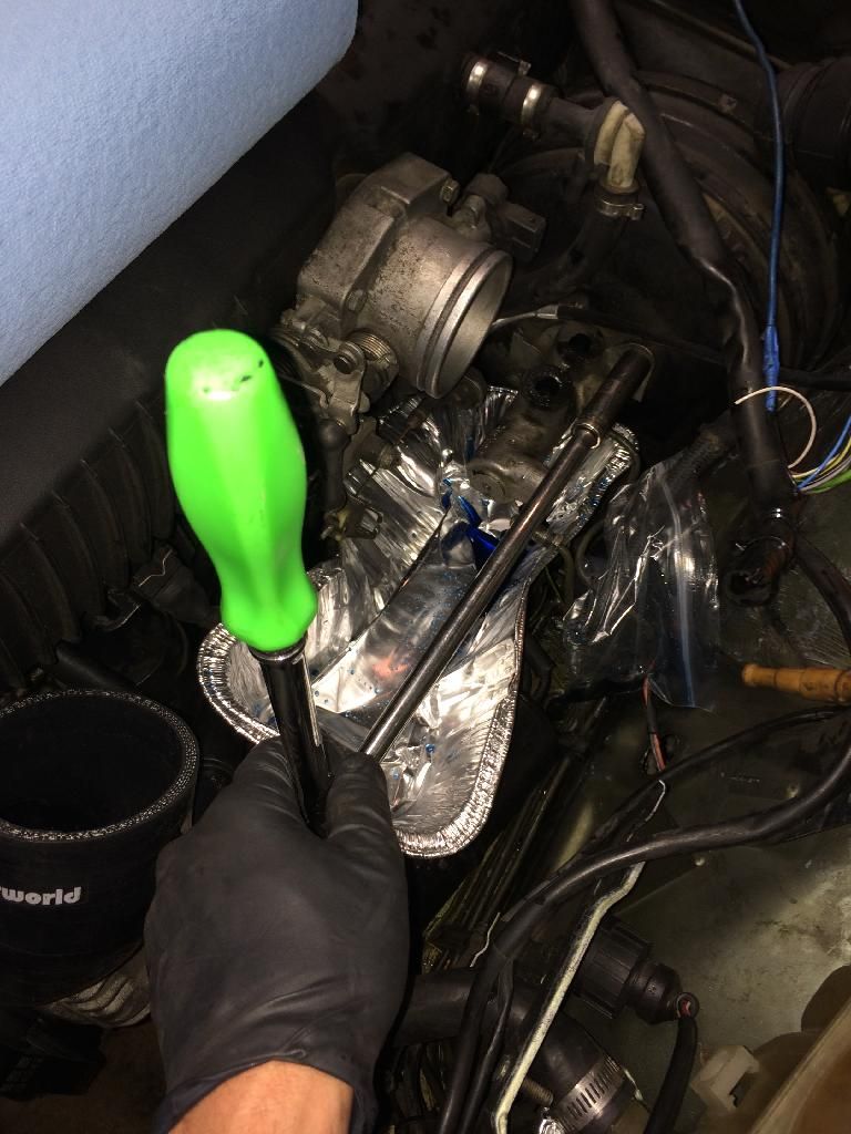

    blahdy blah, changing the master cyl
    old E32 735i master vs. new 325ix master. The E32 master has a bigger bore and more front bias. I'd like the pedal to sit lower for better heel-toe and better brake bias, plus I wanted a new part, so I grabbed an ix master.

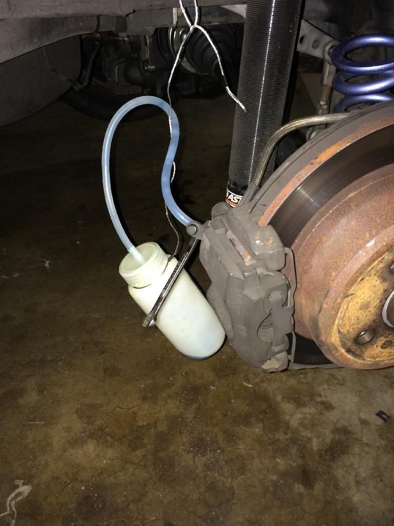

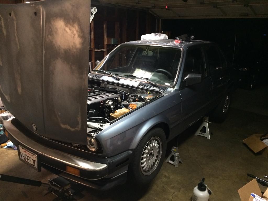

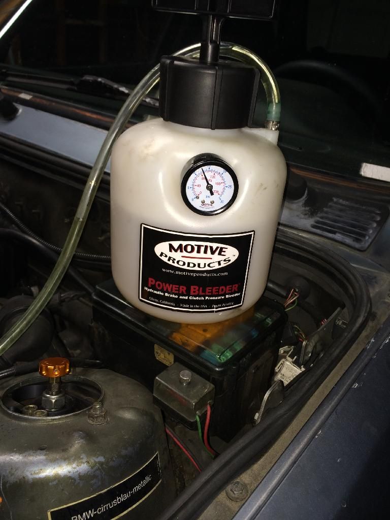

    Car up on stands getting fully bled
    I fucking love pressure bleeders, does the hard work for you
    This little guy is useful too
    So far, a decent success. The ABS works now, probably for the first time in over 10 years. The brakes... well I think there is some air in the ABS unit because I've never been able to get them to feel as they should for years, even after many full system bleeds. So, next up is to bleed the system while cycling the ABS unit. Also, doing front wheel bearings as well as an alignment and 3-clutch diff. Then, the car may actually be fit(well, ish) for the track.
