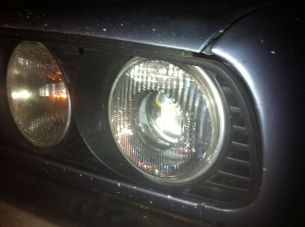

    Sealing up - I decided to stick with aluminum tape for a few reasons. Partially because there is very limited space.
    Here are the results
    paint sucks

        Will the aluminum tape seal those properly, you think?
        Need a part? PM me.
        • Wh33lhop
          • 11705
          #364
          If you are meticulous about it it will seal pretty well (the adhesive on this stuff is pretty gnarly). I am more worried about longevity with the aluminum tape. Unfortunately I didn't see much of an alternative that wasn't very messy.
          In the end I live in california and they won't see weather much worse than the occasional shower.

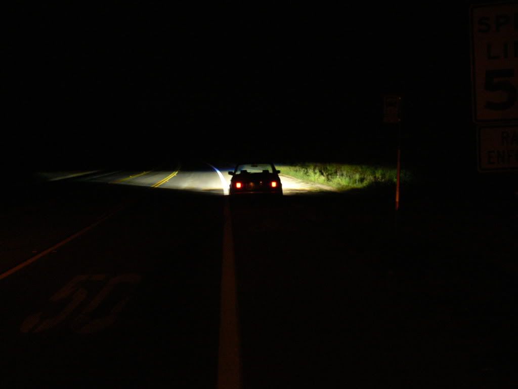

                Dude, the lighting mod looks awesome! Very functional and the cutoff is super sharp!

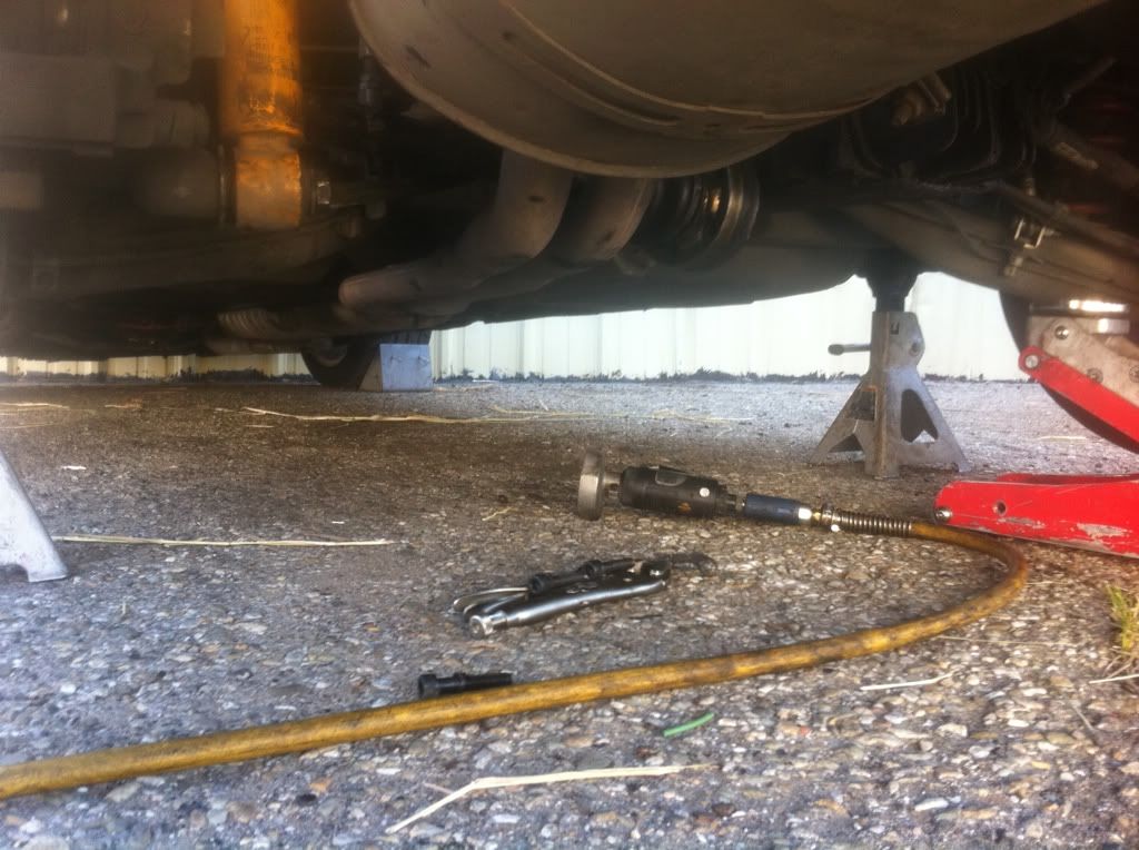

                  Haha, whoops. :D
                  All good now. :p Lesson learned. Flat spots suck though.

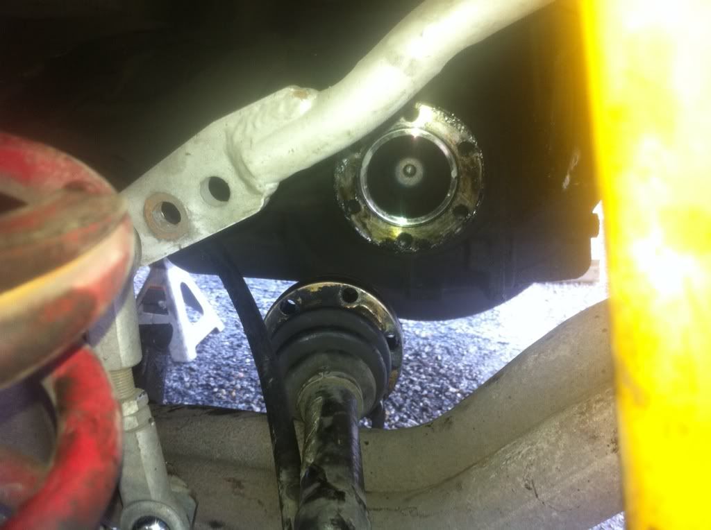

                    n00b question, but what exactly happened there?
                    E46t
                    • nouseforaname
                      • Jul 2009
                      • 322
                      #370
                      he had too much fun.
                      • CorvallisBMW
                        Long Schlong Longhammer
                        • 13039
                        #371
                        I'd like to know too... lost some bolts on the halfshaft flange?
                        • Wh33lhop
                          • 11705
                          #372
                          Half shaft flange bolts backed out--I must have rushed a job and not tightened them properly. Luckily it got tangled in the ebrake cable and locked the wheel before it did any real damage flopping around.
                          I noticed some wobble, I figured it was the CSB again and didn't get a chance to check on it until it popped out. Last time I touched the axles was when I did suspension, a year ago--so it's been awhile.
                          Luckily it only cost me some new bolts and a flat-spotted tire. Cheap lesson that could have been a lot more expensive.

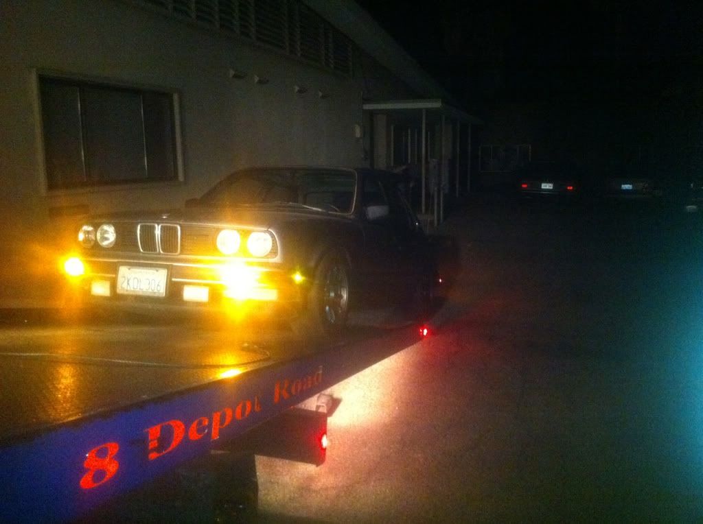

                              A few more shitty shots of the lights. My friend was operating the camera, hard for him to get good focus. Keep in mind a camera's dynamic range is horrible compared to your eyes, and youtube compression lowers it further.
                              Low beams
                              High beams
                              Strobe time! :p
