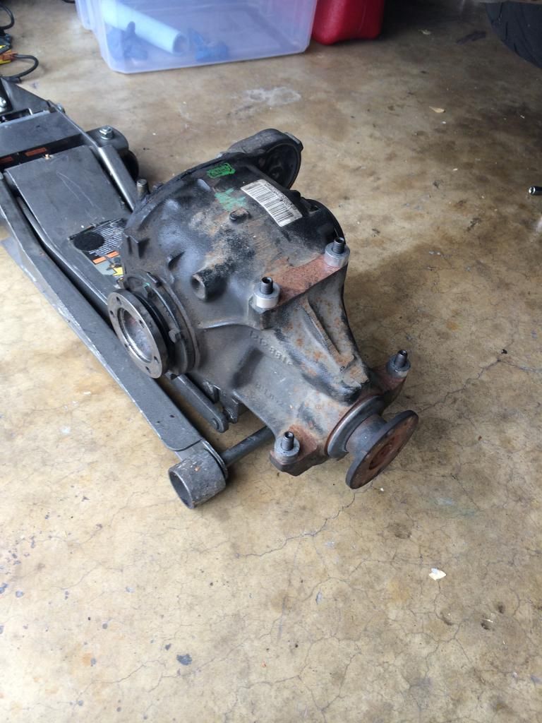

      Nice write-up on the diff rebuild! Thanks for covering the seal replacement steps, since that isn't in the BimmerDiffs steps. I see that people don't typically replace the tapered roller bearings in diff rebuilds - did you check the condition of yours when you had everything apart? I plan to do this project later this summer, and I wanna be sure to order everything before I start... Thanks!
      Nevermind - I see you did address that question! sry
      Originally posted by Wh33lhop
      Side note: I elected not to change out the bearings this time as this is the only diff I've had that's been completely silent and bearings are another ~$80. I believe if it comes down to it they can be done in the car as well, but I do need to pull the diff again before I track it anyway.

          I take it you used one of your original clutches and dog pad. You mentioned that your LSD felt more like 15% lock from being worn. So technically instead of 40% lock would you say your getting about 37%? Haha. I'm definitely going to have to give this a shot once my LSD starts giving out a little (the kit cost as much as used 2.93 LSD diff).
          A few of them co-own it. I used three new clutches, just couldn't fit them in that bin to soak 'em all at once.

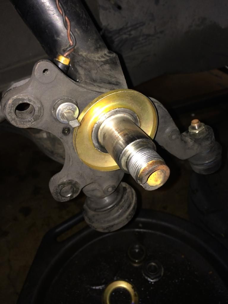

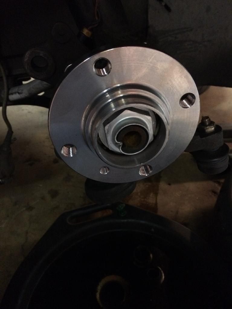

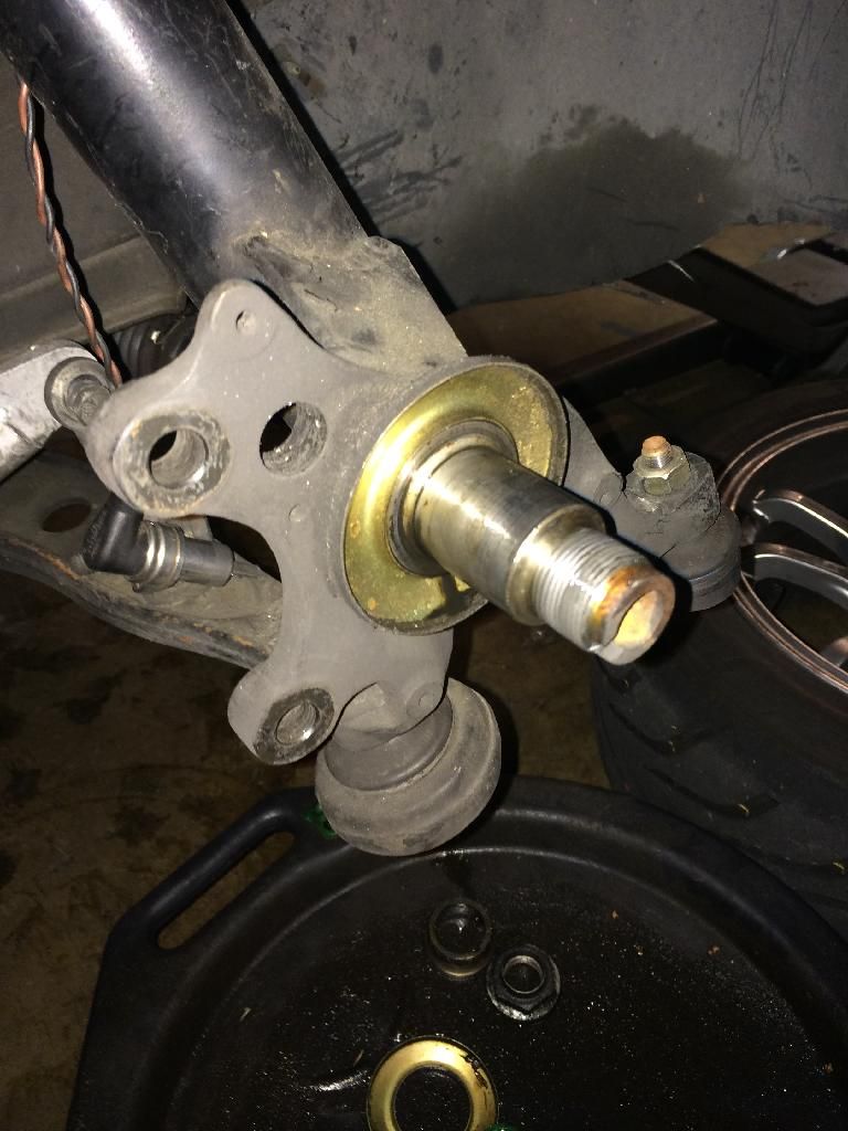

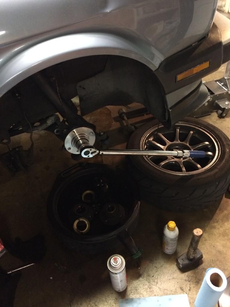

            Front wheel bearings.. easy, I know
            Old hub/bearing

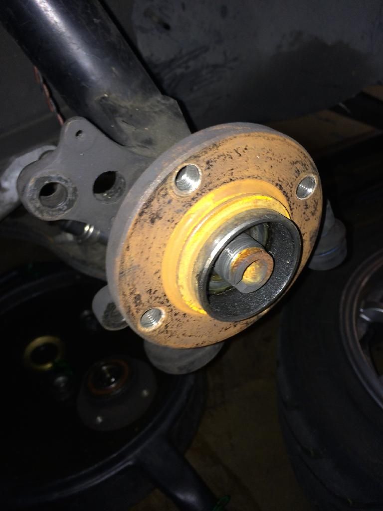

            Pry it off
            New dust seal, zomg so ballin

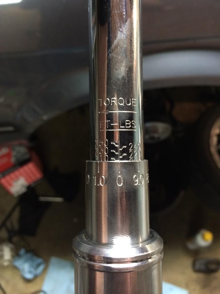

            Torque on the front nuts is 210lbft. Side note, if you have a click type, store your torque wrench at the bottom 10% of its range to better preserve its accuracy. If you store it with the internal spring tensed up it will fatigue it over time. (more info)
            50-250lbft Cobalt torque wrench, accurate and $100. The Pelican writeup that I checked for the torque spec said you need to step on the brakes to tighten the nut. You don't and that is fucking stupid.
            Bend that shit in so it doesn't slip

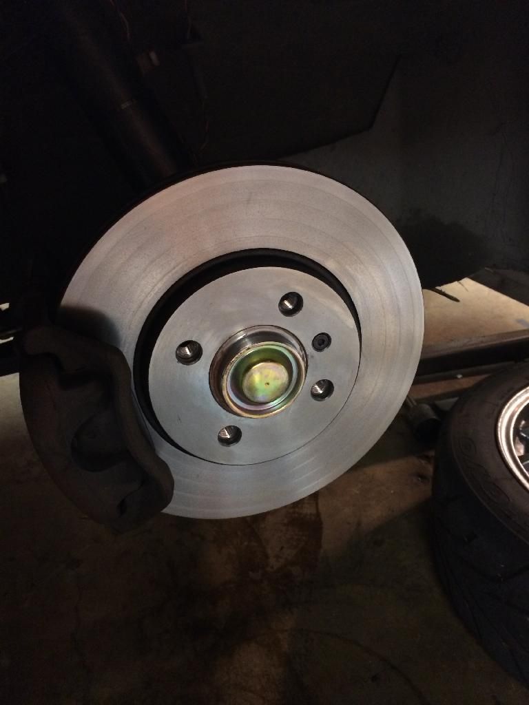

            All buttoned up. Use a little anti-seize on the mating surface of the rotor and the hub, and some on the rotor set screw. Do NOT torque the set screw down at all, just finger tight. It won't back out on you, there's a wheel in the way. And you do NOT want to strip it out trying to remove it because your dumb ass cranked down on it for no reason.
            Bedded the PFCs in with the new rotors afterwards with the pads throwing sparks everywhere. I need to get a video of this.

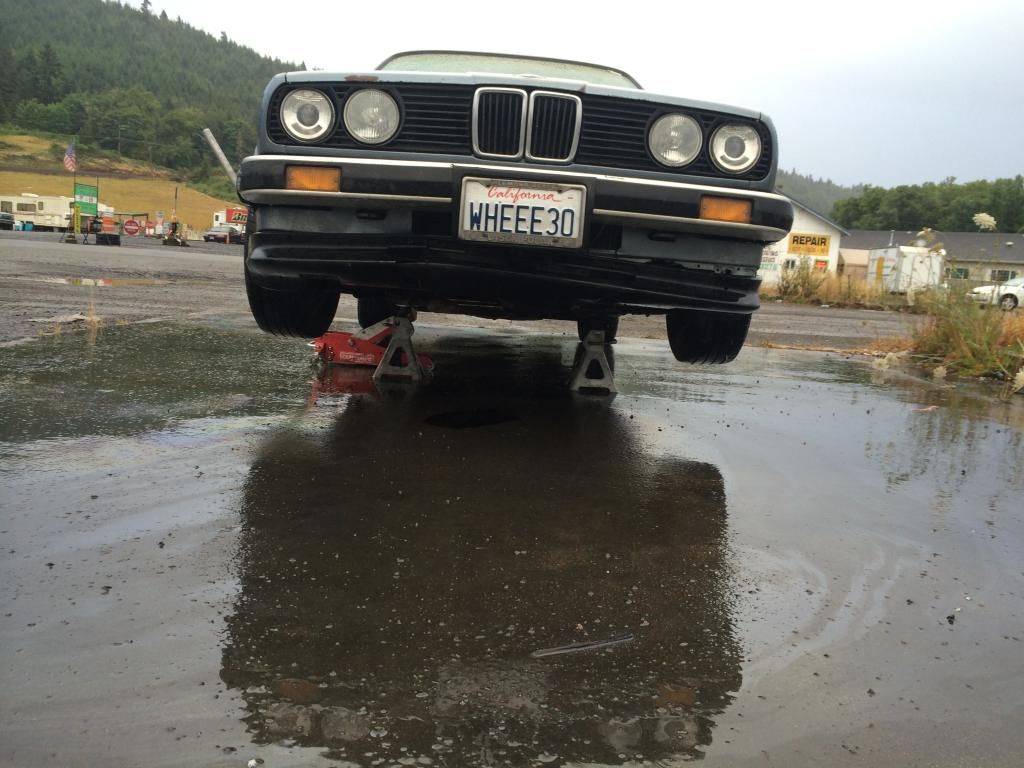

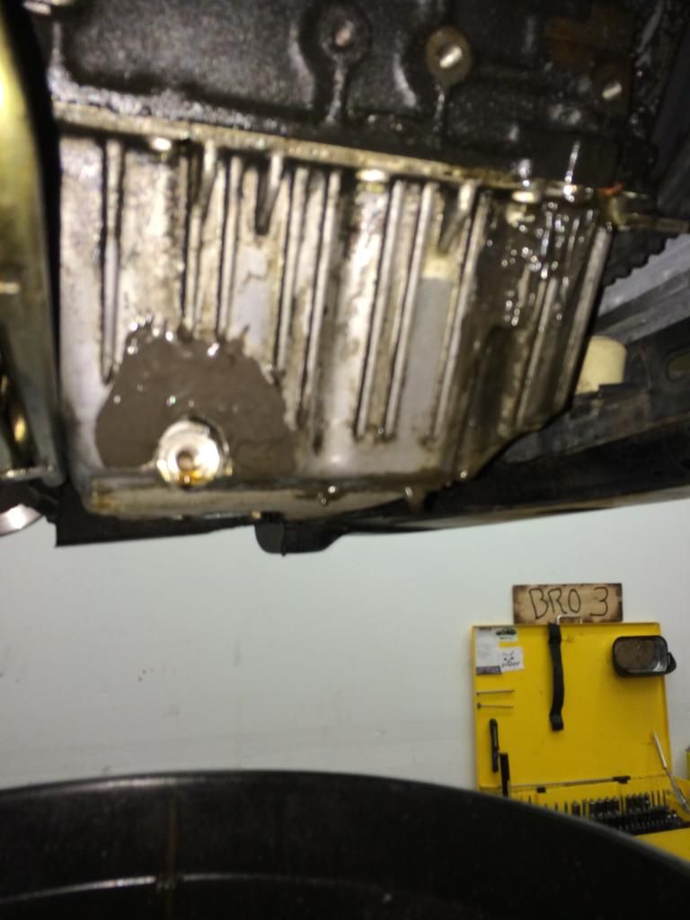

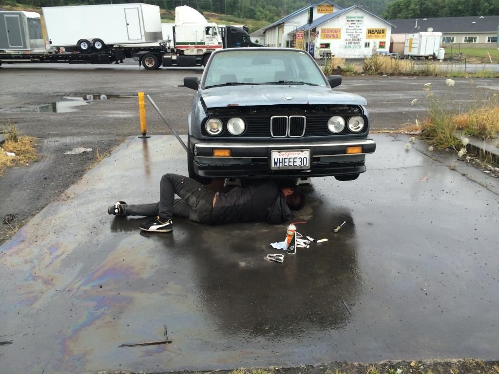

                                Aaaaaaaand trouble. Hit some really low-grip pavement coming off an off ramp from I5, jumped a median and landed on the oil pan. Oops.
                                Luckily we broke down next to a Pilot's, so I bought them out of jbweld and oil. Fredk is apparently a surgeon with jbweld and I've barely used it so I watched him work in the pouring rain and took pictures of him to feel useful
                                Seriously this went on for hours, it was POURING and we were fucking soaked.
                                Then we took some weird trucker showers in Pilot's and changed clothes. The pan was still leaking after 3 tubes of jbweld. Only so much you can do in the pouring rain with jbweld and brake cleaner. So we did the remaining 300 miles while keeping an eye on the oil pressure light and rear view mirror for any cars losing control behind us. Despite leaking a drop every second or two we did not lose much oil.

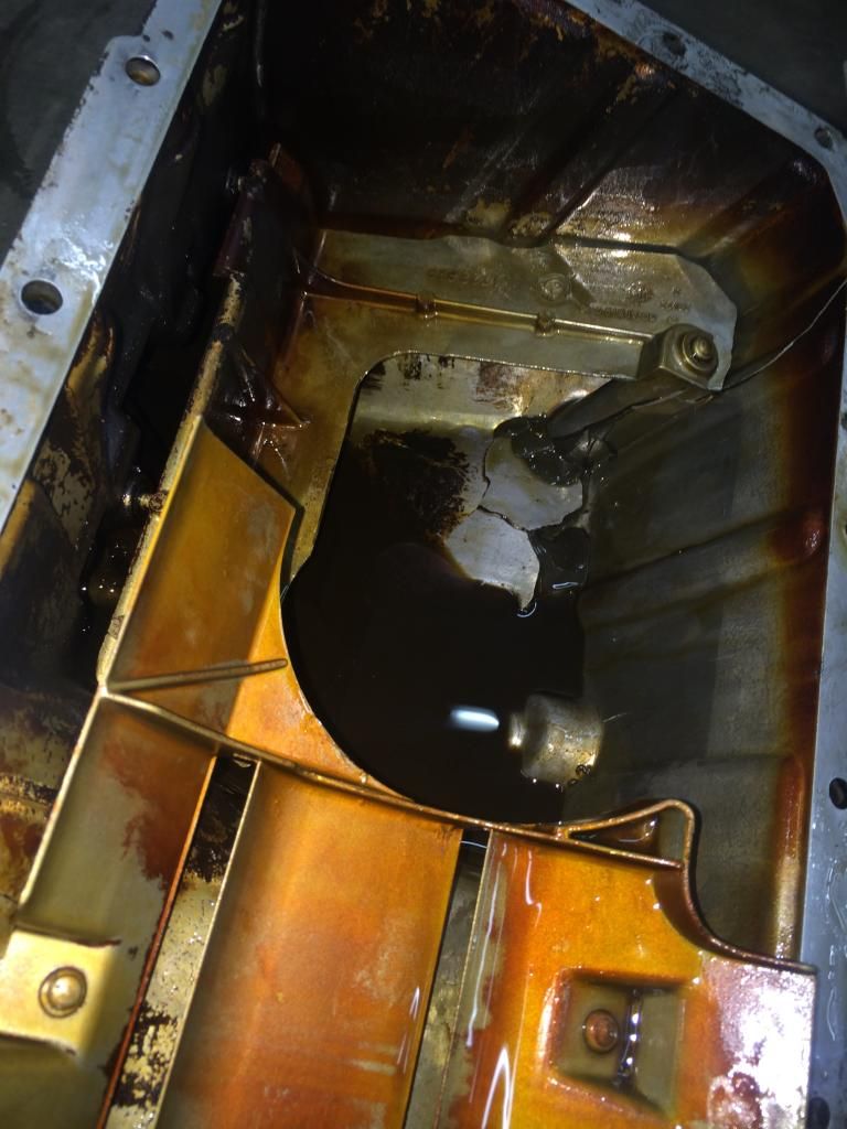

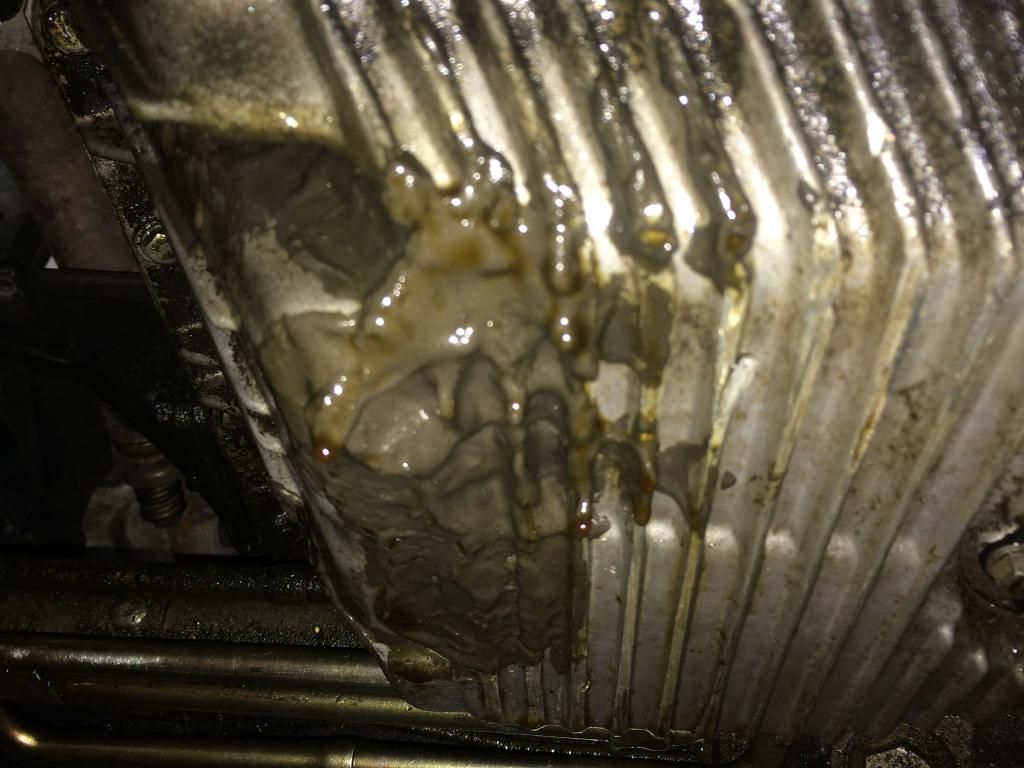

                                Here's the damage. Cracked around the drain bolt and all the way up to the block towards the front.
                                The underside was disgusting, it was so fucked up we had to build the patch in layers.
                                From the inside
                                Luckily we could make some lemonade. John had a MIG lying around so he tacked the oil pump nut. I had loctited it but that only does so much.
                                Aaand finished. The oil pan is probably the cleanest thing on the car now.

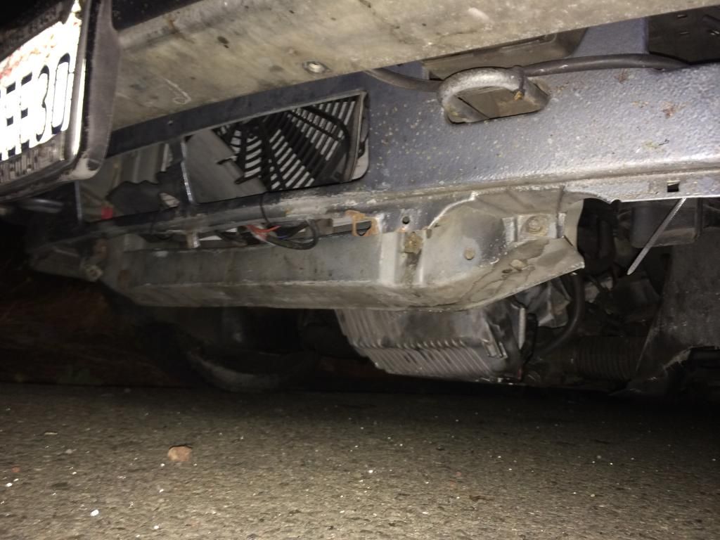

                                Oops. 70 miles from home I hit some piece of plastic bullshit that popped out from under a car. No time to dodge it. Oil pan is luckily fine but the lip which was already damaged was completely shredded.
                                Oh well
                                Overall a complete fucking blast, as usual. I owe Fred and James big time and couldn't have done it without them. Unfortunately now the car is missing a chin and I'm not sure what I want to do about it at the moment. Standard i lip? Euros? Eh who knows.
