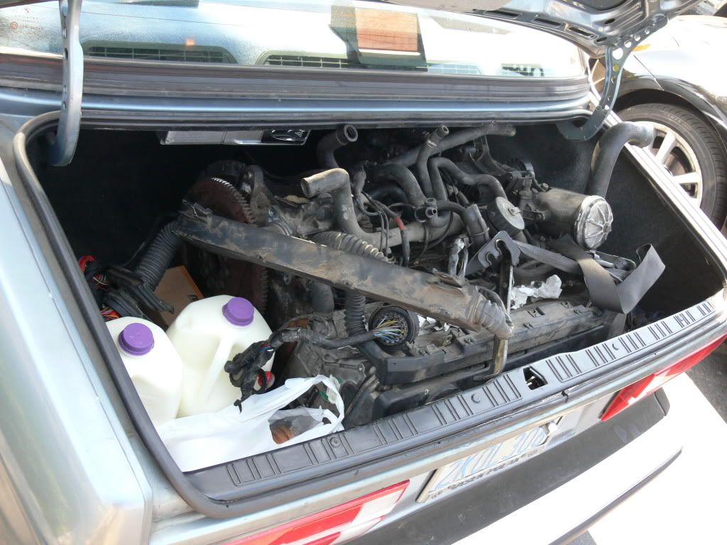

              #36
              I do however have some extra weight in my trunk
              Is it a monster?
              Oh it's just an M50. Hi M50.
              Yes it goes to the grocery store with me :D
              paint sucks

                #37
                hahaha some people would borrow a friends truck, or uhaul it up...but uhhh, good to know an m50 slips right in! i'll keep that in mind! bet that gets all the hot single moms at the grocery store....i would have tried a puppy first though.....just my 2 cents ha
                • Wh33lhop
                  • 11705
                  #38
                  Didn't have a friend with a truck readily available. Had been researching the swap, saw a deal and jumped on it.
                  I'm waiting for a buddy to get ahold of his cherry picker and engine stand, in the meantime the M50 gets a ridealong. :)
                  paint sucks

                            #43
                            Curbside mods at night, hauling a twin-cammer in the trunk.....what won't Wh33lhop do ?!?!
                            Keep up the great work :up:
