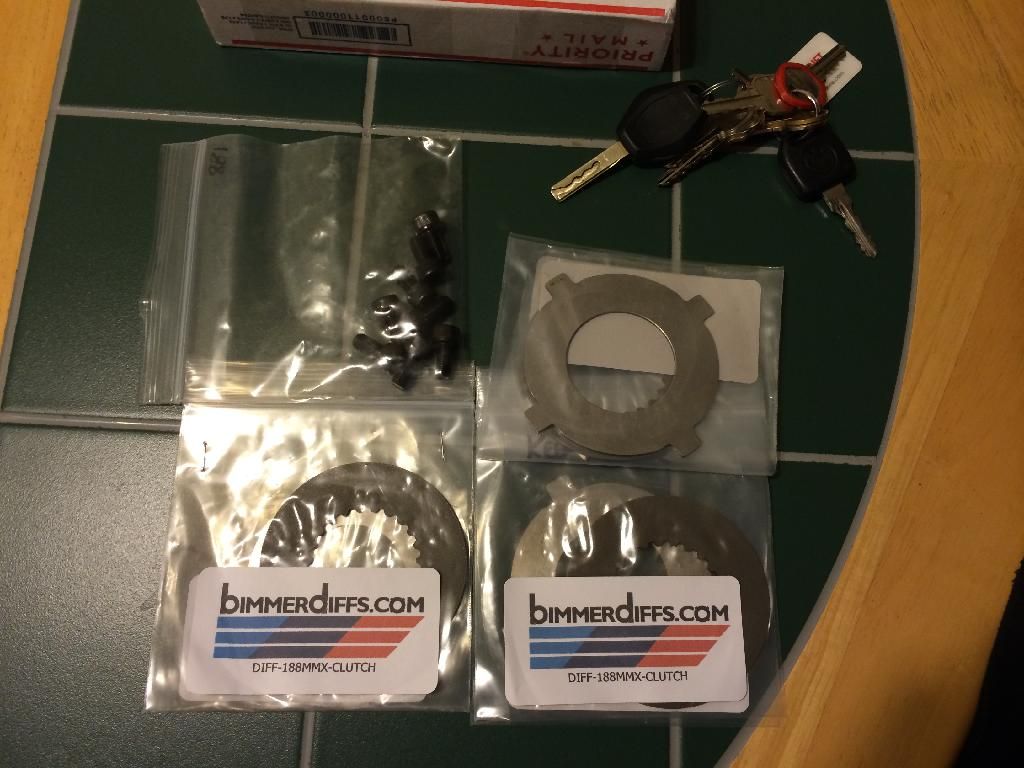

                  Next up, I am excited for this:

                    Ok, you have my attention...
                    Any issues with engagement in your LSD currently?

                      • Wh33lhop
                        • 11705
                        #761
                        Yeah the braking performance of a regular car is pretty surprising, keep in mind the brakes can lock all four tires at most under-highway speeds with enough pressure, you are only limited by the friction circle of all four tires. The PFC11s I just put on can easily lock up all four r-compounds at 120+, it's pretty ridiculous the difference a good pad can make. I haven't taken the HT10s off my 330 since the last track day either, it's too addicting.
                        Yeah, on r comps if you unload a wheel or aggressively exit a second gear corner it will roast the inside for days. It was laughable at the last autox, basically useless. I'm not sure my "hopping" problem on concrete will fix itself with a built diff but it should be done regardless.
