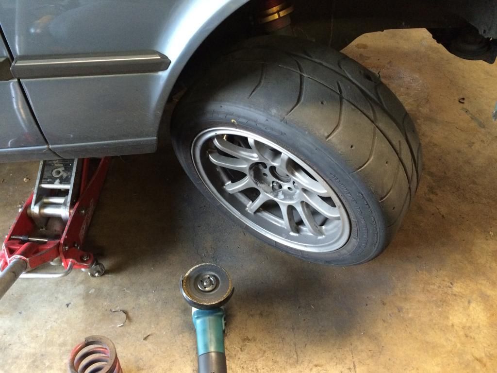

        Something seems to be digging its own water channel into the front tires a bit when I track, so I did a little "clearancing" before the event. Hopefully none of that metal was too important.

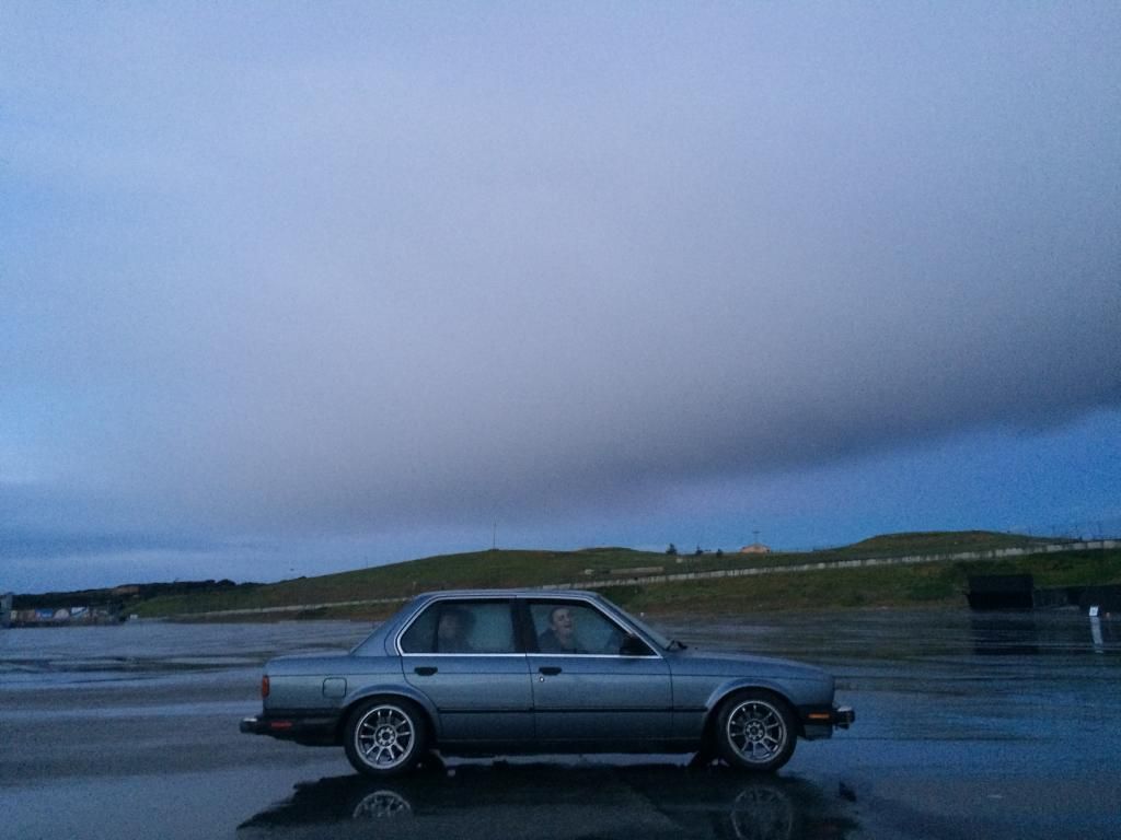

        And as soon as I got there...
        Oh well, rainy slidey track day! Then it dried up after awhile and was super pretty for some actual fast laps. I tore up point-by with a few autox friends in WRXs who had way more power.

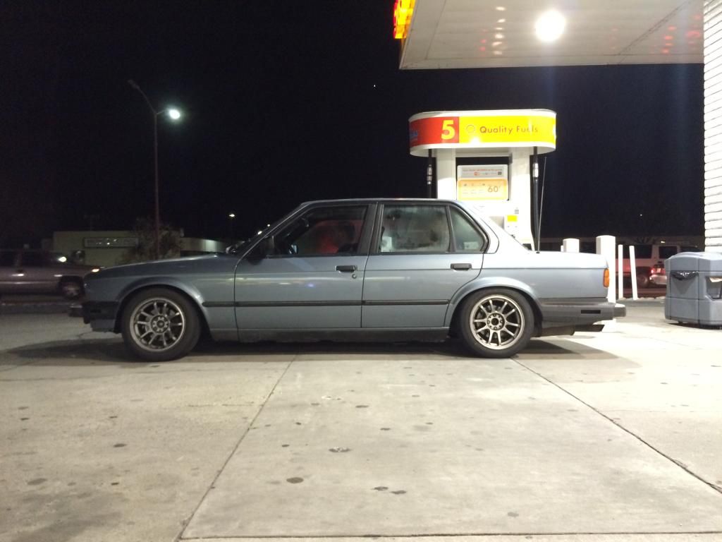

        Unfortunately two of my friends had incidents on this day. So, after wringing its neck in the wet and the dry, whee30 dutifully carried me plus 3 good size passengers all the way back home from the track in what's now known as "the uber ride of despair." I really love this little car and days like these are why I don't want to strip it and put a roll bar in it.
