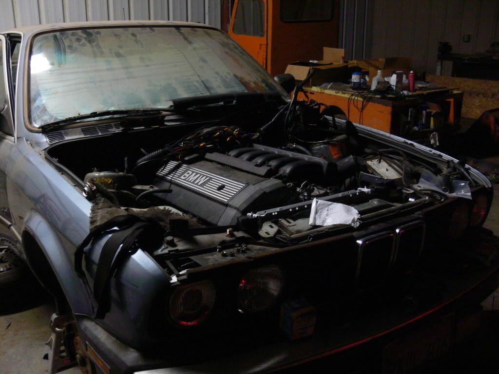

    Bah, this is my first time pulling an engine, I'm doing the entire thing alone and on a budget, a hour from where I live. No amount of planning can truly cover all my bases. :p
    Originally posted by MR 325 View Post
    Why is the exhaust still mounted in the way? lol.
    Also, the brake fluid reservoir isn't going to work.
    Haha, the exhaust hasn't really bothered me so I haven't moved it yet. I'll look into the 2002 reservoir setup. I hadn't really seen the E32 booster/MC documented really and I've been told it's equivalent to the 325ix hardware, so I figured it might work straight up.

                              Not much longer now.
                              paint sucks
                                Slowly getting there...
                                Shit I did
                                Replace thermostat and thermostat housing
                                Install serpentine belt
                                Install tranny brace and tranny mounts
                                (shifter in first gear, barely clears the shift console, had to shorten the selector rod by bending it)
                                second gear
                                Reinstall guibo
                                Reinstall driveshaft
                                Replace/make/install various vacuum hoses, coolant hoses and fuel lines, excuse my shitty utility knife hose cuts:
                                Bend heater core lines to accommodate intake manifold
                                Install intake manifold and connect everything up
                                Find a weird-ass short in the oil level sensor that I'm just going to disconnect for now (hopefully there's no bigger underlying problem)
                                Install radiator and lengthen aux fan switch wire
                                My soldering station:
                                Replace engine coolant temp sensor (middle of pic) with E30 one
                                Lots of shit I'm forgetting about
                                Shit I still need to do, in no particular order
                                Make adapter (doing that tonight)
                                Get various nuts and bolts (throttle body bolts, engine mount nuts, intake manifold nuts, CD's nuts)
                                Install throttle body, intake boot/MAF (or HFM as they call it) and ricer cone filter
                                Reinstall brake pedal, this is actually probably going to be the hardest to do, such a bitch to get the big pivot bolt through at the top
                                Convert to a remote brake fluid reservoir (anyone know where I can get DSM parts? I need some weird fittings) and bleed brakes
                                Start it
                                Take it somewhere to get exhaust fabbed
                                Drive it home and clean the fuck out of the workplace I used
                                Cry deeply when more shit goes wrong
                                Basically right now I'm just trying to keep moving forward and get it running, the coolant hose isn't pretty but it'll hold for now, I tried cutting the stock one down to size but it was necked down and wouldn't fit over the outlets
                                I'll probably use zip ties to hold the radiator in place for now since the mounting points are different, nothing's really that pretty, I'll figure it out later.
