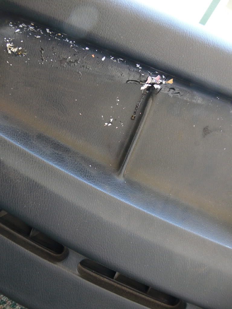

                          The only real imperfection I could see
                          After I cleaned it up... now there are a few places that I scrubbed that seem to be discolored, maybe I need to treat the vynil or something.

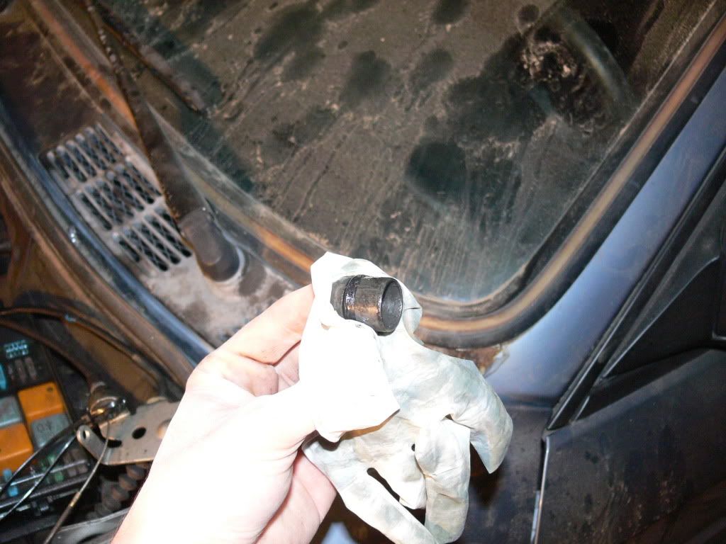

                            Alright, did a lot this weekend. Here she was again, waiting for me.
                            I got started repairing the threads for the control arm bushing bolts, here's the tap after going through one of the holes. Shavings-a-plenty.
                            After re-tapping both holes I got the bushing on in 10 or 15 minutes:
