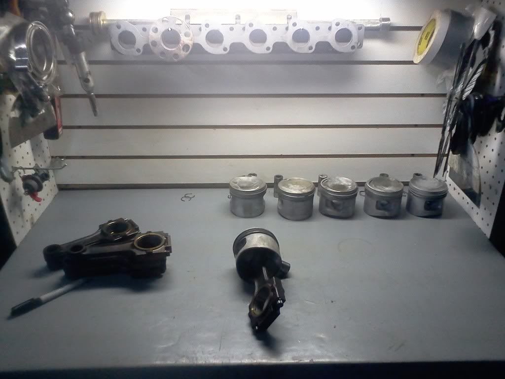

I picked up a seta m20 and used the head for the casting on a jobber. Also have a nice low mileage head that will get rebuilt and shaved, but since the head is going to the machine shop, figured the block might as well too. So, took apart 2 m20's to get the eta rods/crank and i pistons.
This will happen over time, haven't ordered the rings, bearings, cam etc until all the cleaning/machining is done. We also have Pinky's parts pile getting bigger and that's priority over the Delphin car, as the Delphin car runs great as it sits. Just have a bad feeling about the block surface since it's developed yet another oil leak between the head and block. The new block will have a fresh deck surface to eliminate this (not just the head this round). Since Pinky is getting boost, the Delphin car will stay N/A m20-powered.
Anyways, obligatory pics. Nothing pretty yet, spending time on personal cars at the shop is limited. Customers generally don't like seeing you work on your own stuff lol. seta block was completely torn down and the b25 had the pistons pulled. Hopefully the seta block will pass for tolerances and the b25 block doesn't have to come apart to replace it.

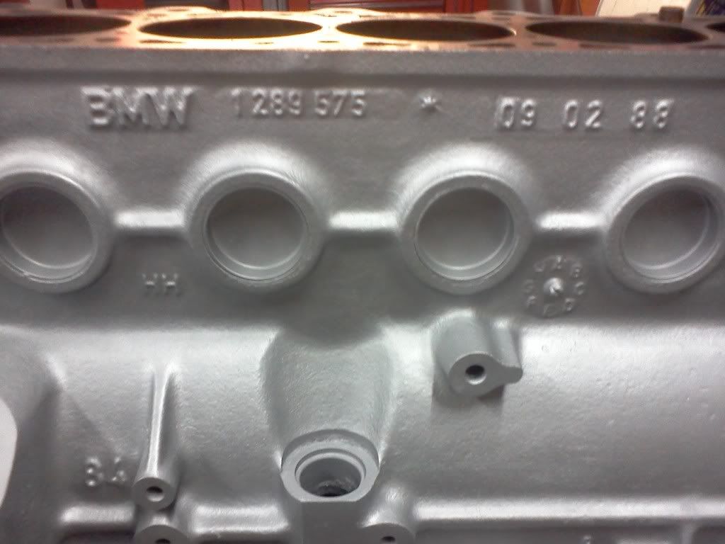

Got the pistons cleaned up in an ultrasonic tank, block is all cleaned up and a coat of paint applied. Ready to go to the machine shop tomorrow :)
