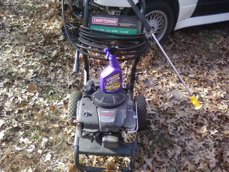

    so i pulled the pressure washer out again and got as much off as I could

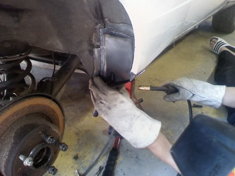

        Josh cleaned up the area to start welding the panels he fabed up in...they line up perfect and are awesome (he has pics of the fitment that ill get him to send me... He started to weld and couldnt draw enough power due to my moms ceramic kiln which was drawing all the power in my barn so the welding will have to wait for another day
        Well we got some free time today and the kiln was off so we had the power needed to weld the new panels in.
        The inner wheel well part getting tac'ed in
        Josh Grinding down his welds
        Finished product
        More fun
