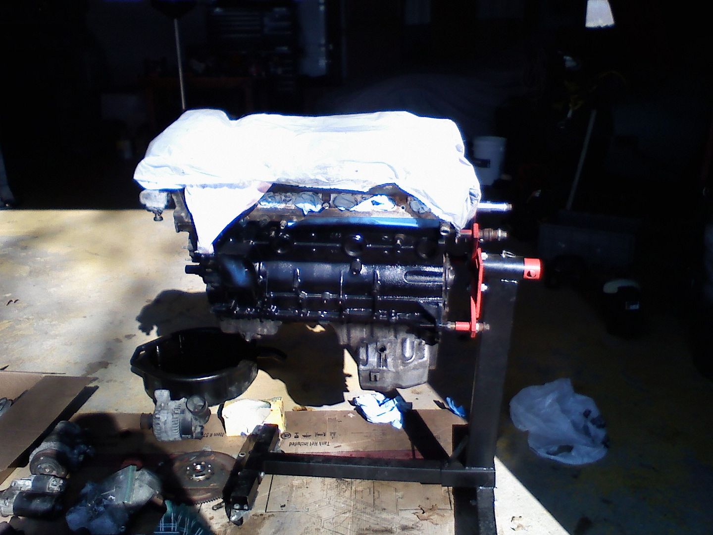

                        #161
                        Mid-Day Update
                        Got up early today and started scrubing my life away. Started with the engine block.
                        All scrubed off:
                        Painted:
                        I know I painted over the freeze plugs....going to wire brush the paint out later
                        Then did the oil filter housing and the motor mount arms
                        Hopefully going to go out later on and take the s50 oil pan off...plastiguage rod and main bearings, then if all is well put the m50 pick up and pan on
