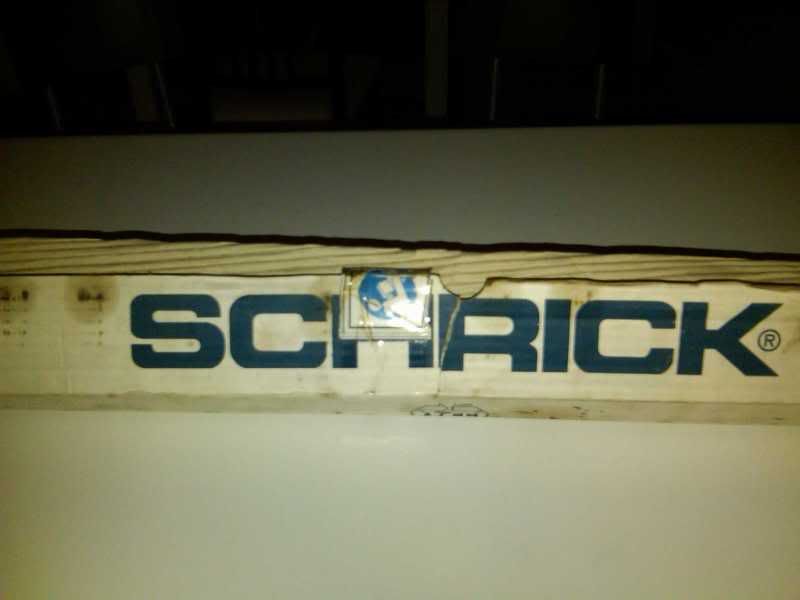

    Bought this schrick 288 a while ago:
