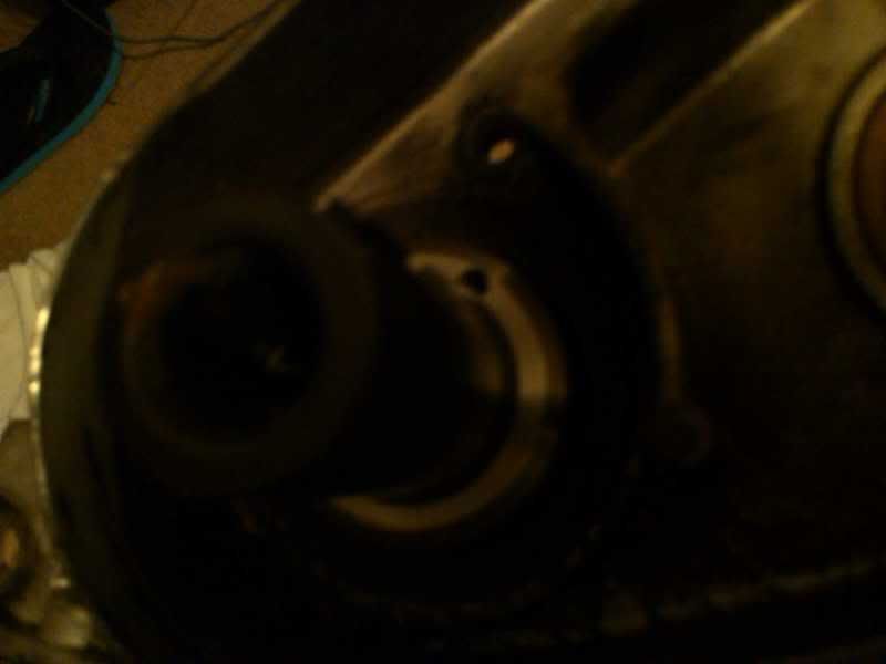

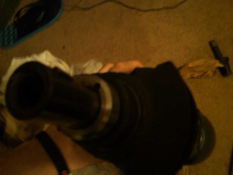

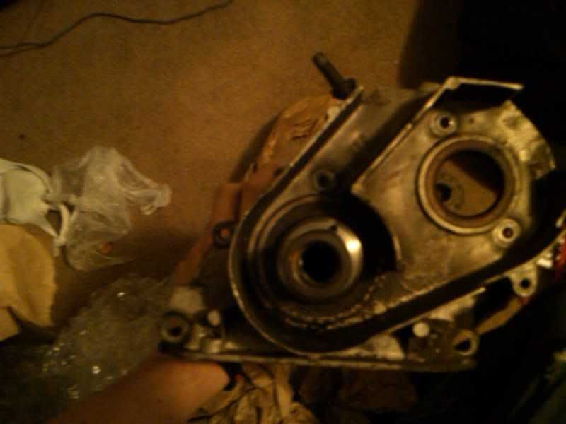

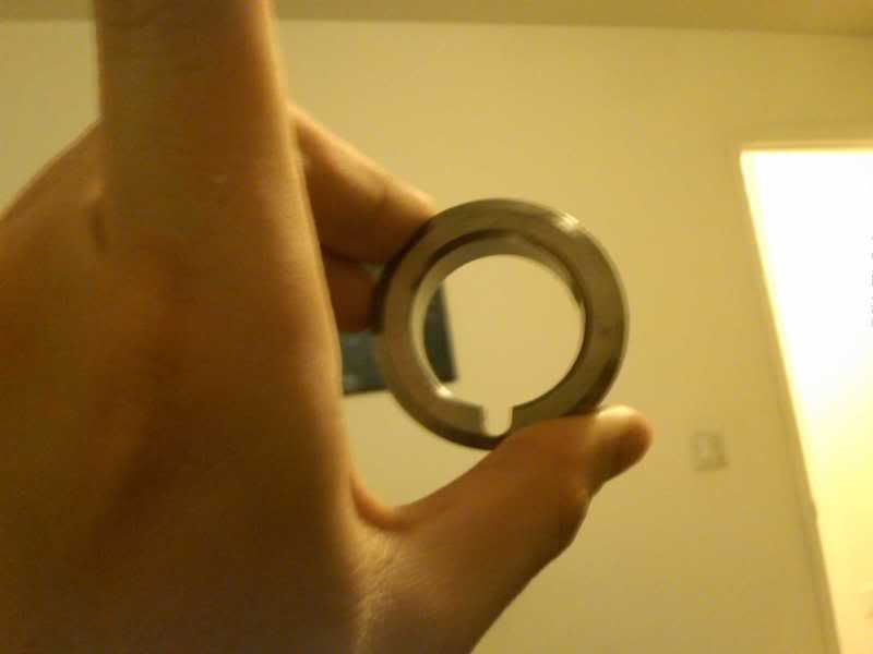

                                Crank spacer arrived today.
                                On the crank:
                                How it fits over the crank and between the oil seal.
                                And the spacer itself.
