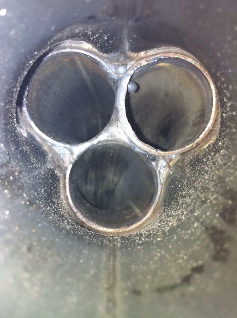

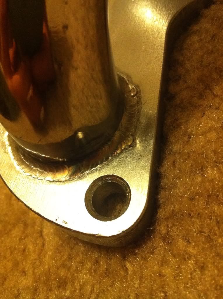

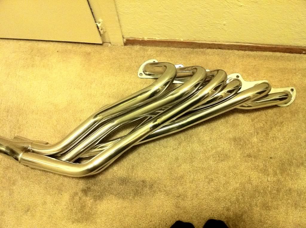

    The TopSpeed Long Tube headers
    Pretty decent welds.
    Didn't clean inside tho, so gonna get a drill with a sander or something and clean up inside.

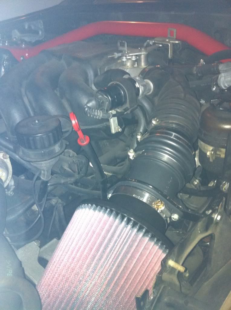

    Here's one pic of the Miller MAF Setup/K&N Cone Filter.
    I will make a heat shield sooner or later and will get better daytime pics tomorrow

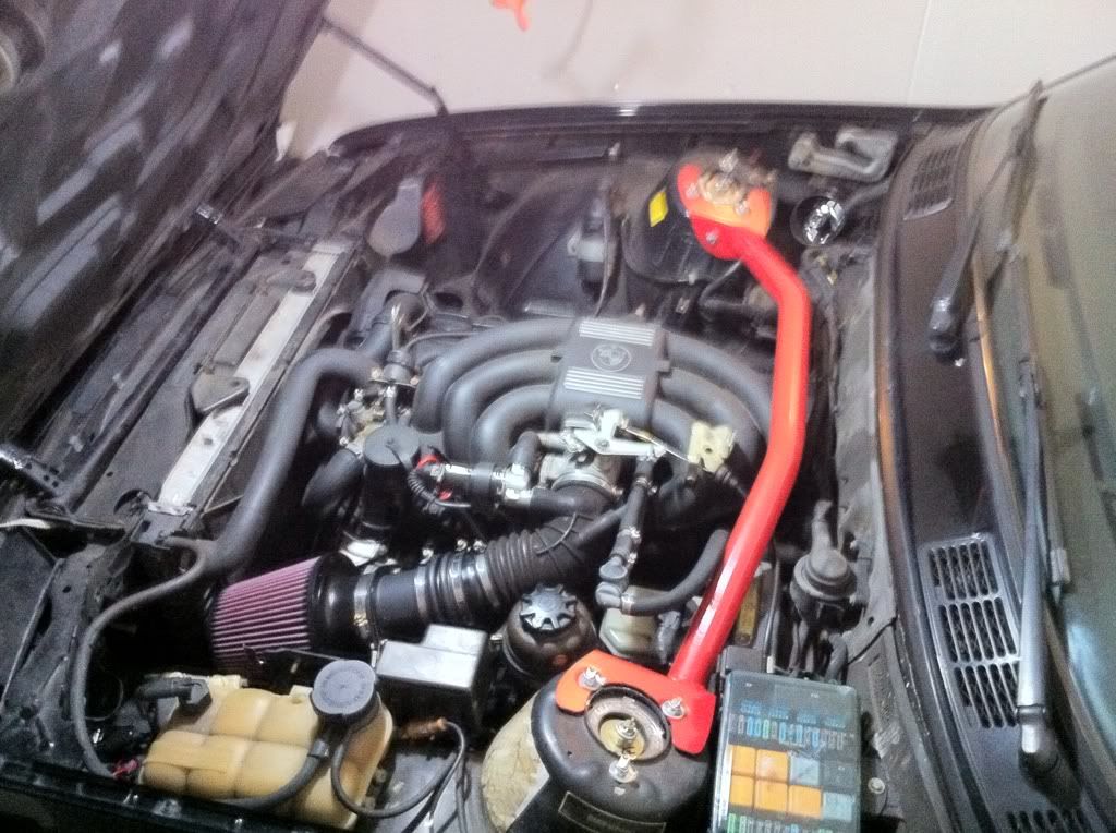

      Cleaned the ICV, Flipped the maf over, still having the same idling problem when engine is cold, once warmed up runs great. Still have the CEL for code 1215, going to test to make sure I'm getting correct voltages. Guess the next thing to do would be check the TPS, also, when a paycheck comes, going to order a new thermostat and temperature sensor because my car never goes out of the blue and I think my Tstat is stuck open, which would make my ECU to always run rich correct because I'm not up to proper temps right???
      Heres a pic of my engine bay with the 3" Miller MAF/K&N Cone Filter.

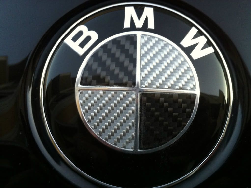

      And a Carbon Fiber hood emblem I found at a local motorsports store. Looks pretty damn real, although its not. Only 20$, beats the old crappy ebay ones.

              Originally posted by 88SuperETABD View Post
              hate to be that guy, but this will yellow in about 6 months... i went through two last year, which sucks cause while they are nice they look badass
              BroWorks.com Bro is a lifestyle
                Yeah. I've gotten the eBay ones prior to this, this one looks to be much better quality, shame is that the shop only had the front roundel, so i have an yellowish one from ebay as well. I agree, they do look bad ass at first, then look worse and worse.
