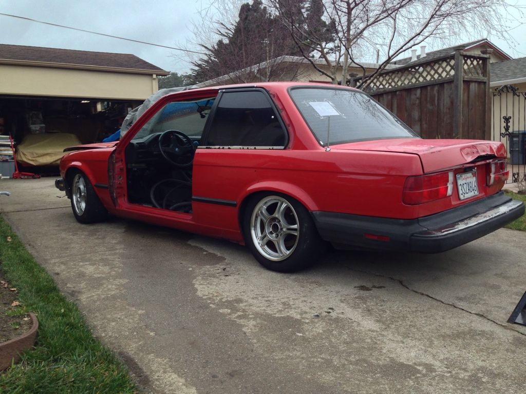

          I bought a parts car, well it was my buddy's who had crashed it and didn't wanna deal with it so he gave it to me for too good of a price to not take advantage.
          Here's how it sits now...
          This will be a donor for my m20b29 I am going to build.

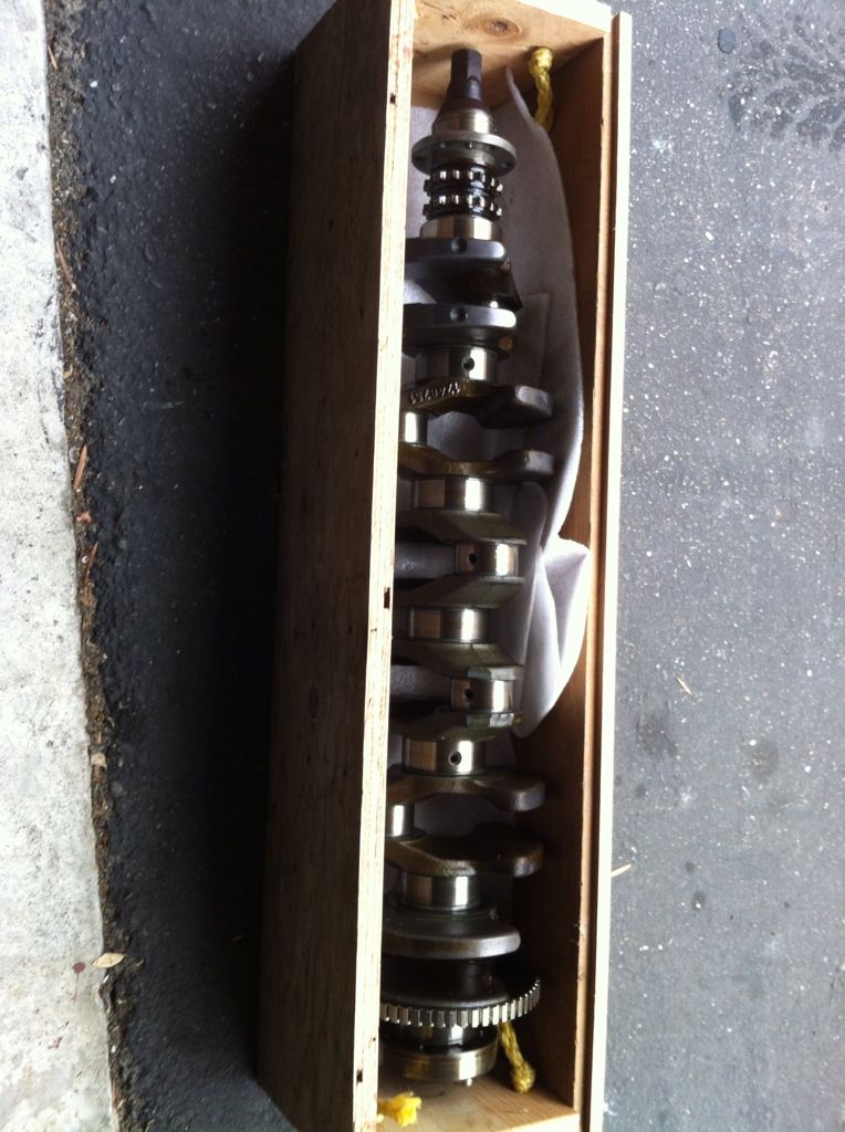

          Plans thus far are:
          m52 crank
          Eagle 135mm Hbeam Rods
          Overbore block +1mm
          85 mm custom 8.5:1 forged pistons (for boost)
          race coated bearings
          arp everwhere
          thinking about a 885 Port n Polished head from Mystery if its within the budget.
          HD Rockers
          Continue to use my MAF/WAR Chip until I decide if I wanna go MS, most likely will.
          I'm sure I am forgetting stuff but I know exactly what Im getting and hopefully it turns out well. have a couple things to figure out still like cam/piston specs.
          Will be replacing almost everything that hasn't been replaced already.
          I've ordered a new ICV, Lemforder Rear Subframe Bushings, RTABs, Front subframe reinforcements, front & rear sway bar reinforcements, a m52 crank, fixed my air leak I think.

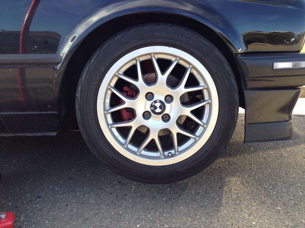

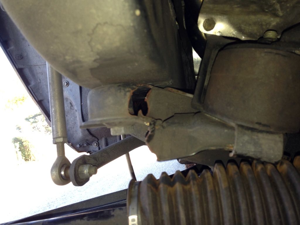

          My front hub started humming so I stopped driving it because I have been using my s10 to get around until the new bearing came in. As I changed the new wheel hub,
          I noticed something Bad!
          Damn subframe!!
          So Now my cars really down until I pull the subframes from the parts car. Front will be reinforced, and the rear will receive camber and toe adjusters from e30tech.
          When thats all finished my suspension will be like 100% new.
          Debating on doing an e46 rack swap also for more gokart like steering. because its so cheap.

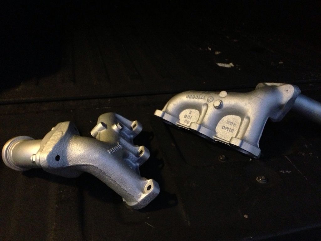

          cleaned this up in case i choose to use an adapter instead of a manifold

              Jesus that's a spectacular subframe failure.
