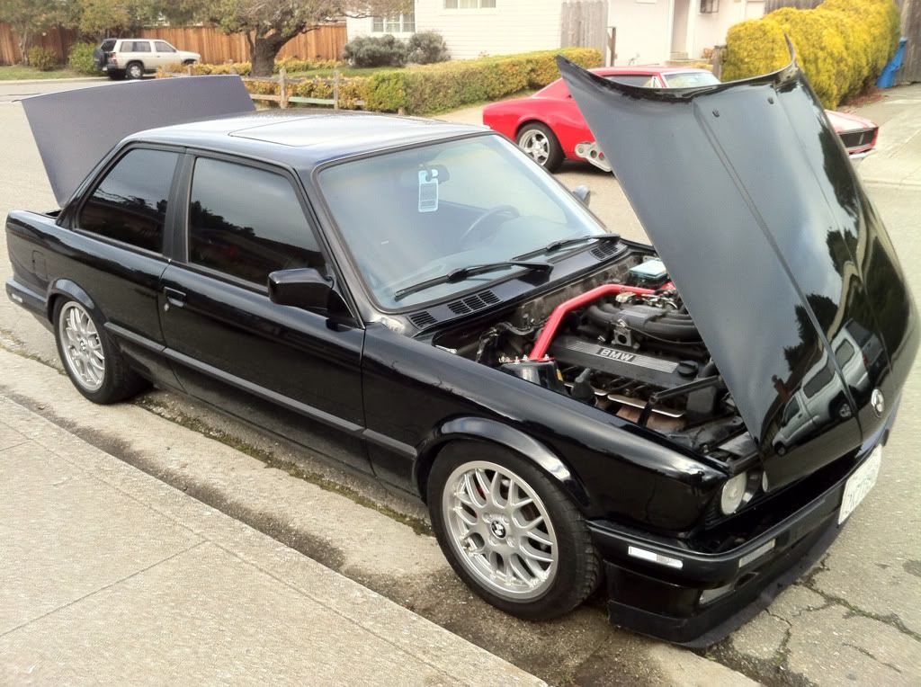

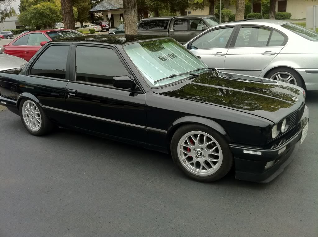

    Heres a couple pics i snapped in front of my work after a wash. (was waiting for my coworkers to come back from lunch)

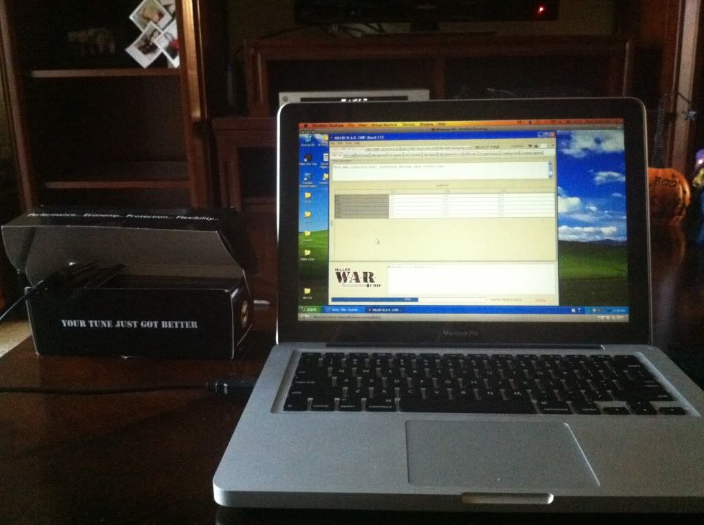

    Also, installed the WAR CHIP software and played around with it. Can't start my tuning tho until I install my wideband.

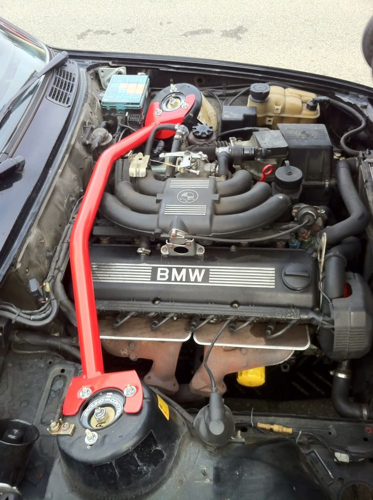

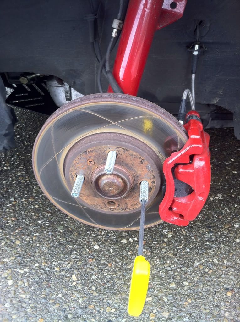

            Installed my Sparco Strut Brace, and my front wheel studs. And changed out my vacuum hoses which fixed my vacuum leak. Also found that my throttle cable was not adjusted properly. (was way too loose, and actually prevented me from ever reaching WOT) And now That those things are done, OMG My car feels completely different, the pedal response and acceleration is so much better, I actually get wheel spin when shifting into 2nd, not just a chirp.
            Tomorrow I will be installing my rear wheel studs, getting an alignment, and depending on how I feel, maybe install my Wideband so I can then install the MAF/WAR Chip.
            Onto the pics.

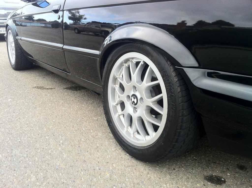

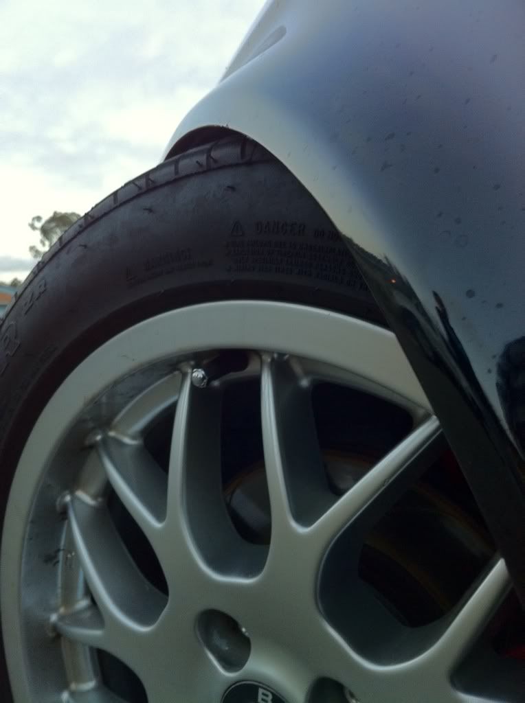

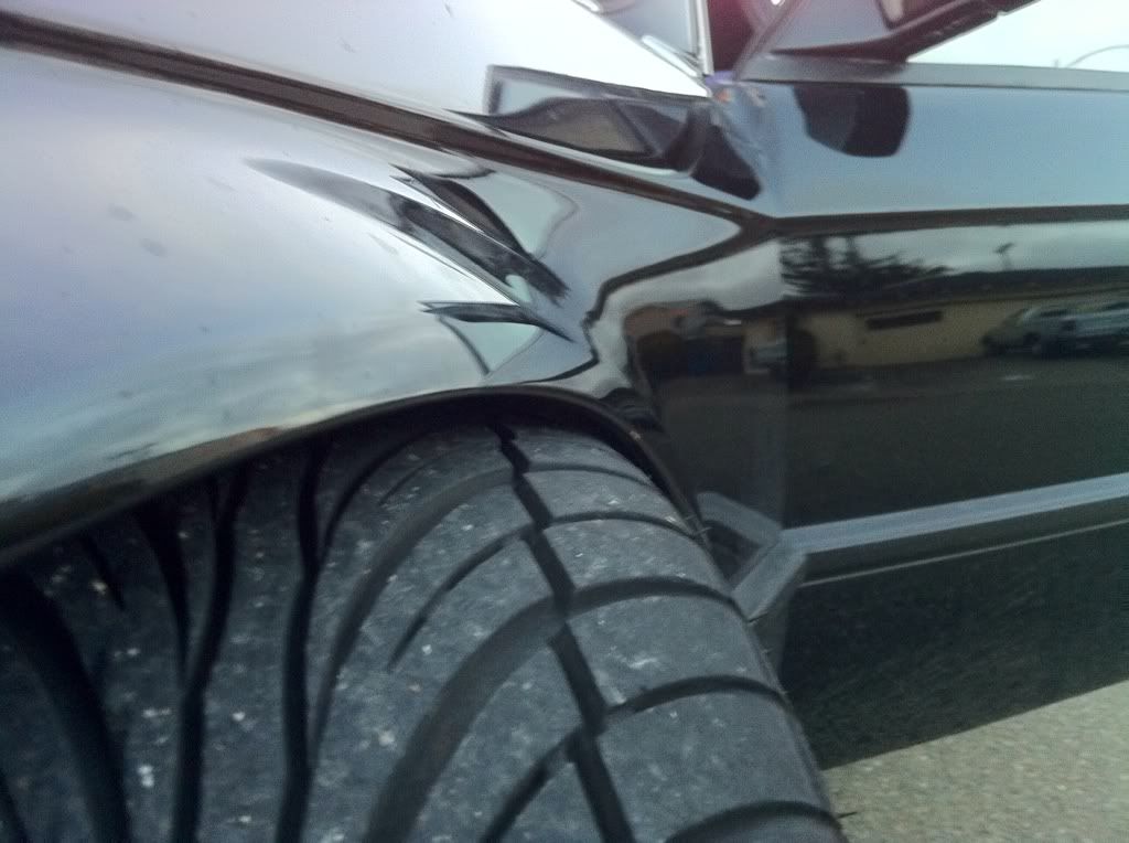

            I can't believe I barely rub, only on HARD Cornering, and only on the left side because the fender liner there is hanging down a bit, right doesnt rub at all.

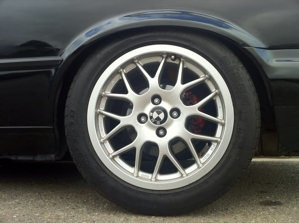

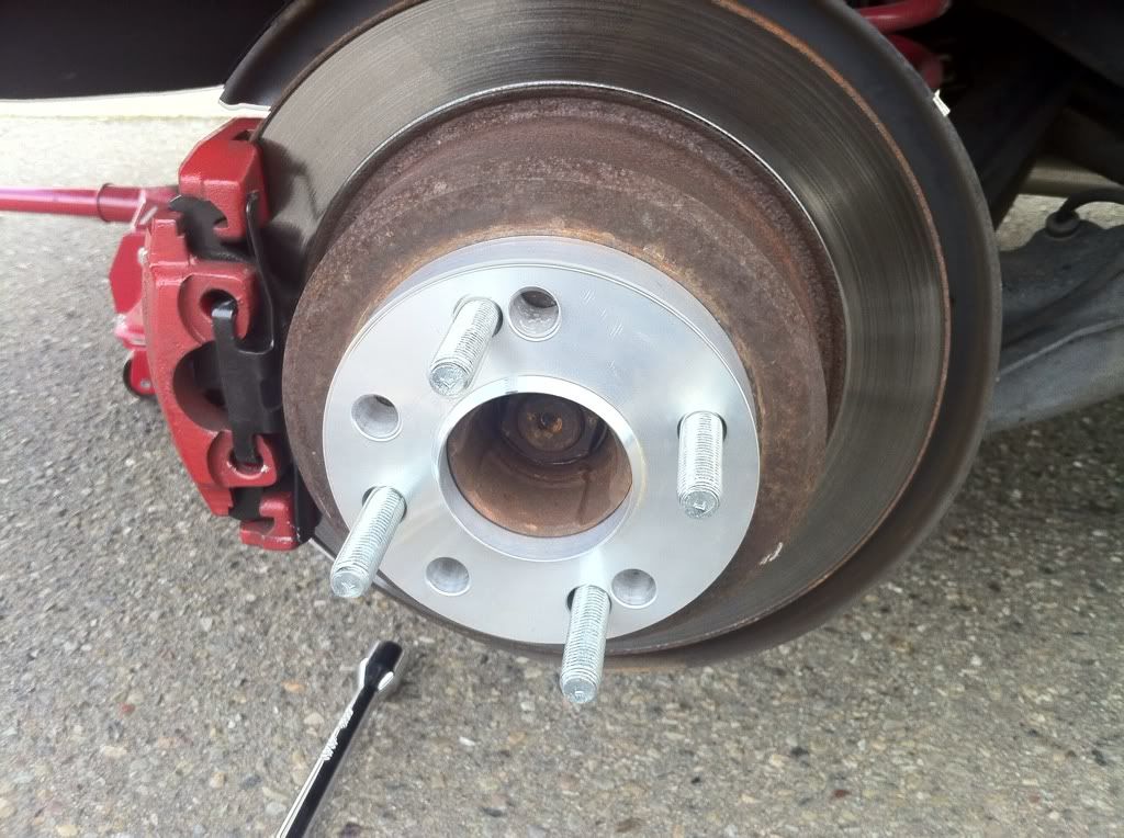

                So, I'm kinda sick, so only a small update. Installed rear studs, went from 10 to 20 mm spacers, I like how they fit, no rubbing still, but more flush :P. Im happy. And the wheel studs look waaaaay better than my old nasty lug bolts.
                Now whats left is:
                Wideband, m50 injectors, Miller MAF/War Chip, and adjustable cam gear and learn how to use the miller tuning.

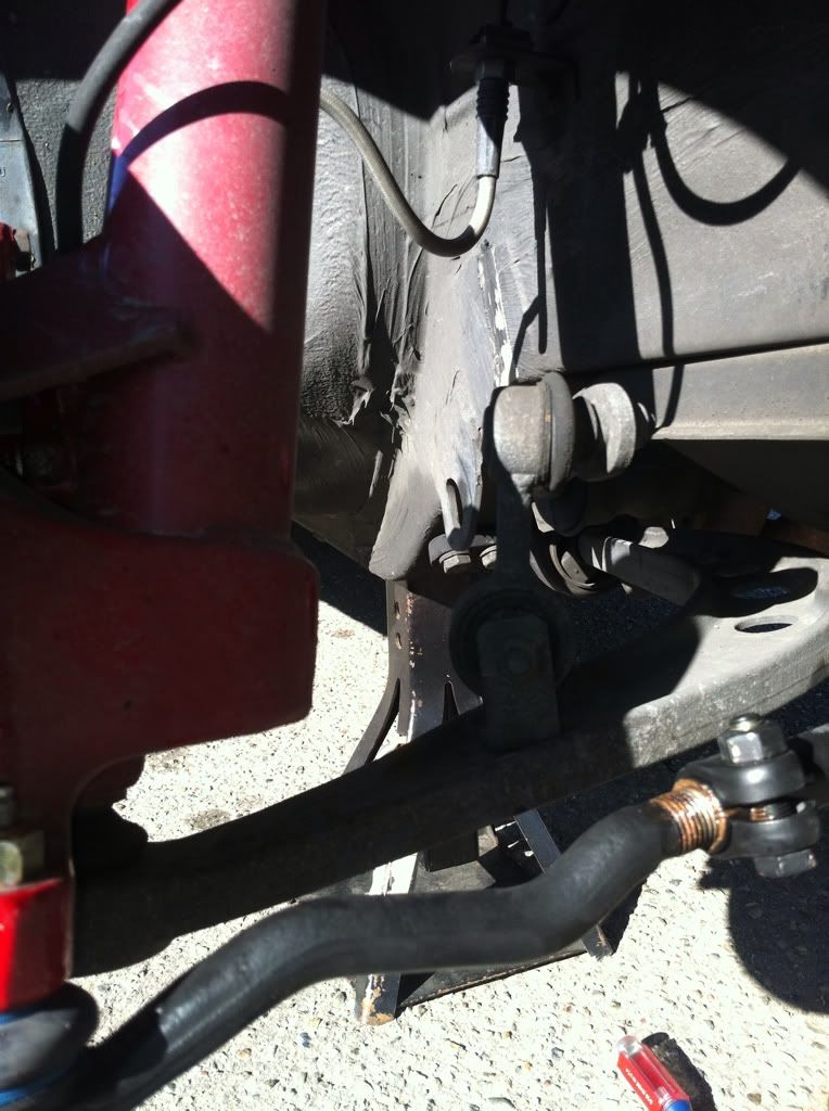

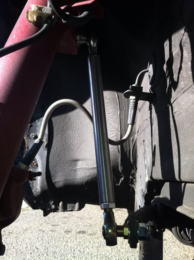

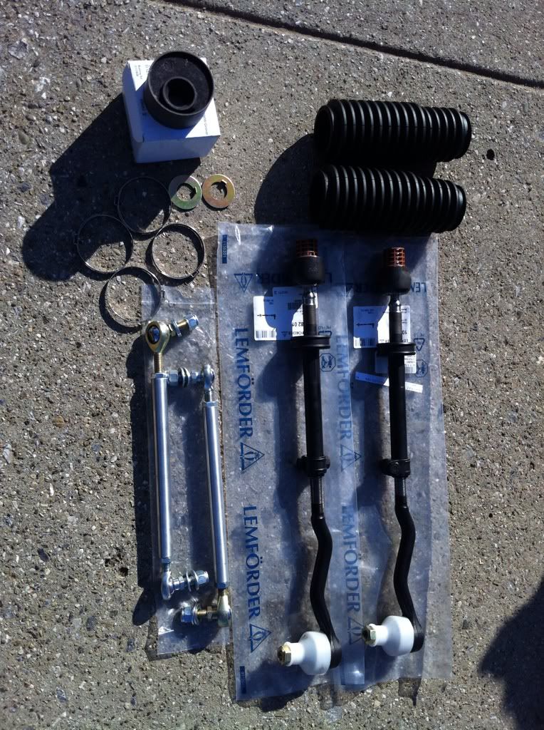

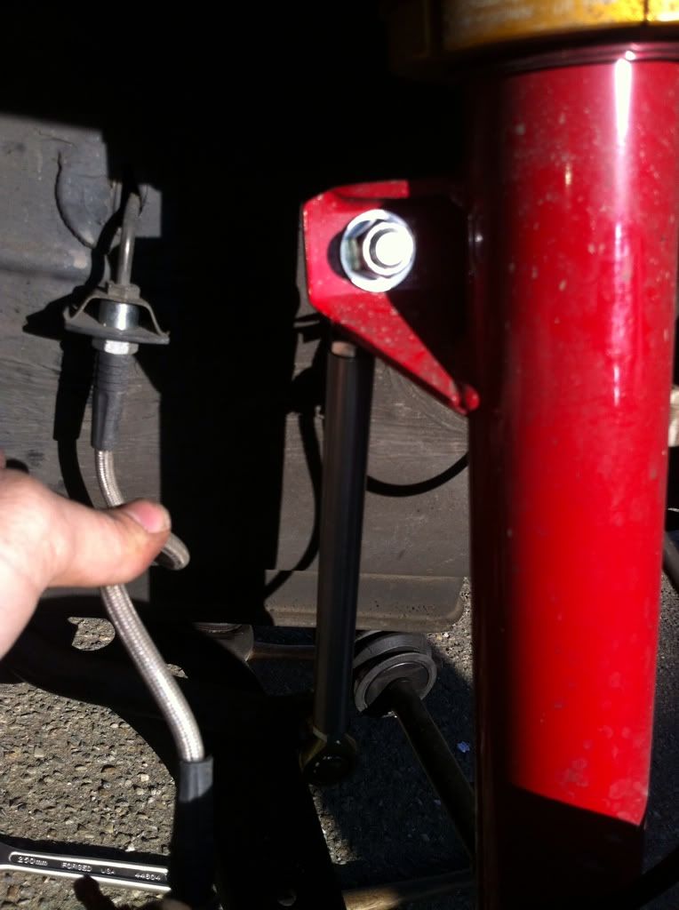

                    Question: Whats the proper way to adjust these drop links...I want the sway bar parallel to the ground right? Isn't the most effective geometry a 90° angle? The way the drop link mounts the m3 way, its not 90° with the ground, if you know what im saying, I've adjusted the swaybar drop link to be 90° with its mounting point, but not the ground, its at about a 10° angle with the ground, seems like its working better than before, but then again my old drop links were torn up.
                    Whats the proper way to adjust it so I avoid "preloading" etc.
                    I felt like if I was to adjust it longer i'd eventually just unthread the rod end, so i stopped where its 90°*with its upper pick up point.
                    Someone please chime in, heres some pics to help clarify i hope.
                    Heres the old way to the control arm.
                    All my parts :)

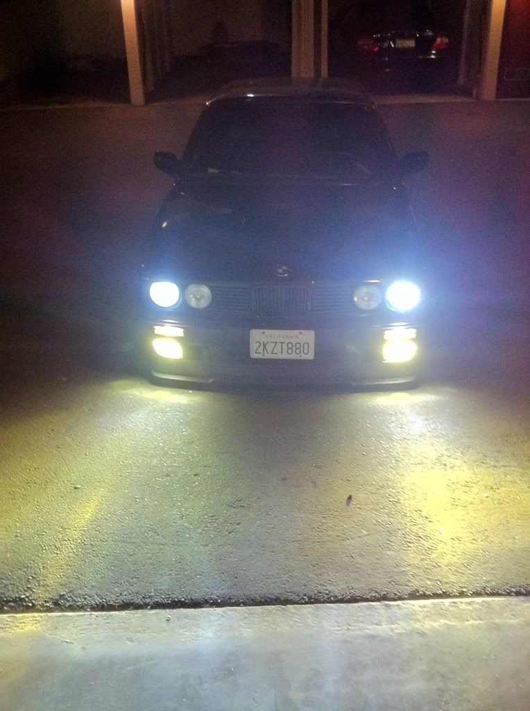

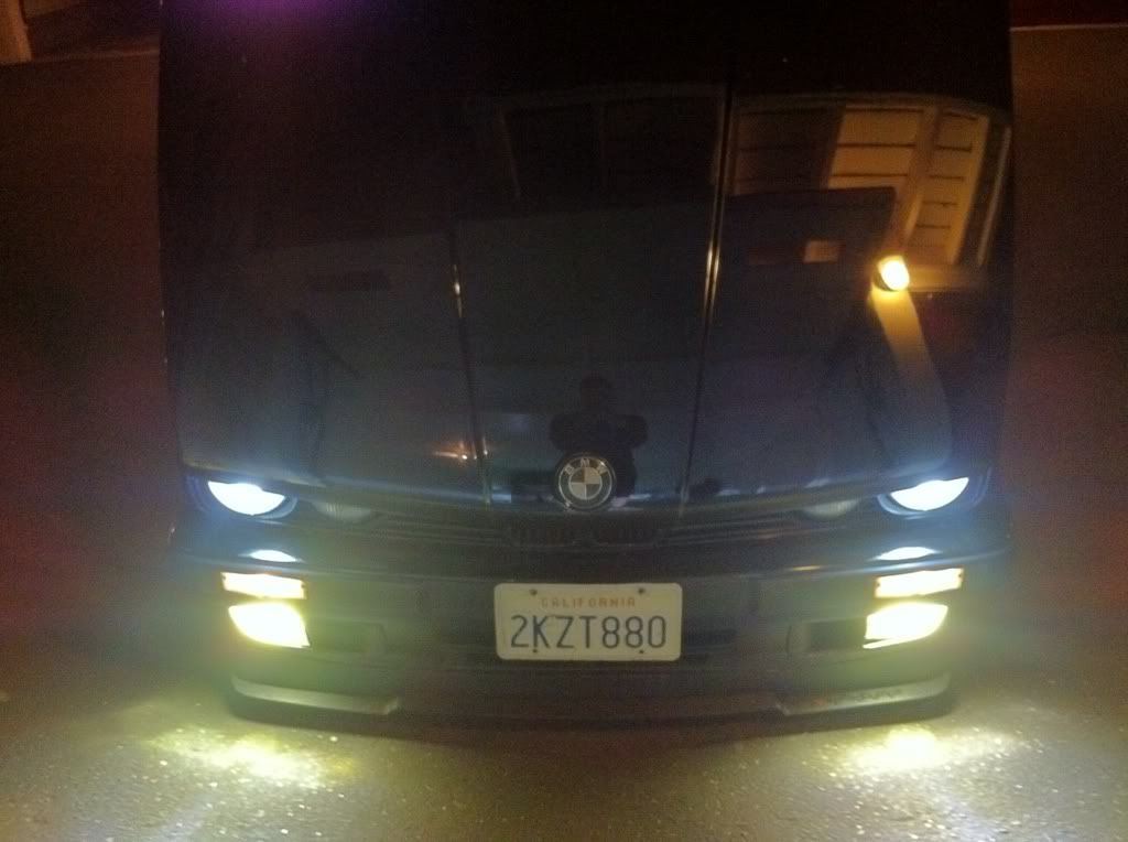

                    Also got rid of the stupid LED's that I tried in the dash, didn't light of for crap, so got the brightest bulbs i could from kragen. Looks great :)
                    And fixed the one HID, i had out, and snapped a couple pics, Visibility is awesome,
                    DDM Slim Ballast Raptor Kits, 3000k Fogs, 5000k Low beams.
                    Once again, please inform me of the proper way to adjust drop links. I will call IE monday, but don't wanna damage anything driving this way.

                      Also, did I install them upside down? Theres no difference to me in which side should be up. Theres a silver rod end and a bronze rod end, which is up. Kinda annoyed that IE would provide NO instruction of install or adjusting along with their product, Theres no marking or anything that says top or bottom,

                          And I spoke to IE and he set me straight on the drop links, turns out I did install them correctly.
