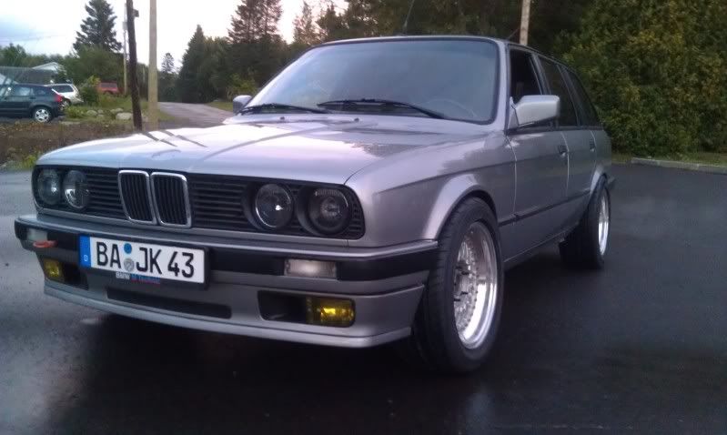

        I noticed a sign..."Clearance Yokohama S-drive 99$ each..." They didn't had a lot of sizes left but they did have 4 225/50r16.(I had driven a GTI
        really hard last year with a set of those and they were awesome.)
        In the rear they fit perfect. In the front thought its tight, like really tight.
        I was planning to roll the fenders to be "safe" but I was also considering 215/45r16 at first... now its necessary.
        I will also switch the THR Cabs for some AKG poly non offset ones to
        restore the caster. It's a really tight fit in front of the front wheel and
        I don't feel like I need more caster than stock.
        Also I wasn't planning to buy camber plates this year but it would help.
        Looking at the GC touring plates right now...( And H&R race)

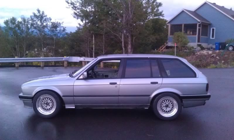

        Picture of the drop:
        H&R sports+e90 drop hats
        Spring pads in the front and spring pads+1 in the back
        I know I need to reinstall the side skirts.

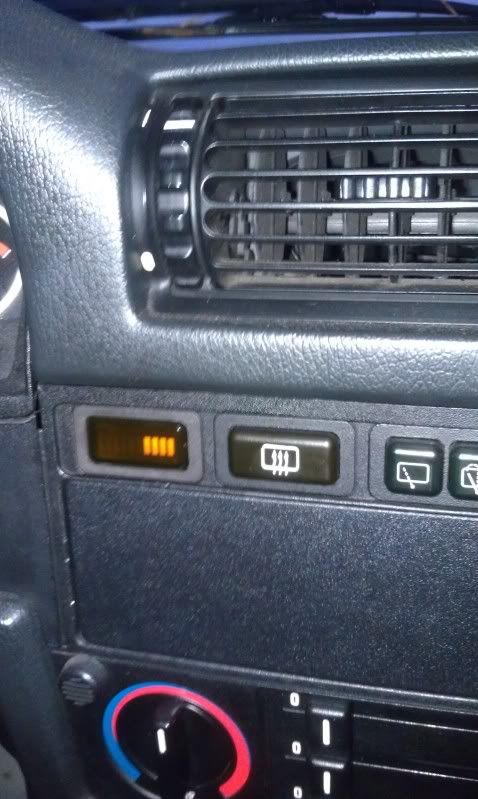

        Also wired my GG voltmeter, its really nice.
