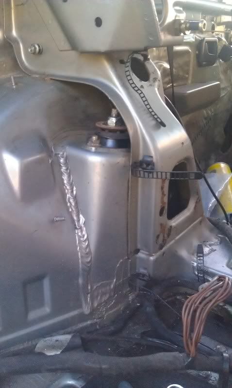

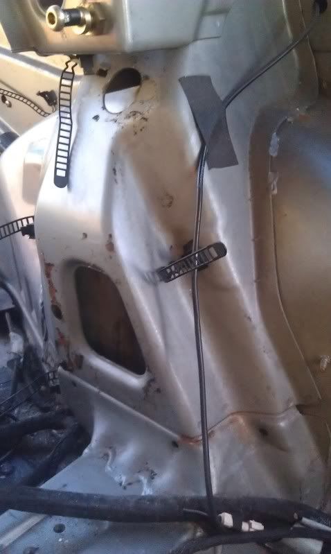

                      Update this week is almost nothing... :-(
                      I don't have my parts so I can't do shit.
                      I only worked on the car today and half of the day was going from
                      one driveline shop to an other trying to find someone willing to fix or
                      cheap enough so I wouldn't have to buy a new one. That didn't go
                      to well...dealer got my money BUT I will have a new driveshaft +CSB
                      +Guibo in 5 to 7 days... So my car should be on the road in less than
                      10 days which is great news for me.
                      The only did small stuff today mainly check the torque on each bolts that
                      I had removed. I found a few that were not torqued properly so I'm glad
                      I did this even though it was time consuming.
                      Also installed the rsm reinforcement plates. I had installed a set on my
                      318is as well and installation was a bit easier last time. Not that it is
                      harder but more time consuming.
                      The RSM on a touring are a little bit harder to access than a sedan.
                      You have to remove the seat belt base to access the second bolt of the
                      RSM. Also My interior was already apart so that made things easier
                      otherwise I would have had to remove the whole panel that normally
                      covers the wheel well.
                      Also don't do like I did and install the RSM in without the shock already
                      installed...I only did this on the first one. I was wondering why it was
                      so hard to access the bolt
                      So that is pretty much it for this week. More when I get my parts from
                      Blunttech and my drive shaft from the dealer...
                      Charley
