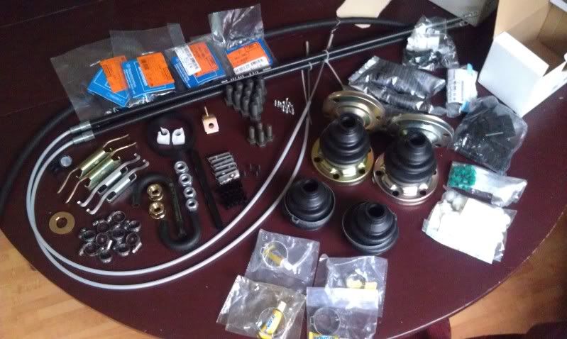

              My order from Blunt came in :p :
              It doesn't look like much but aside from a drive shaft this all I needed to
              get the car back on the street.
              Also I now Rep Blunttech to the fullest
              Signed by the man himself!

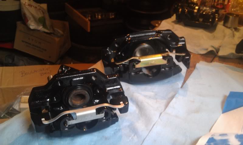

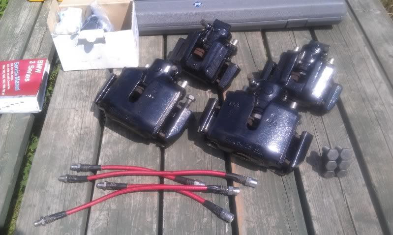

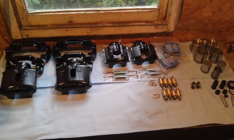

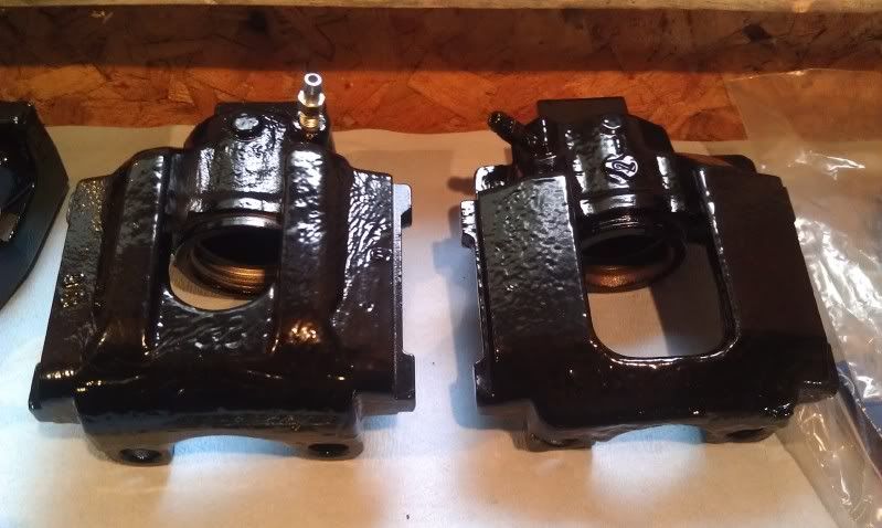

              Then got all my brake caliper parts together to start reassembling them:
              Then I quickly noticed something was wrong. When I sent my calipers to
              be powder coated one of them ended up being bad I needed to be
              replaced. The shop offered to source a new one for me which I agreed to.
              Few days later I picked them up and brought them home. Thing is I did
              not even bother to check if everything was fine, I just left them in the
              bucket they were in till today. This is when I find this:
              Left is m3 right is what I believe to be plain stock 325 caliper... I DID
              mentioned a few times that the calipers were from an M3 to the shop
              owner...( I don't have my old rear calipers at home right now to check
              if it is indeed a stock 325 caliper)
              Now I need to call them up tomorrow and sort this quickly.

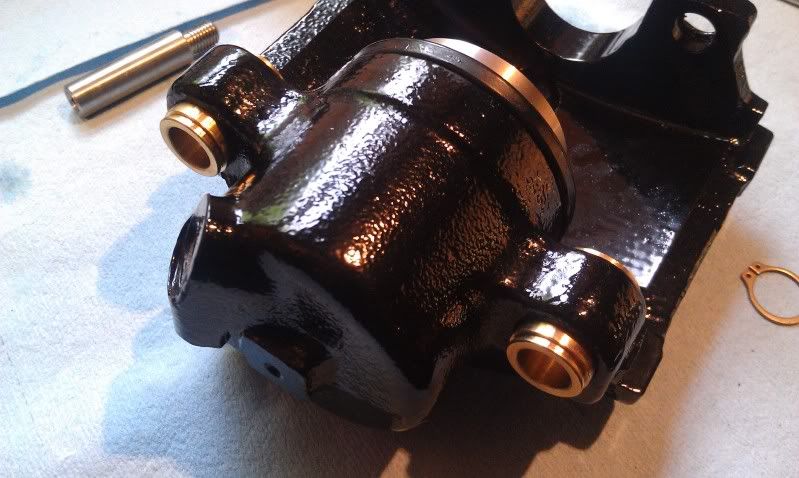

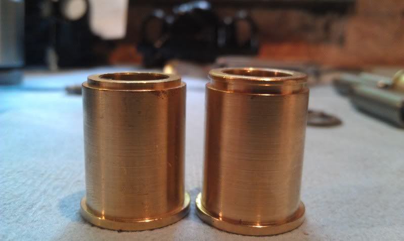

              So after this I decided to go forward and install the solid brass bushings
              and well this didn't go well either.......
              First this:
              And then :
              Seriously WTF?
              Now I'm tired, pissed and heading to the movie theater to see Captain
              America...
              I'll deal with this tomorrow after work..

                  I reassembled the the calipers as much as could. Still missing a caliper.
                  One rear, two fronts are done.
                  I couldn't finish the reasembly as I didn't have a 7mm allen socket to
                  use with the torque wrench... will buy one tomorrow.

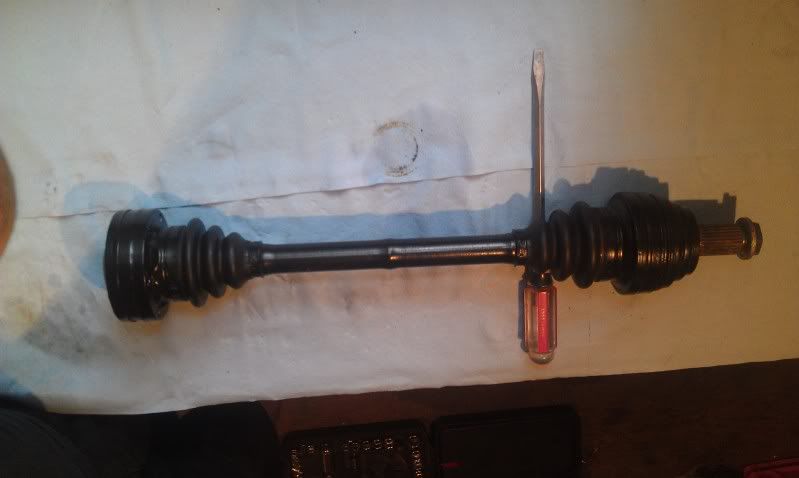

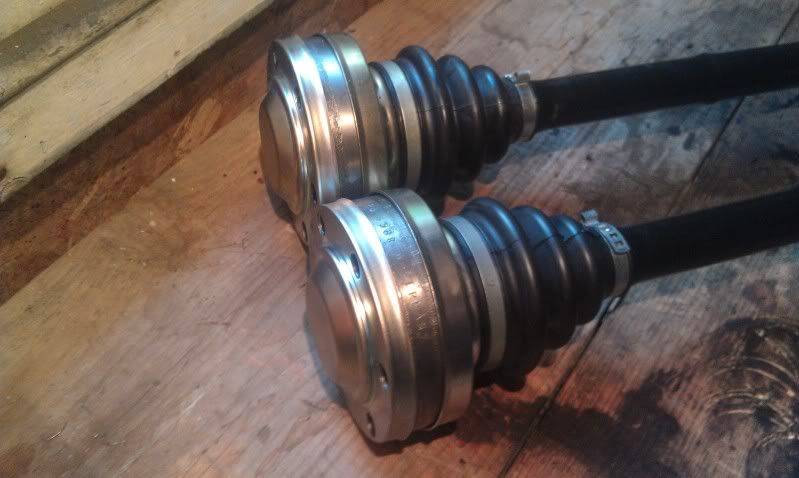

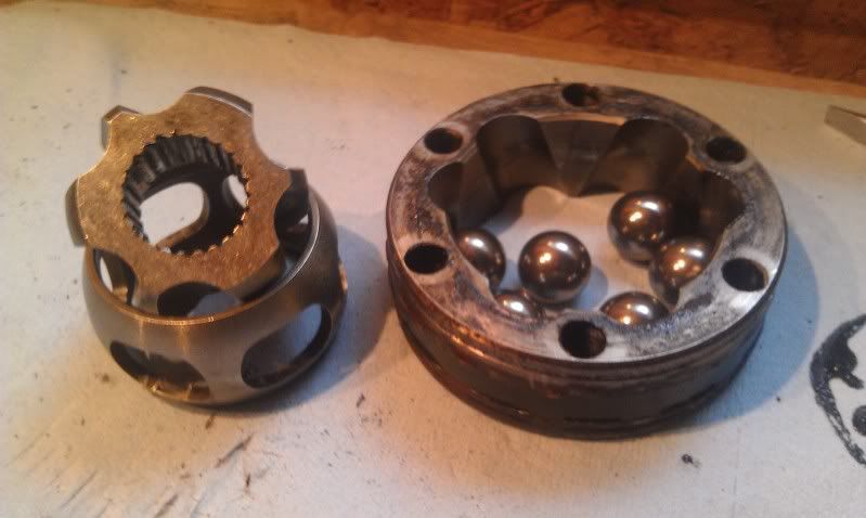

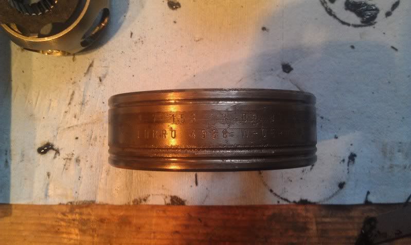

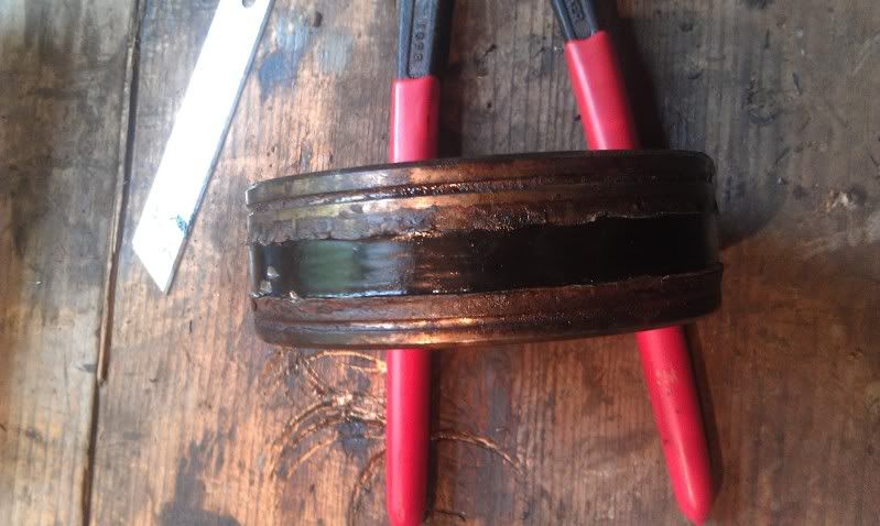

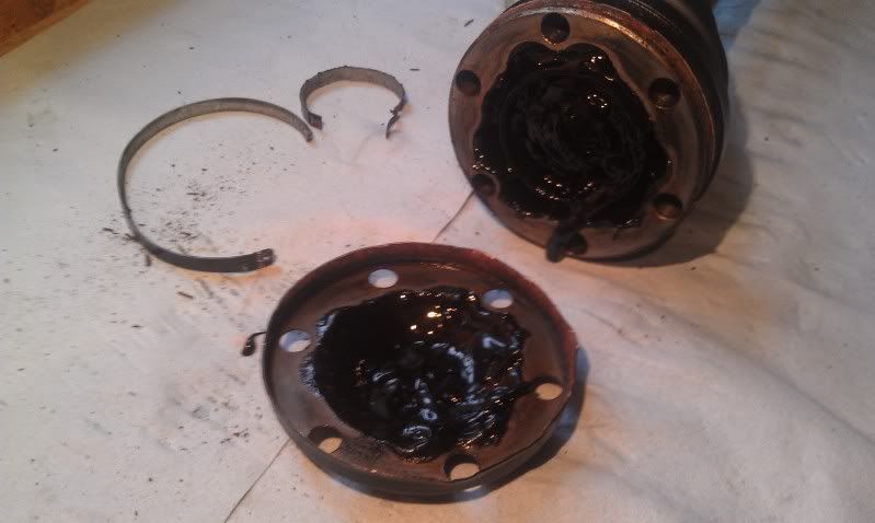

                  Then I replaced the boots on the half-shafts, the old ones were cracked
                  and about to rip open.
                  Started with this. I painted them a while ago so they still look good.

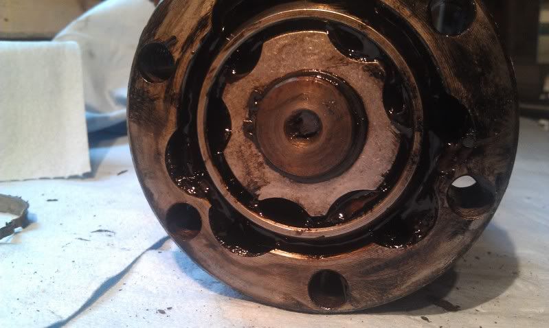

                  Then popped the cover. Nasty grease...
                  That grease smelled BAD
                  Cleaned a little so I could see where the circlip was.
                  Disassembled:
                  Dirty:
                  Cleaned:

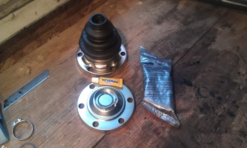

                  New boot, clamps, grease and some Dauerplastische Universal Dichtung!
                  Dauerplastische Universal Dichtung=Permanently plastic universal seal(google)
                  Fast forward:
                  Bam all 4 boots replaced! This job ended up taking a lot more time than I
                  thought it would. Cleaning being what took most of the time. Also this
                  is a pretty messy job.

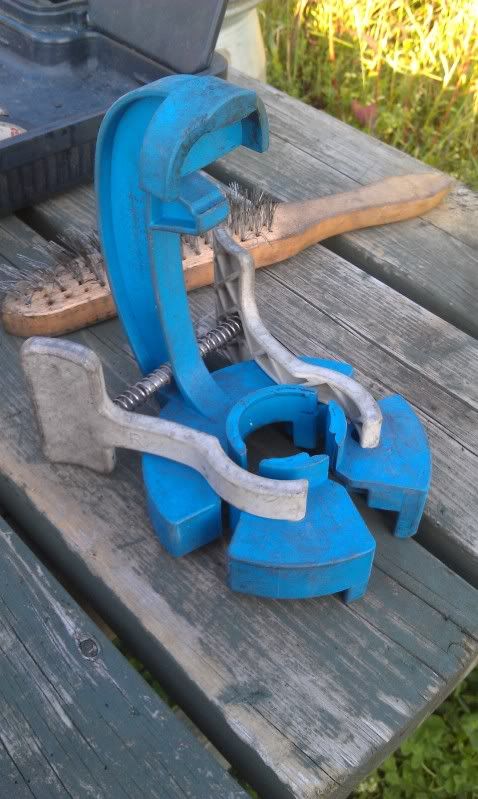

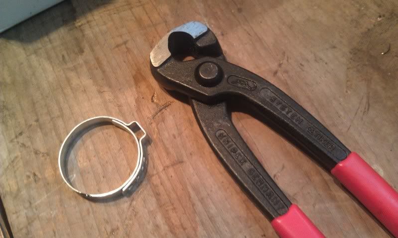

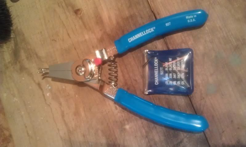

                  Also to tighten the OE clamps you need one of those tool:
                  They look like unsharpened wire cutter.(mine are stamped Germany so they must be good)

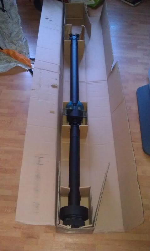

                      Today's update;
                      Well we got some rain showers that slowed my work a bit but otherwise
                      I think I did well.

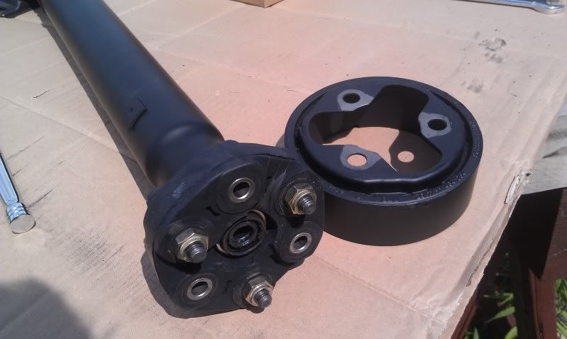

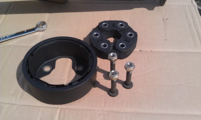

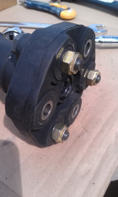

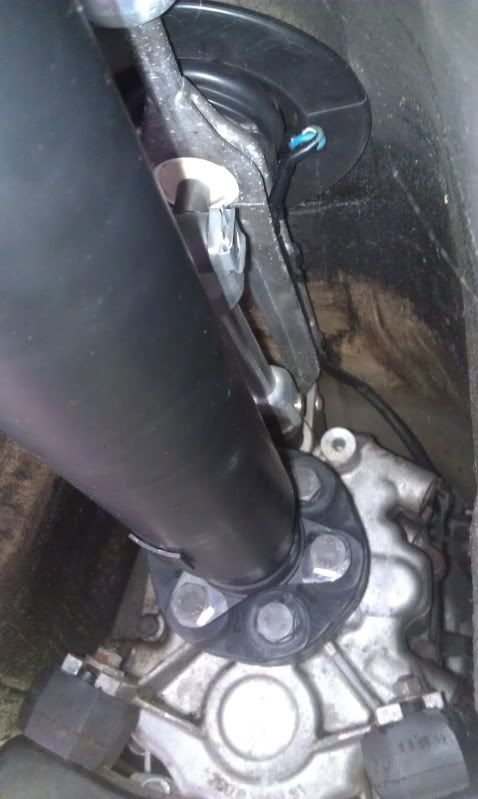

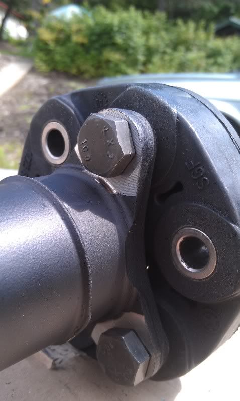

                      Installed the drive shaft:
                      I removed the damper first. This is how it is "stock"
                      Removed:
                      I first reinstalled the giubo with the original press in studs that the driveshaft came with:(notice the amount of thread that is sticking out)
                      I had already ordered new bolts last fall so I tried them on:
                      They poke a little less so I used those instead.
                      Then installed:
                      Sorry for the out of focus shot (cell phone pics ftl)
                      Also notice that I have all the bolts facing the same side. I know
                      some people say that the bolts should be placed acording to the arrows
                      on the giubo but if you check the first pic that shows the "stock" driveshaft, you will
                      notice that the studs are not in the right direction. Also you could not mount the bolts on the transmission side if you were
                      to keep it in this position...
                      Also the pictures in the bentley show the bolts all facing the same direction. So I don't think it actually matters.
                      I know the transmission mount on the right seems tired...I will order
                      some e21 units in my next blunttech order. (already have the AKG cups)

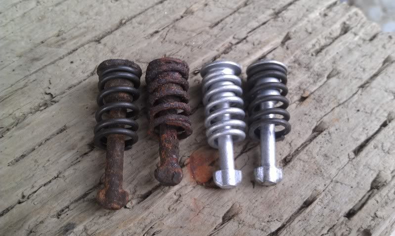

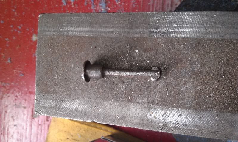

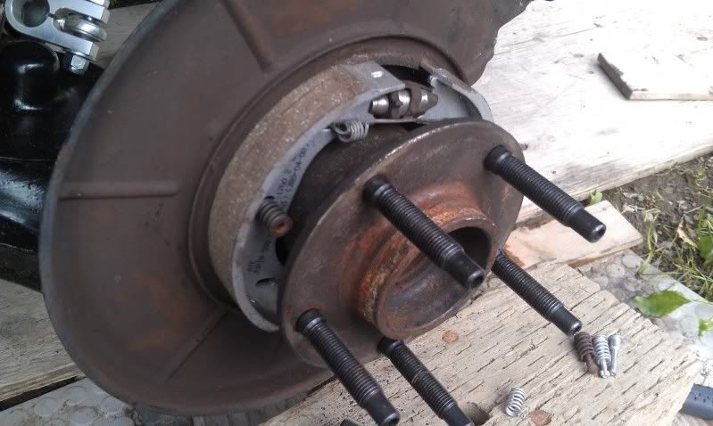

                      Next was reassembling the e-brake assembly+new cables.
                      The new cables were a breeze to install unlike the removal of the old ones. I did coat the ends with anti-seize before installing them.
                      Then I went to put the pads/shoe? in and found out that the new ones
                      I had ordered were 28mm (standard 325i I thought they were the same
                      since the pads are) and the M3's are 33mm...
                      from left to right: M3+new spring, stock 325i, brand new 325i and new pin with new replacement spring.
                      So I reused the old ones. Also had to fix this:
                      It was like that when I took them apart last fall...
                      Then cleaned:
                      All reassembled

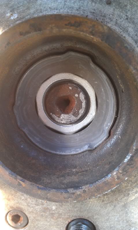

                      Then I put the halfshaft in. One went in super easy and the other was a pain to install. I think it was a rebuilt unit...
                      Also I had bought new nuts and securing plates... the securing plates
                      are not big enough to fit around the nut
                      I think I'll just grind them a bit on the inside to fit them..

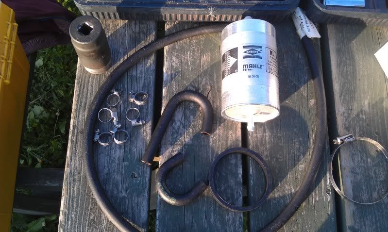

                      Also installed this:
                      New oem filter +new hoses+new clamps.
                      The old hoses were all cracked, the old clamps were rusted and the old filter was on there since who knows when.
                      This car had very little maintenance made before my ownership...
                      Also when you buy a new driveshaft it comes with one of these:
                      It keeps the two halfs of the driveshaft together so they don't split during
                      the shipping... Now I need to find a use for it.

                      Also received my replacement brass bushing to replace the defective
                      one. Bimmerworlds really has a great customer service (at least when you talk/email with Garey). It's also funny to see the UPS guy show up at
                      your door with a 4"x4"x4" that weight nothing...

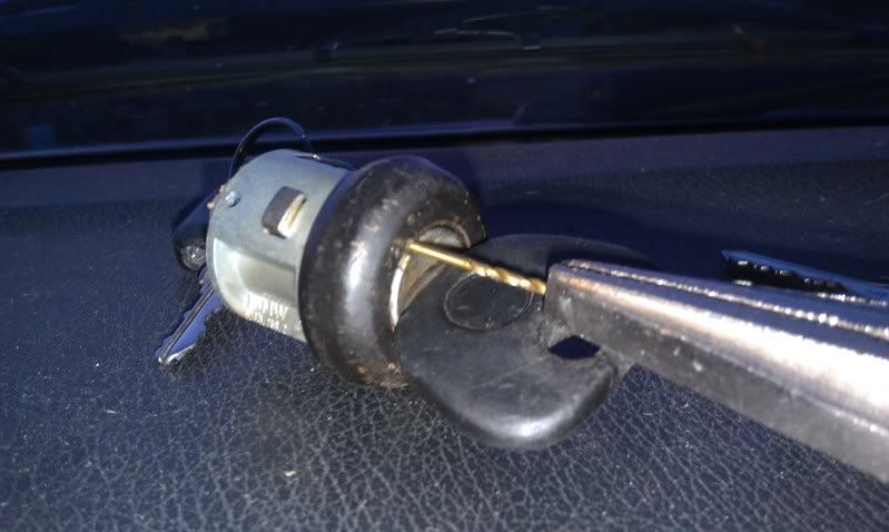

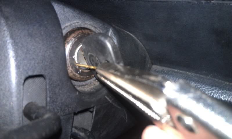

                        My car had two different keys since I bought it. One for the ignition
                        the other for the driver's door... Passenger lock doesn't work with
                        the key and I can't even get the key in the lock of the hatch...
                        So I started to change the locks with the ones of my old 318is. I
                        had a brand new key cut before the part out and I have two other
                        keys as well. 3 keys is better than the two single ones I have right
                        now...
                        Only had time to do the ignition one before I ran out of light.
                        To change this lock you have to use a small rod of some sort.
                        I used a cheap 11/64 drill bit from the the tool set I won at
                        the work Christmas party. I think that there were 6 or 8 of
                        the same size so breaking one wasn't a problem.
                        To get the old one out just put the key in and place it at acc. then push
                        the rod in the hole with a little bit of pressure than wiggle the key.
                        You can see the pin that holds the lock in on this pic.
                        Once that pin is lowered the lock just pulls out. Install of the new one is
                        the exact opposite of the removal. Also the smaller the key, the easier
                        it is to maneuver the rod in the hole.

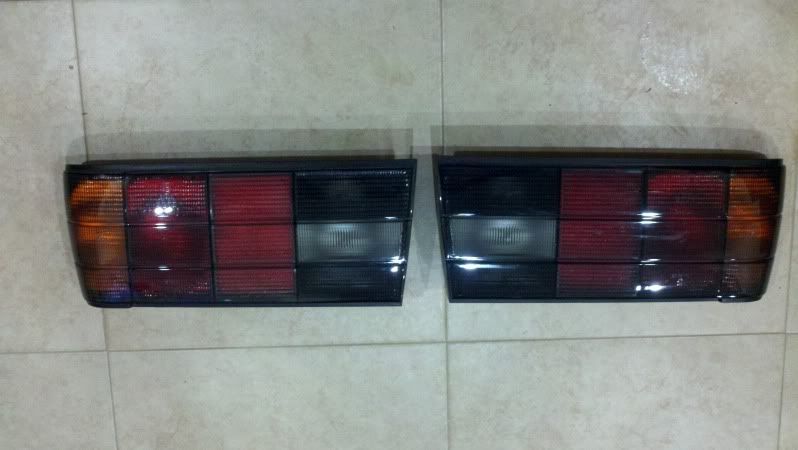

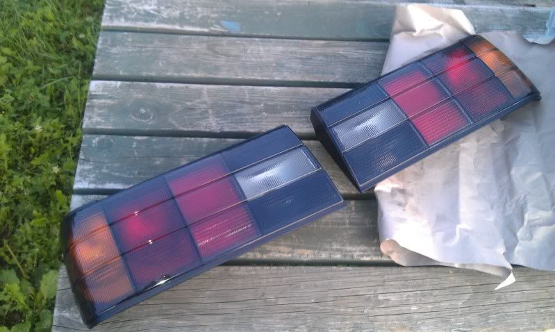

                        Also when I came back from work, I had this box waiting for me.
                        What could it be?
                        Oh nevermind its just a box full of packaging materials.
                        Oh wait there is some plastic parts in there!
                        Old school lights/old school pic
                        Very happy with those, perfect fit with the Hella's

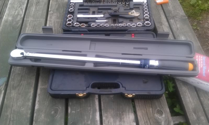

                            Brakes are installed, still need some bleeding(system was completely
                            empty).
                            Bought new tools
                            It was on sale:
                            Got pissed off at my old cheap one so went and bought a good one:
                            And stopping to take pictures every now and then takes time... So I
