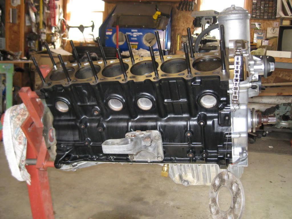

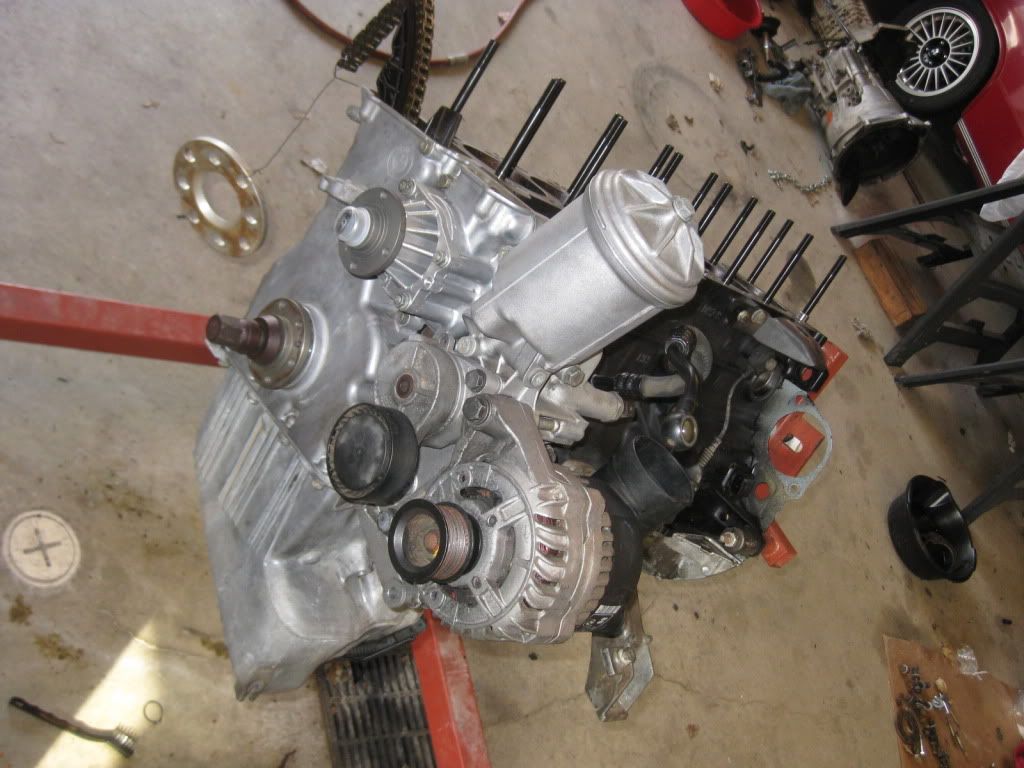

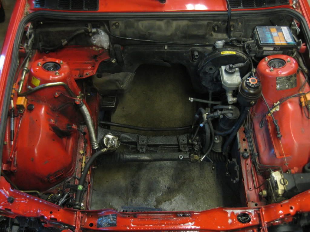

          so i got a few things done on the car. I pulled the motor last night after dinner before it got dark. I have to work outside on the driveway for now because my garage is full but ive sold a couple cars so as soon as i ship 2 motors I will have a bay free so it can go inside. Today i took my 02 out and pushed the e30 in to wash the bay up and swap out the booster. Gutenparts was good enough to supply me with an 02 booster and they shipped it down to Good and tights where he shortened the shaft for me. I dont have a welder and he offered to do it for me. Good and tight is skilled with all size shafts by the way. As a side note right after i got the motor out super duper and his girlfriend drove in the driveway. Bob was shocked at the progress Im making because Ive done more work in 2 hours than he has in 2 years. He seemed rushed so i imagine he went home to try and get something done on his car so he doesnt look so pathetic. Heres a couple shots of the motor going together. im lucky to know a bunch of guys at the dealer and my friend peter is a tech there. He always borrows all the tools needed for head removal from the dealer and stops by to help

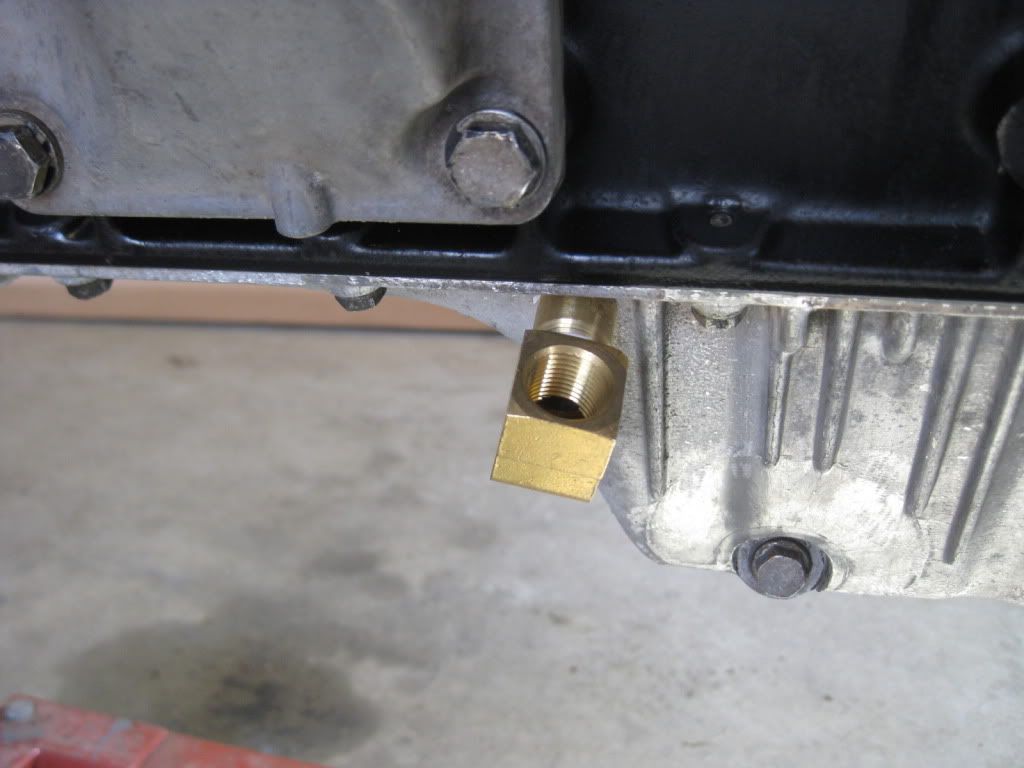

          and this is how I did my turbo drain. I think itll be ok.
          so here is the obligatory before and after shot. 1/4 million miles of grease and oil.
          I would normally rub out the inner fenders and wax them but fuck it. I just want a clean driver and im not going overboard on this car. as long as its clean im fine with it
          before
          and after.. I got a little carried away with the cut off wheel while removing brackets. i accidentally went through on the drivers inner fender just a tad. So I need to fix that
