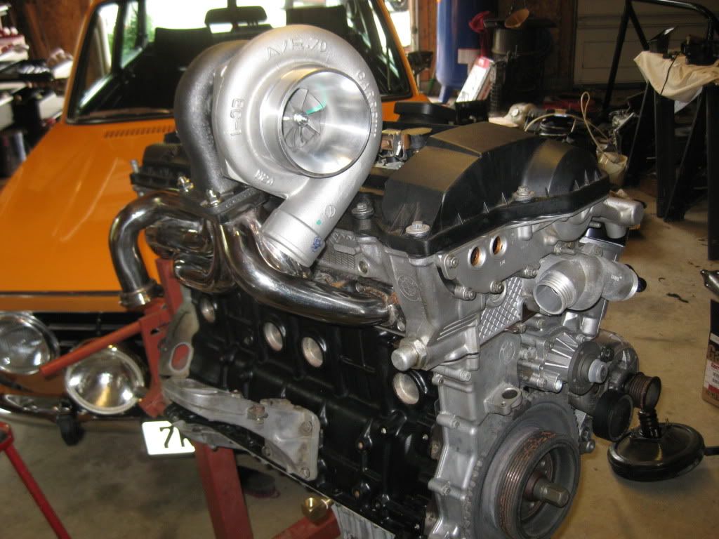

        new goodies are showing up daily. Got our new manifolds in so I temporarily bolted it up to see how it looks. New Garrett turbo and a south bend clutch. God this gets expensive

            Sweet. Now maybe i can get some decent intercooler with a/c pics. Are you gonnah run a slim pusher or just a puller and see how that holds up?

              Im running a slim pusher for the a/c condensor and a slim puller for the radiator. I basically copied Good n tights set up .. its really tight and i had to cut a lot on the valance. But once bolted on it looks stock. I may just mist my intercooler with black paint so you cant see it at all

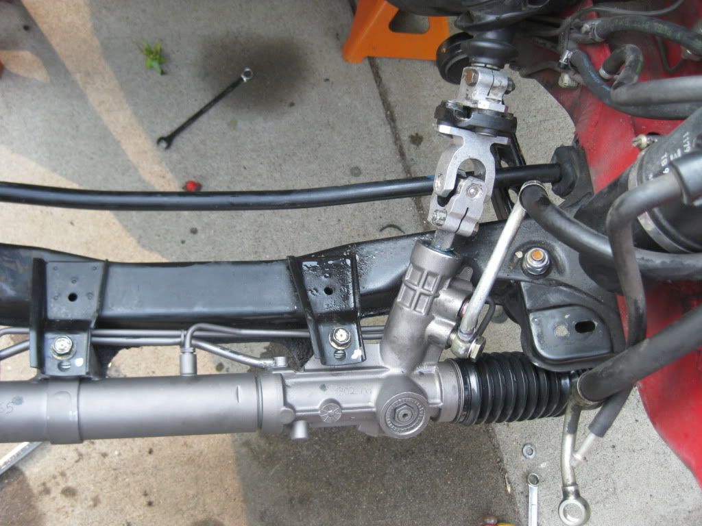

                          My rack was seeping ever so little and z3 Mavel racks are so cheap I thought it would be best to just do it while the motors out. I had a 4.0 lock to lock ZF rack and put in a 2.7 lock to lock z3 rack. Bolted right in with spacers and no mods to the universal joint. Just had to trim a tad for clearance and mod the bracket on the inside. 20 minute job. I swapped out the inner tie rods as i thought theyd be cheap ones but it turns out they are OE BMW inner joints.
                          So now the motor can go in

                            You going to reinforce your subframe?
                              probably should huh??? what are guys doing? What did you do?
                              My last s52 car I had plates machined out of 1/2" plate and welded them in.
                                Turner sells a kit. I didn't reinforce mine - my car doesn't see track duty anymore.
