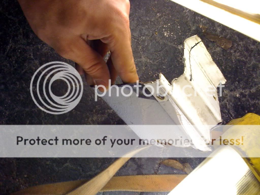

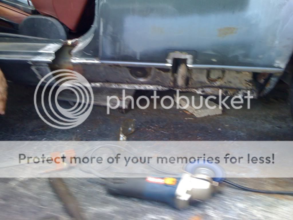

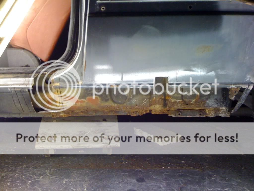

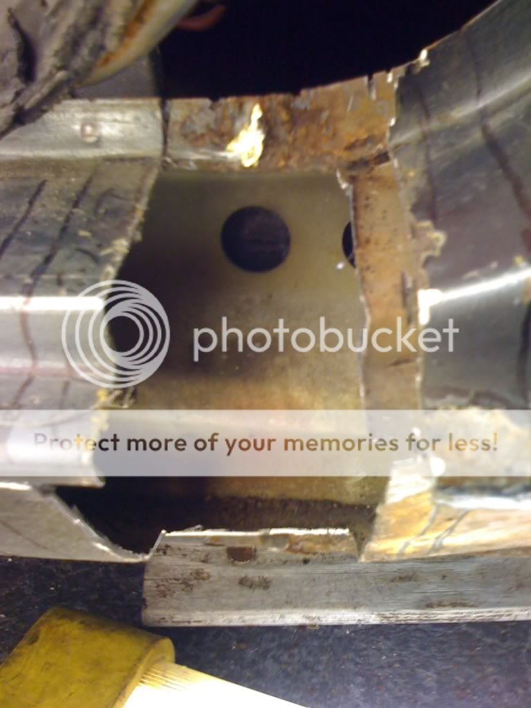

                Starting out by cutting out more rust

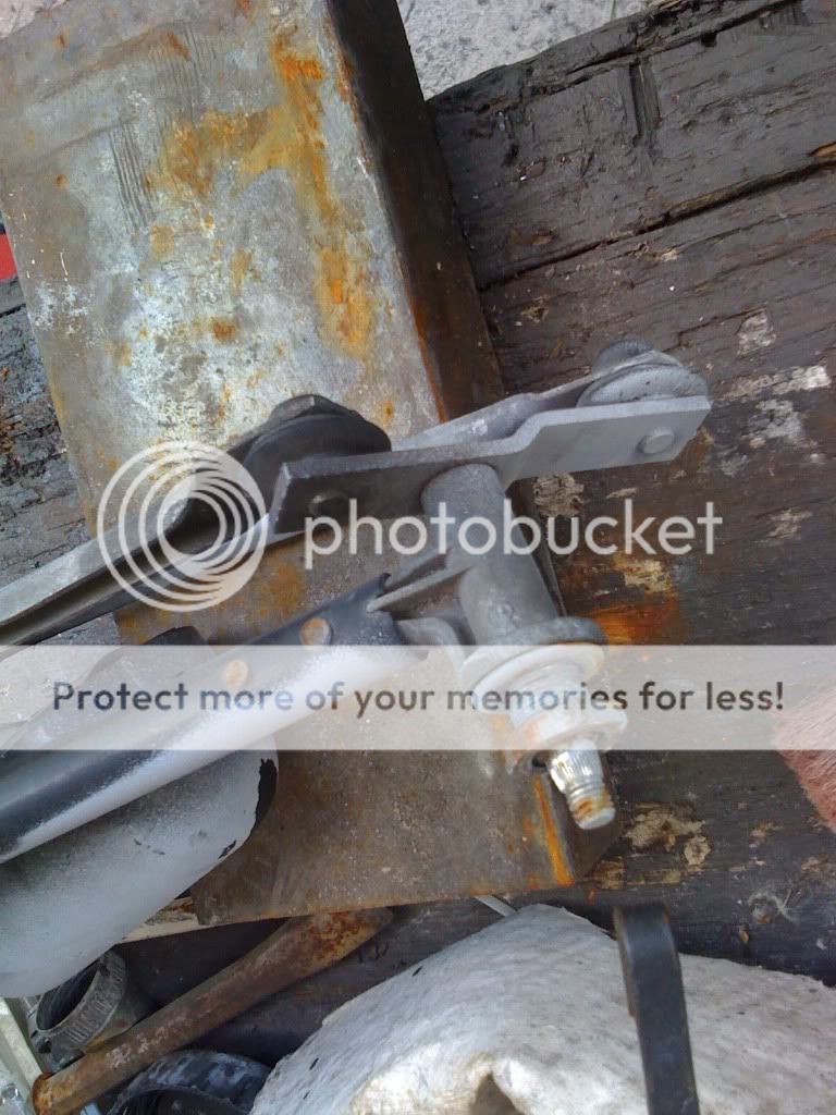

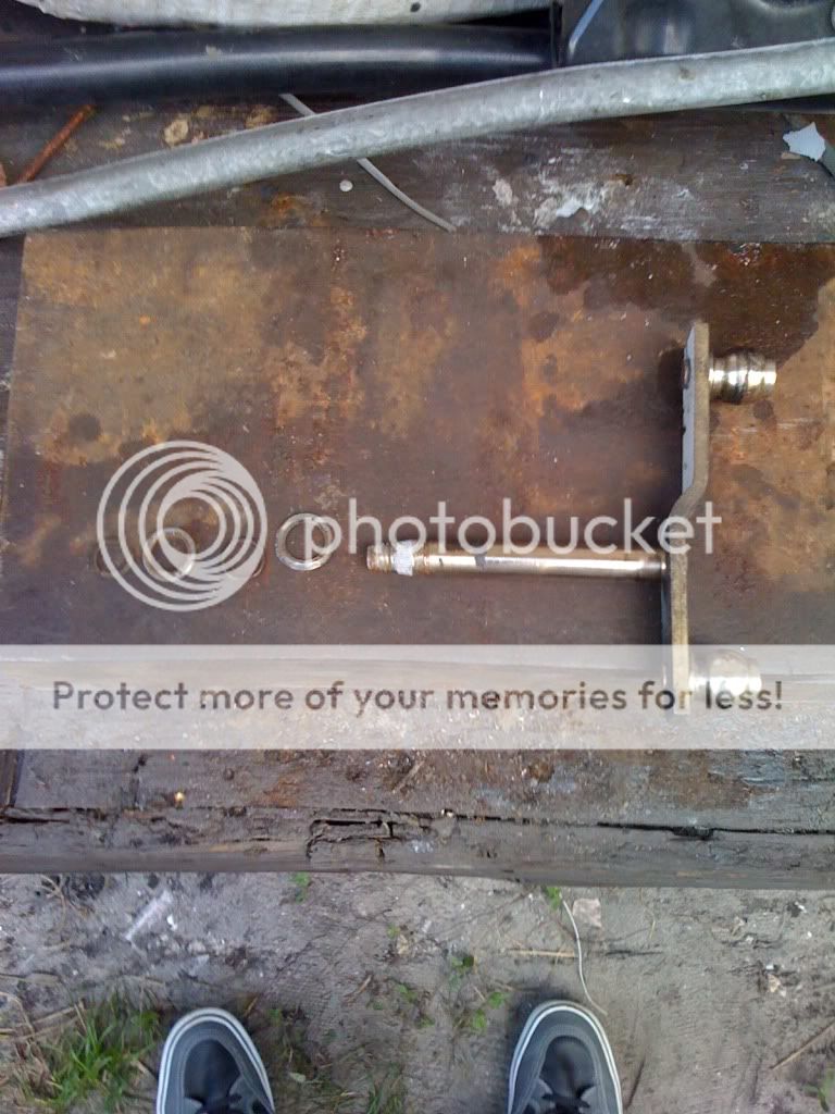

                Also began the monowiper challenge:p

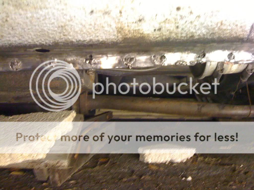

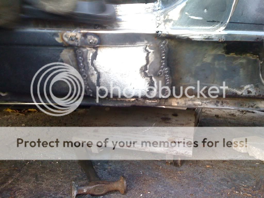

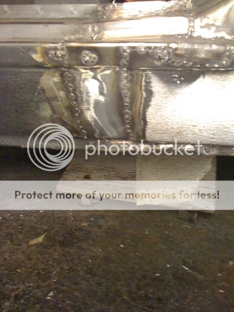

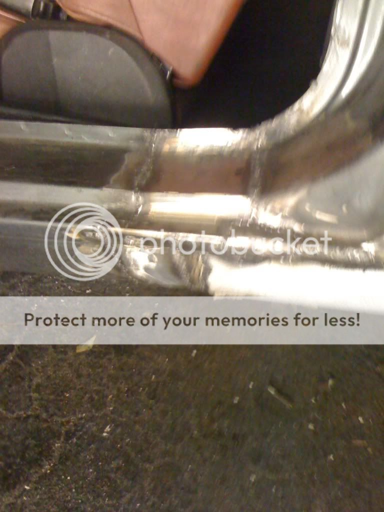

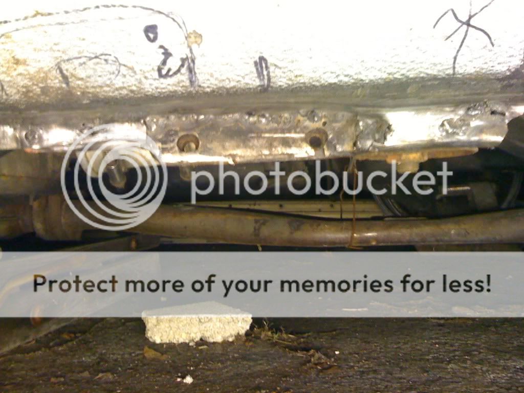

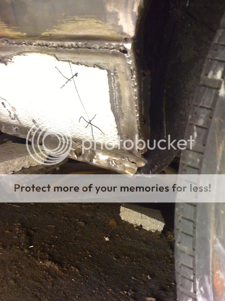

                  Next I had to make the patch, and Carlos's help it took no time! I picked up some scrap rocker panels from the shop that were rust free and used those.
                  Grinded down the whole area where there was rust & where we had to weld.

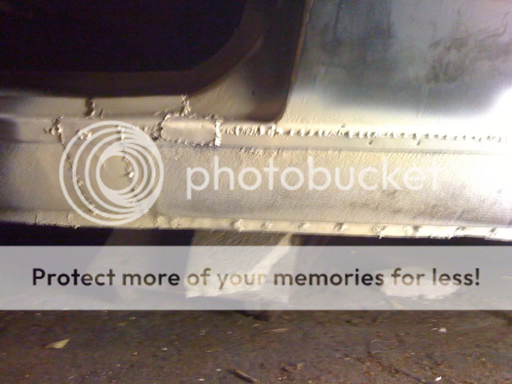

                  Then we welded a patch for the inner part of the rocker
                  Patch #2 welded in place
                  Then the 3rd and largest patch!

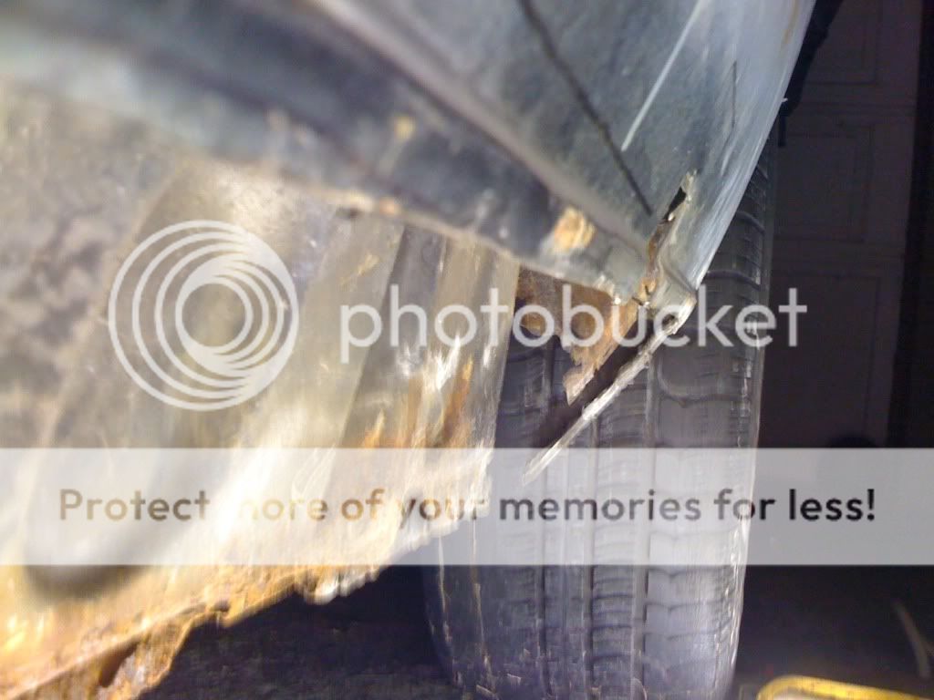

                  A shot from the wheel well
                  Then earlier today I flap wheeled the welds, caulked the lower portions that are covered by undercoaring and layed down some filler on the upper portion. The monowiper is also finished & has been cleaned and greased. I also have a "new" r134a ac system to put in. I bought the o rings and have almost completely removed the old r12 system, but low and behold, bmw thought it was a good idea at some point to run the fuel pressure regulator hose into the drier. So I need to figure out what to do before I can put any of the AC in

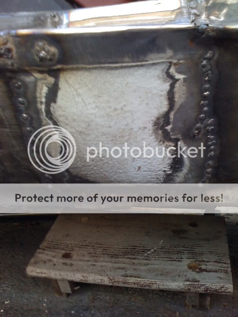

                            Then back to the rear end! Time to fix some of those sketchy welds and practice some more welding!
                            So cut the bad out...
                            And stitch the new in
                            Then fill with seam sealer!
