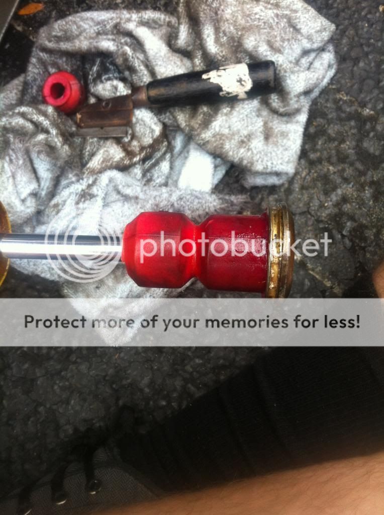

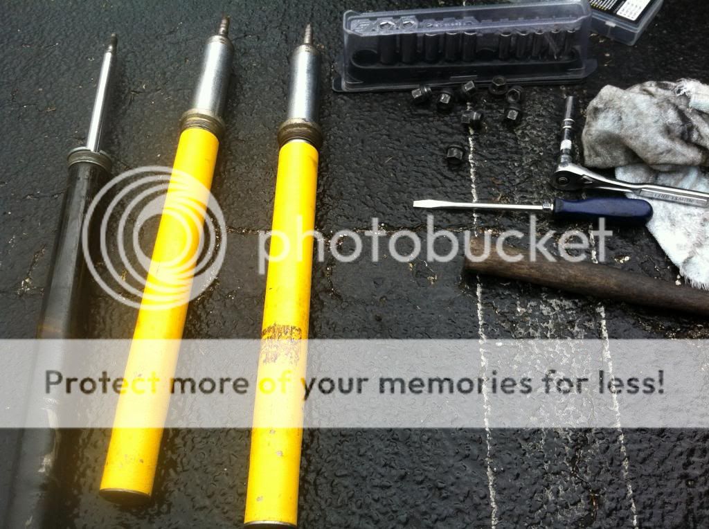

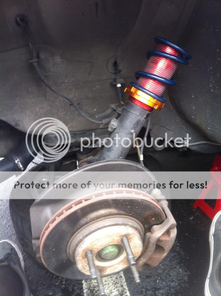

        Silicon intake boot is high on my to do list. I have a brand new stock one zip tied up, and it's holding...for now:p I would like to get it on the dyno, but right now I just spent my money on a whole weekend of HPDE in Homestead(March 23-24th)!!

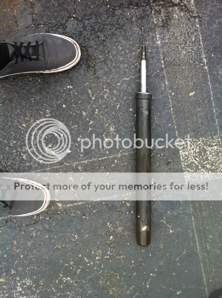

        So in other news, I finally got around to putting in the front struts. The rear Bilsteins are blown, so I'll get them rebuilt later down the road, but I have some KYB gas-adjust shocks that are working just fine for now. I also swapped the front springs for some 4" hypercoil 400lbs ones I purchased from Einstein57. The car is much smoother now, I no longer feel every bump in the road, reflector, branch, or paint line anymore:pimp:
        Out with the old....
        warning:super old picture!!
        And in with the new!
        Comparing the new & old
        The passenger side strut was destroyed!
        I decided now would be a good time to shorten the bump stops, so here's the regular length
        Ended up taking off just the first nub
        Also had to raise the perches up because the new springs are 3' shorter than the old(7'')
        And here's where it all took place!

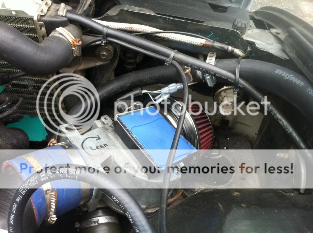

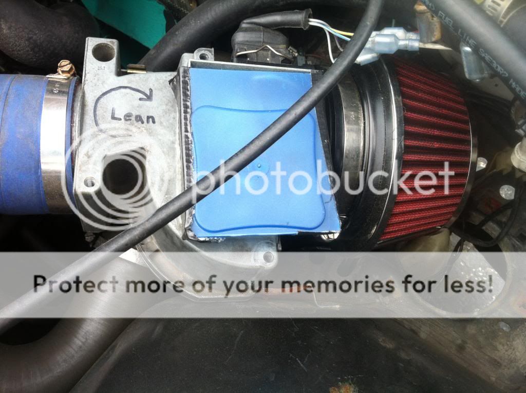

            Here's some pictures of the smaller filter, finally allowed me to put my 4th headlight back in!
            Then Hans came over & decided to critique my turbo set up:giggle:

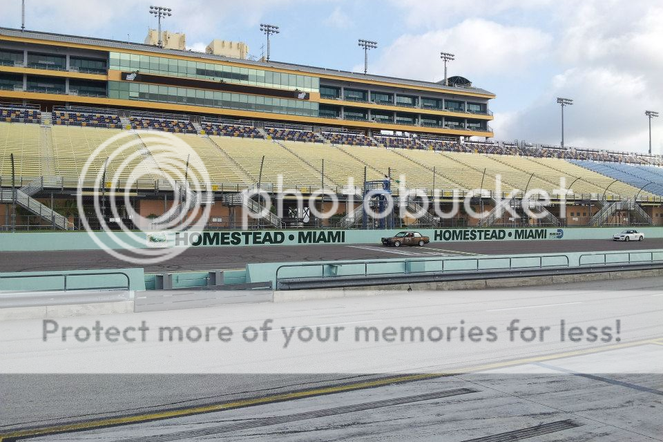

              Went to Sebring this past weekend & did HPDE. Had a blast! Here's some pics.
              Hanging out with some friends.
              Came in WAYYY to early on the toilet bowl here lmao

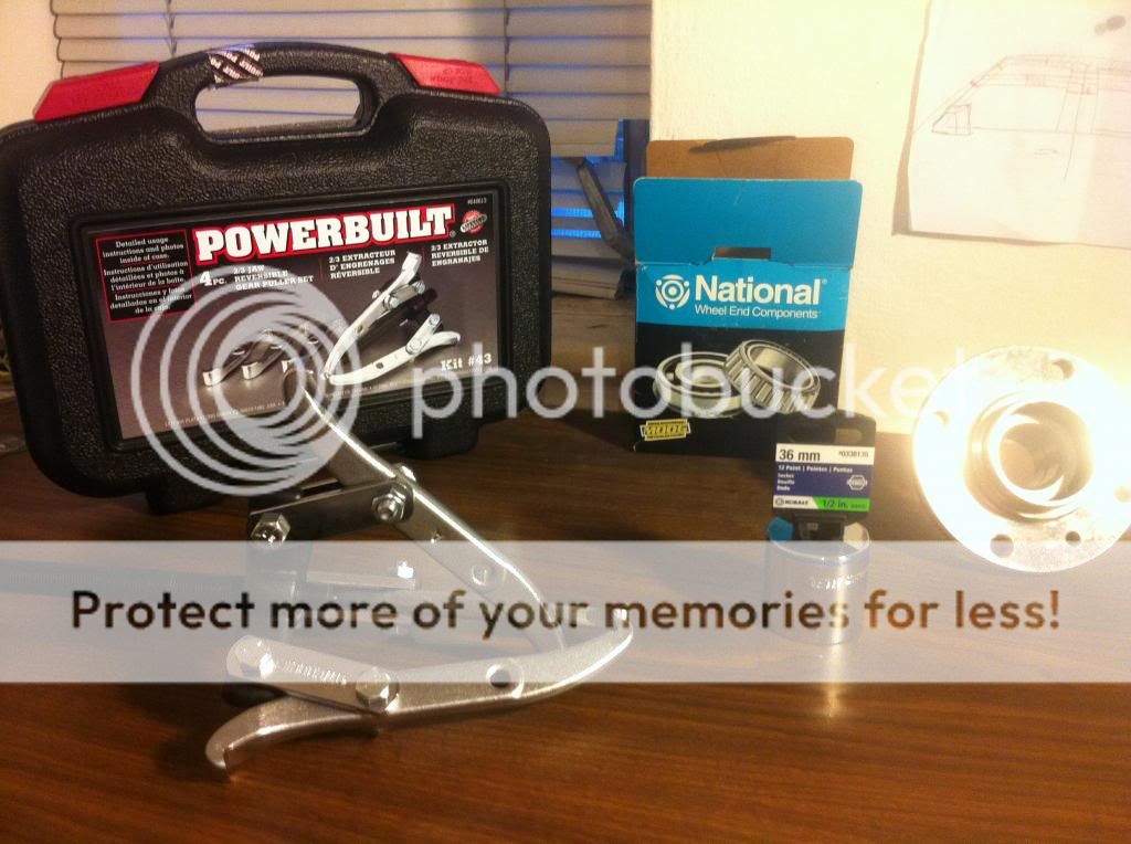

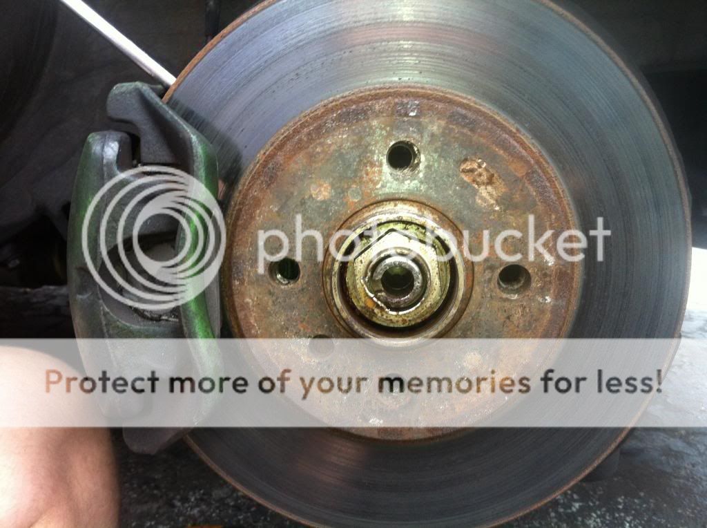

                            Started on the wheel bearing in the parking lot. Still waiting on the spindle nut to finish it, but that should be here Thursday. Then I can drive to the junkyard to get a "new" drive axel to replace mine. The boot tore a few months ago & I just let it go. So of course it filled with grease and dirt and now the CV joint is bad, but that's another story. Thankfully it's a quick item to change lol. On to the pics!
                            Quick overview of the special stuff I had to get. 36mm thin wall socket, 3 jaw puller, replacement Moog bearing.
                            The beginning:

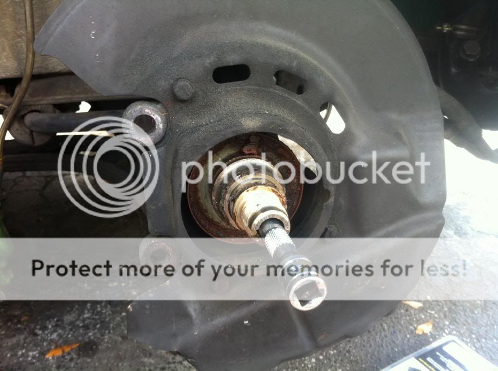

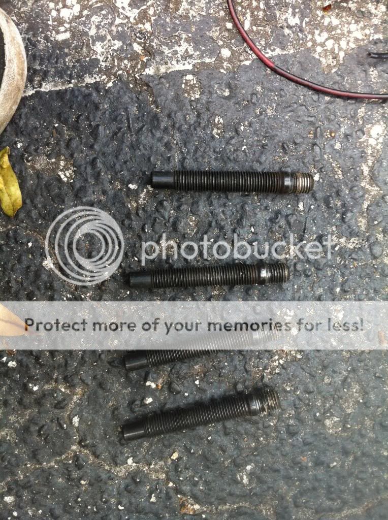

                            Studs out! Need to grab some loctite for when I re-install them. Also punched out the crush section of the spindle nut with a hammer & flat head.
                            Rotor & spindle nut off

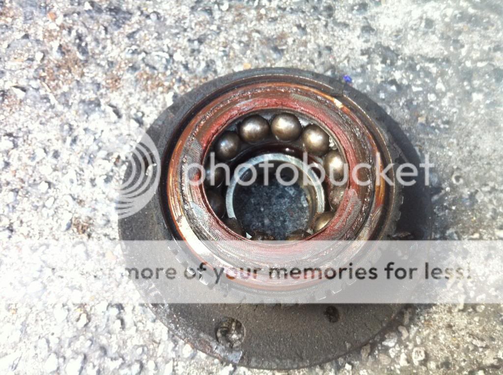

                            A peek inside of a noisy, old wheel bearing

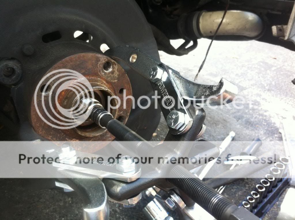

                            Test fitted the puller a few times. The threaded rod kept trying to thread into the spindle:evil:
                            Here was my solution. A 3 inch 3/8'' extension
                            It's off:ohsnap:

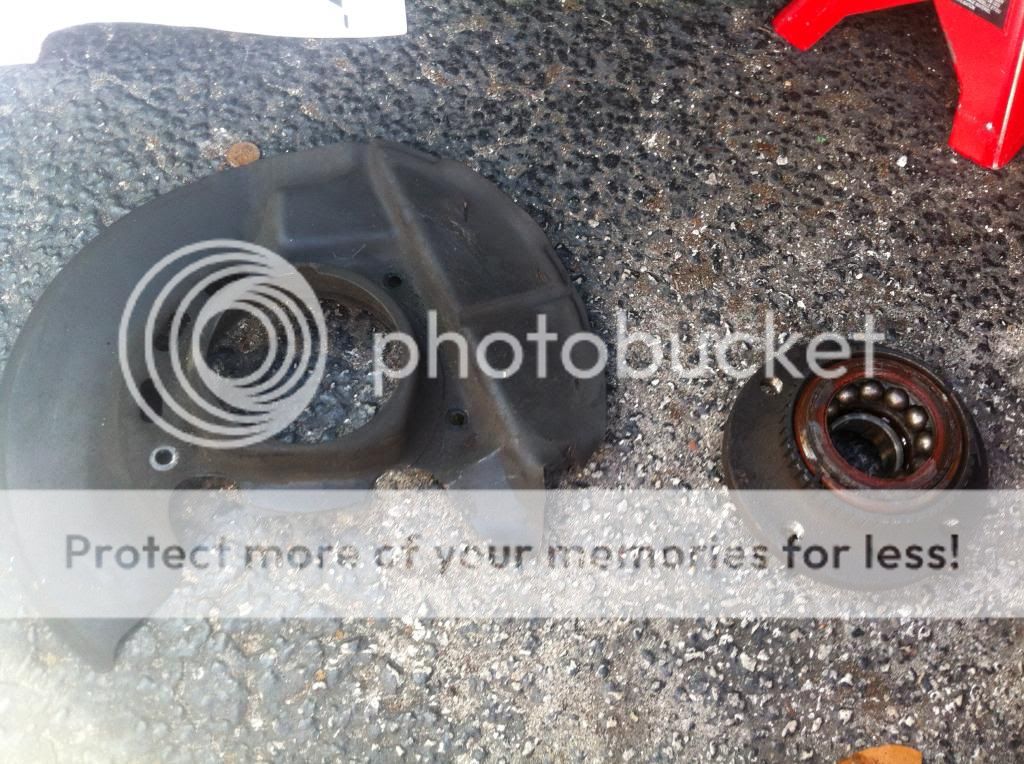

                            Pics of the old beast
                            Took the brake dust shields off. Still had to get the inner grease cap off since I got a new one:p
                            Old parts! I'm planning on making some new fancy brake shields, so this guy will stay off;)
                            And here's all the old bearing stuff. The inner race got stuck on the spindle when I removed the bearing so I had to go back in for round II to get it off. Came out easy:D

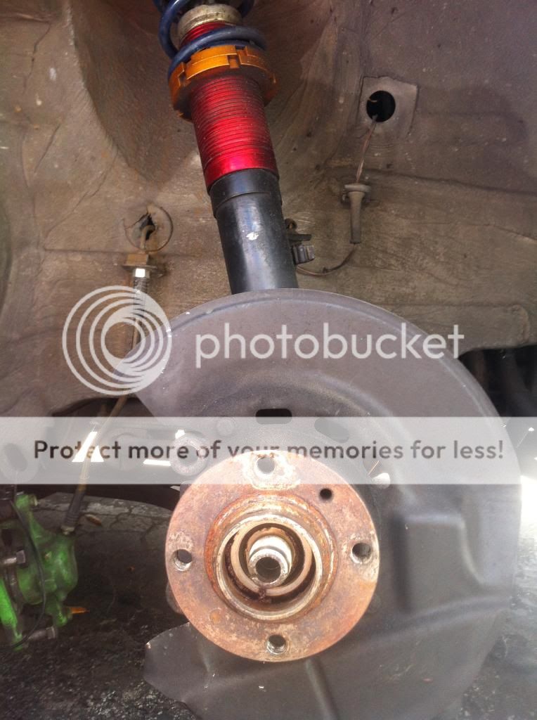

                            And the current state of things
                            Yes, I know my ball joints are shot. I have new ones ready to go in once I get a ball joint puller.
