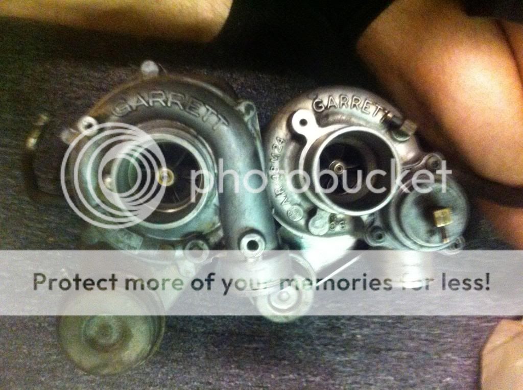

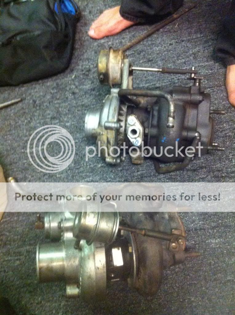

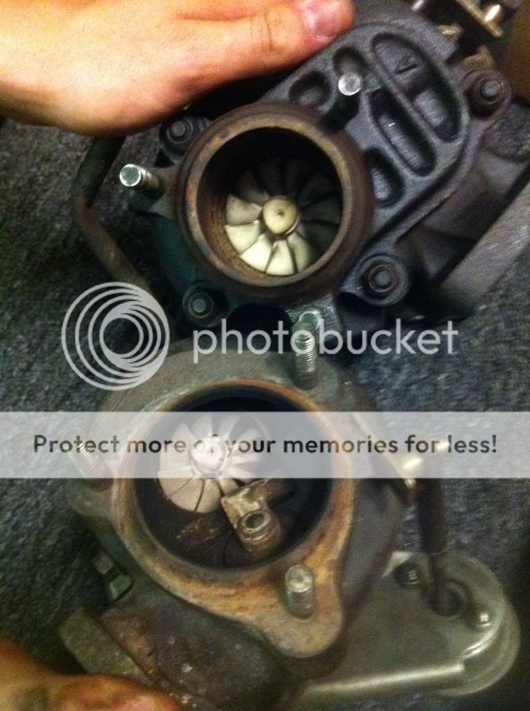

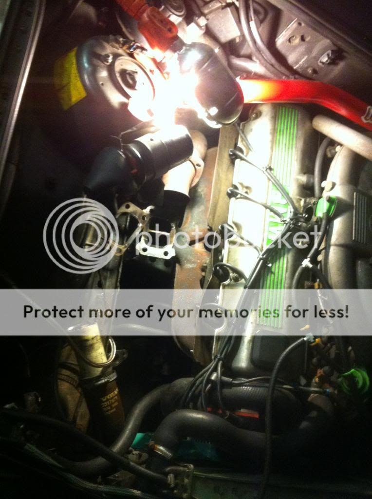

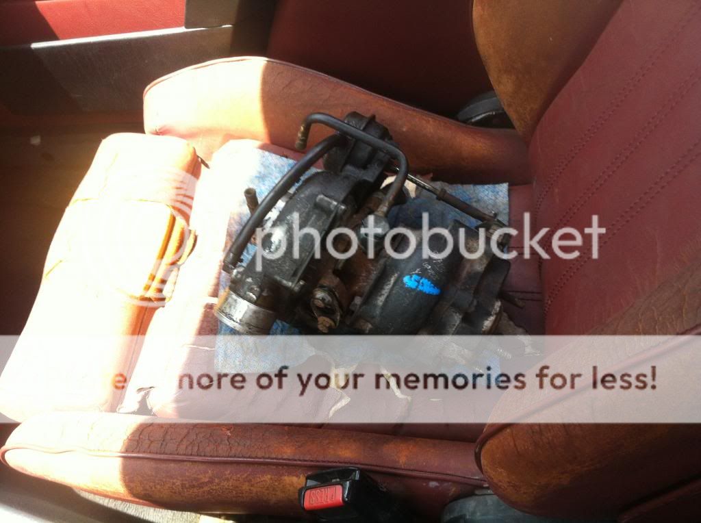

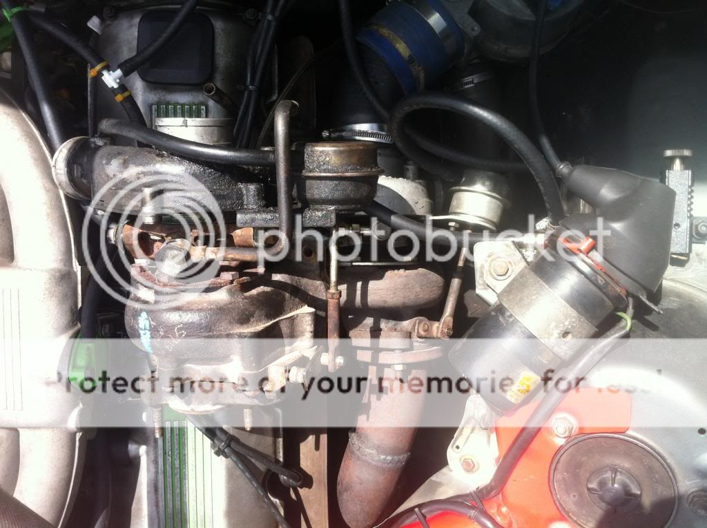

      Ended up snagging a bigger TB03 turbo at the junkyard as soon as school got out for spring. Put it all back together to have the 3" exhaust be about an inch too long at the top of the downpipe
      So I'm back to the 2 foot dump tube straight to the ground. It's so LOUD. I forgot how much quieter the straight pipes made it. I had to go back to school for summer though before I had a chance to get the 3" set up welded Onto the pics!
      Cleaned it up a little. Old vs New

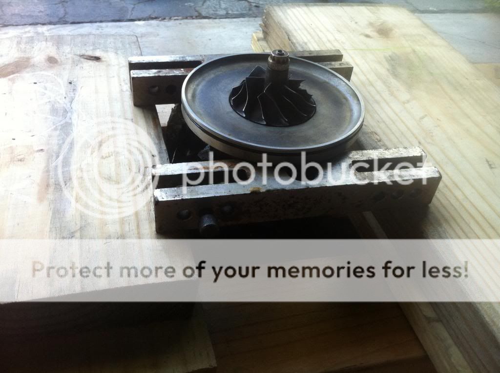

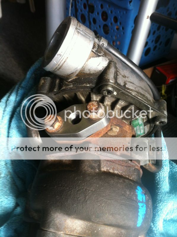

      Had to clock the CHRA to relocate the oil feed and drain.

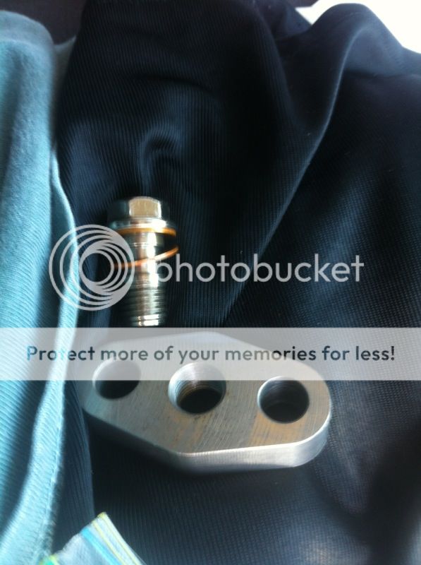

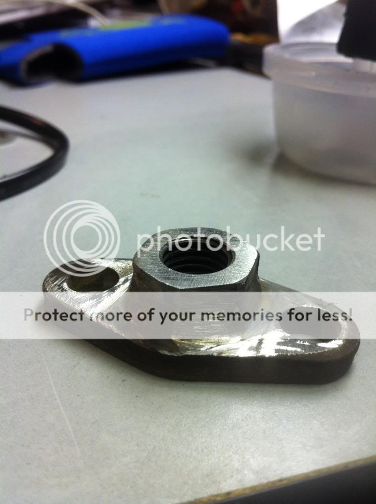

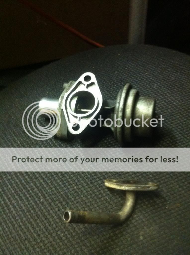

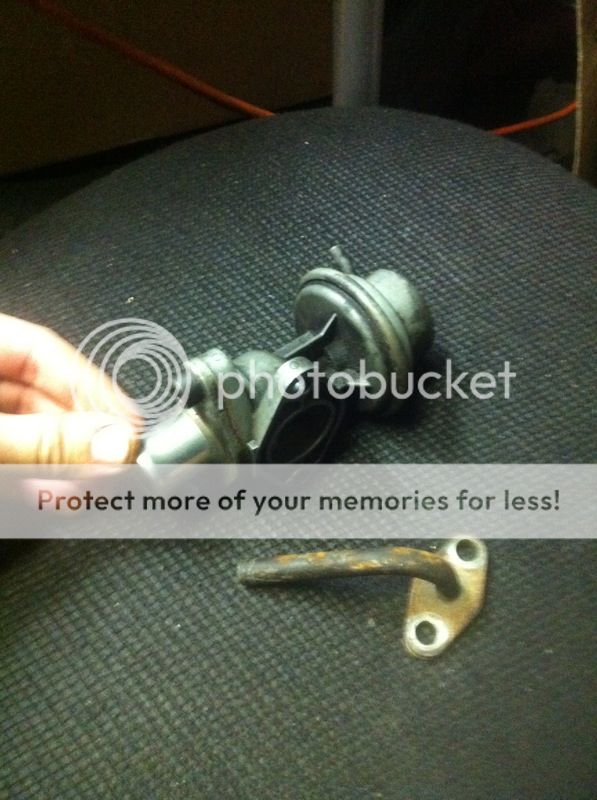

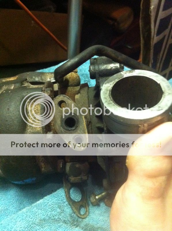

      Due to it being a different type of turbo it had a different oil feed size. Just my luck:p At first I bought this flange from speed & truck world and was going to drill and tap it to retain the feed line I already had to cut down on spending.
      The bold ended up being 1mm too small so I would need to add material to the flange rather than remove it. So I returned the flange and returned to the junkyard!
      From there I went and matched up a nut to the oil feed banjo bolt at Broward Bolt & bought it. Then my friend welded it to the factory flange after it was drilled out and flattened on a belt sander.

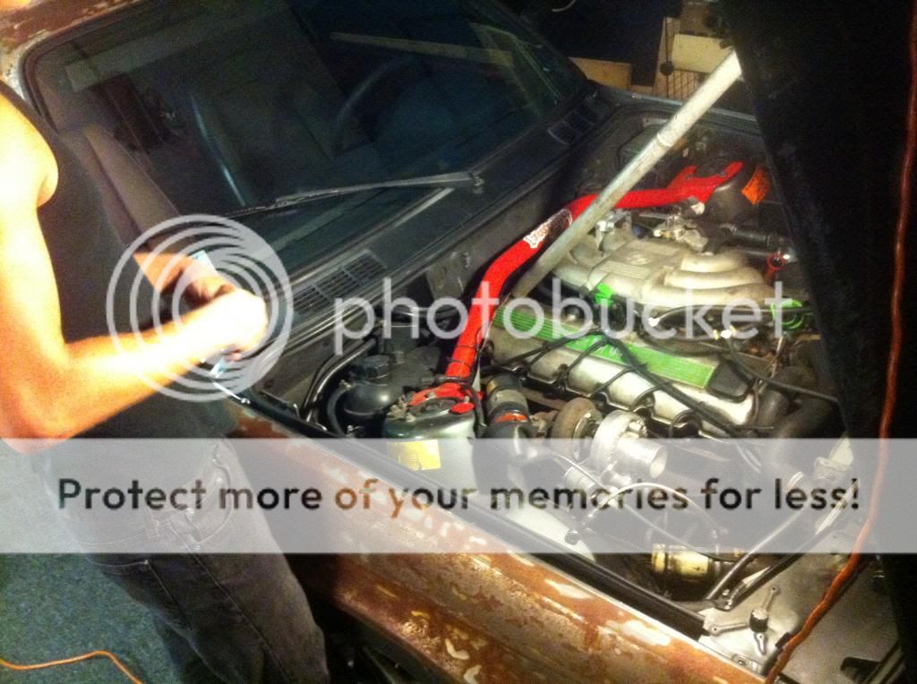

      Removed the turbo
      Also managed to run the water lines to the turbo.

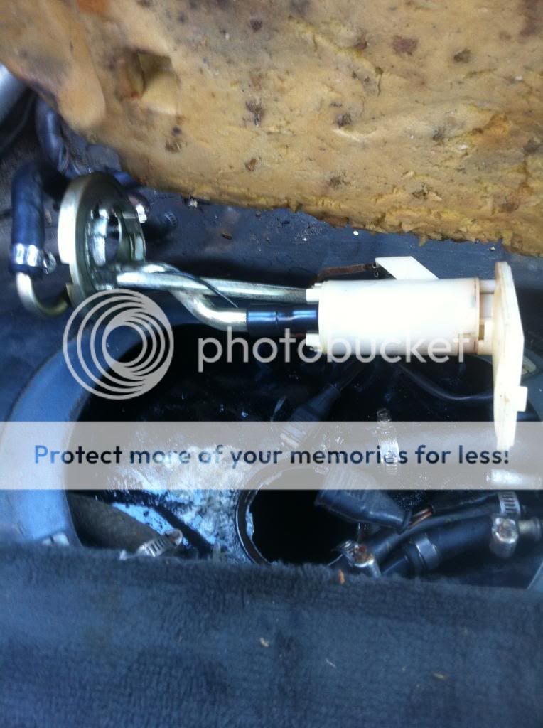

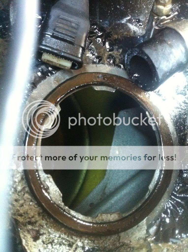

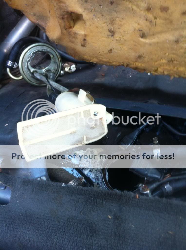

      Then almost didn't make it back up to Gainesville, the car was getting lean spikes until it was cutting out half the time. Made it though and later discovered it was the fuel pump relay. Replaced it with the O2 relay and it's good to go.
      Before I found out it was the relay I suspected the fuel pump itself. So i removed it to run some tests and the tank looks like it's holding up great! I would definitely recommend the POR 15 gas tank sealer to anyone who might need it.

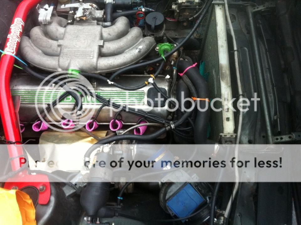

                So these came in the mail
                The new BIGGER turbo running MORE boost is so much fun
