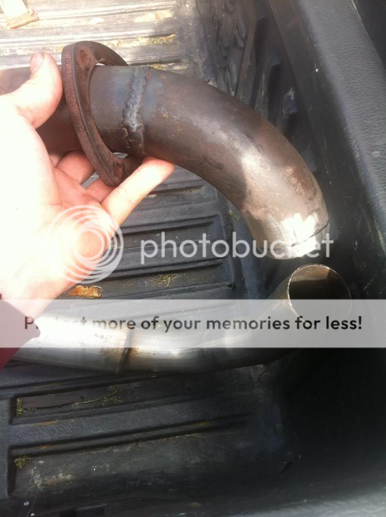

                              The 3" is back on:D Tucked up closer to the body than ever.
                              Also found a picture on IG.

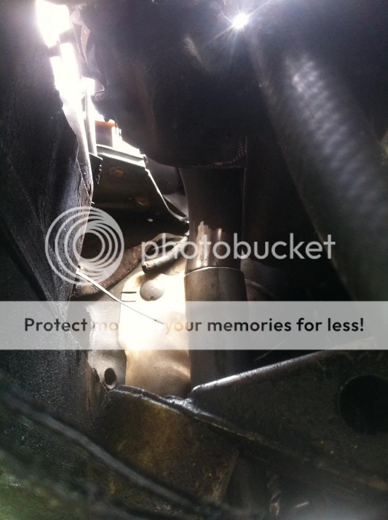

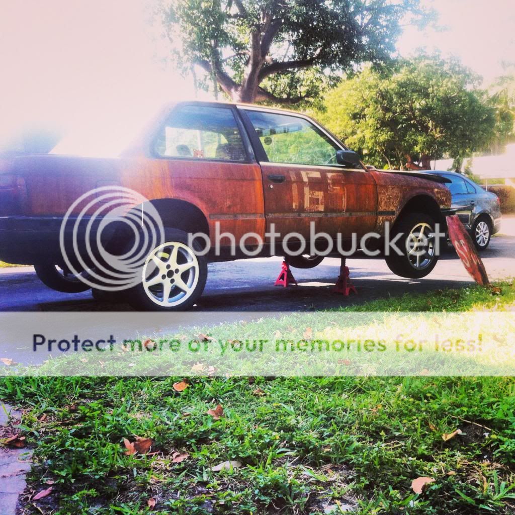

                              Wish I saved the regular version of this picture but sadly can't find it Had the car up off the ground to start chopping the downpipe up. It needed to come closer to the underside of the car as well as be tweaked a little bit to fit the new turbo.

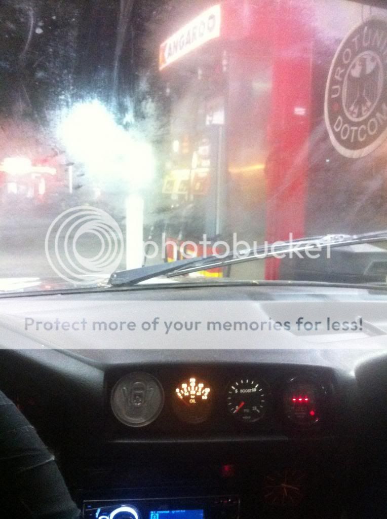

                              Replaced the blue LED in the boost gauge with an incandescent. Am looking for an amber replacement though as the color is a little off.

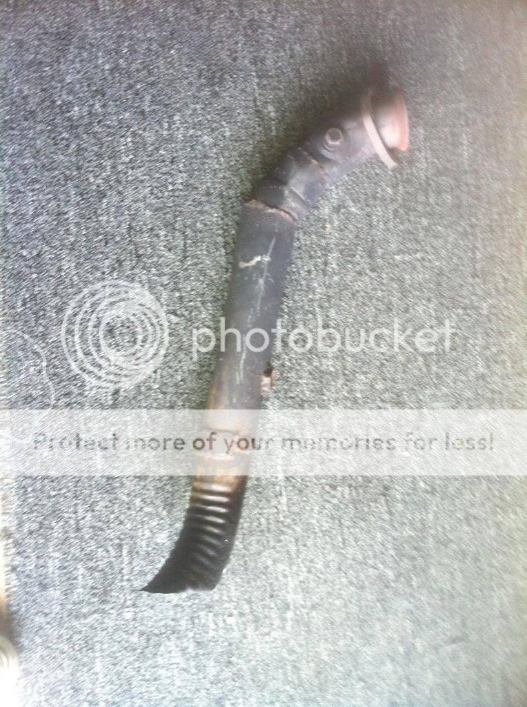

                              Then dug this out from underneath some filing cabinets that were outside. I have had this thing for who knows how long... probably at least 4 years.

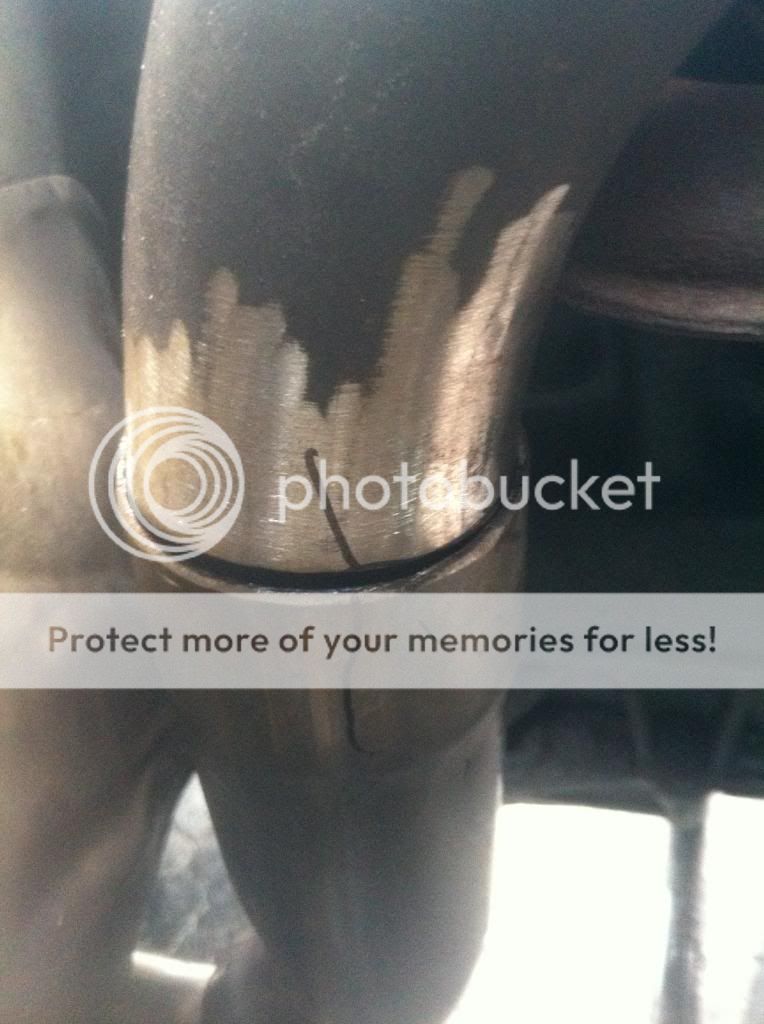

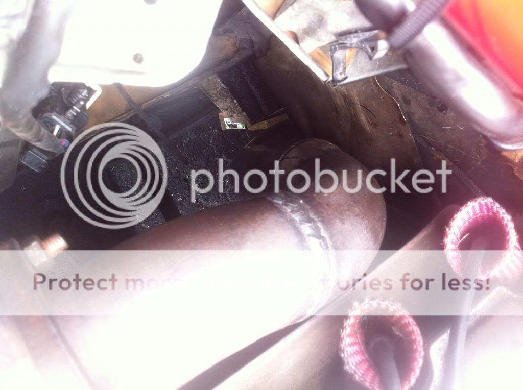

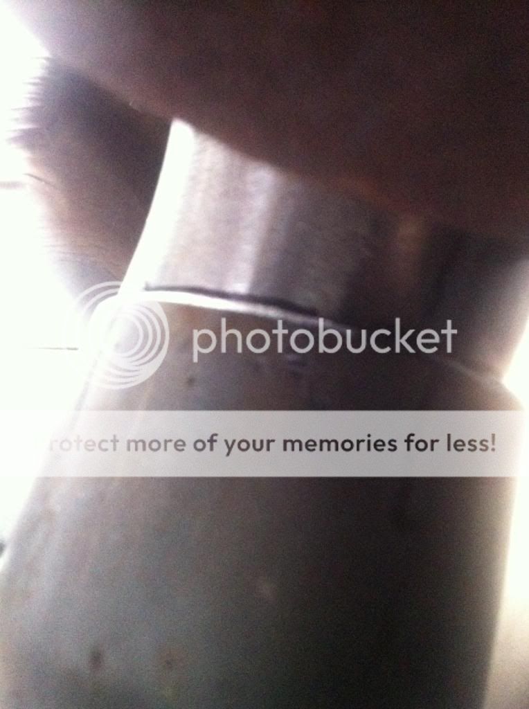

                              Better views of how I cut the downpipe to fit.
                              Here is the line I marked to weld. The small section below the sharpie line fits into the other pipe. The people that had originally welded this up for me had used a 2.5" piece they flared a little to fit another 2.5" piece of pipe into. I basically cut the weld out on either side with a cutting wheel and but did not fully cut through the downpipe inside the flare. Then all I had to do was knock the little section of downpipe in the flared pipe out and I was ready to mock up with the sharpie.

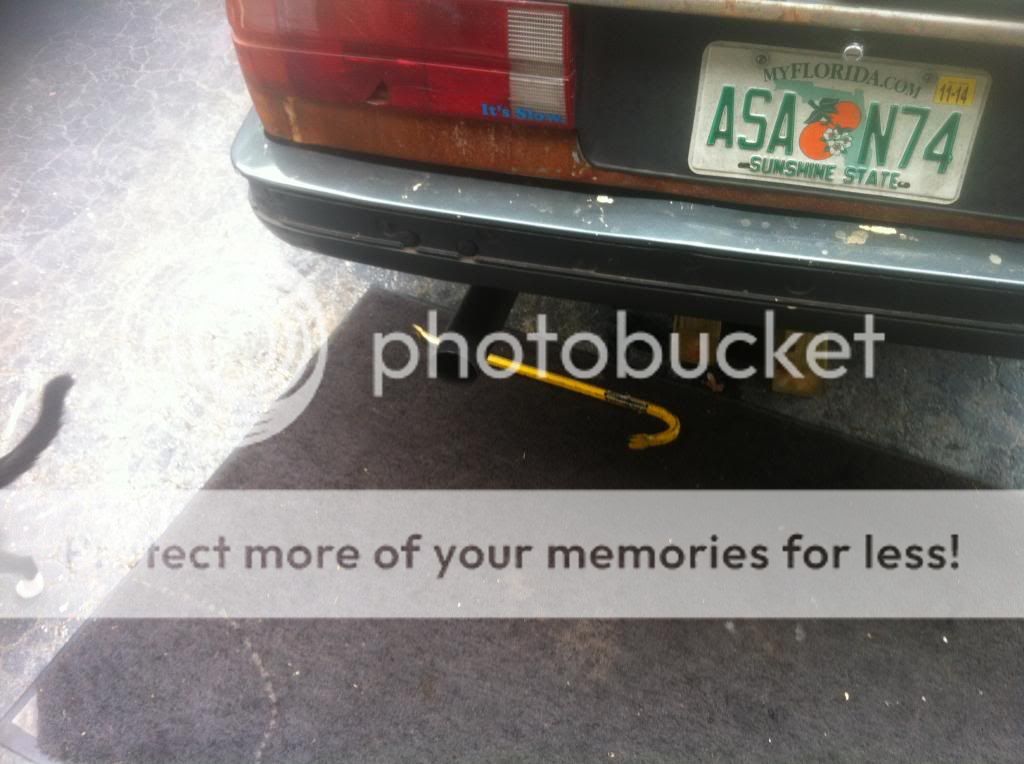

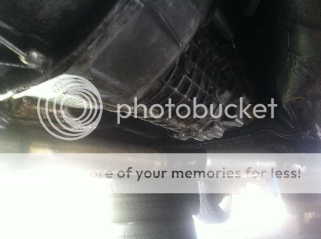

                              High up away from the ground

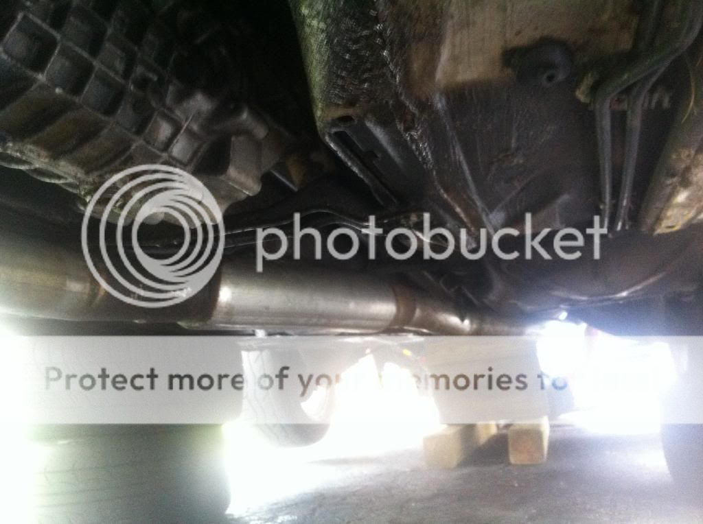

                              In the end it was all done to replace this, my entire exhaust system for the past few months
                              A little long in the back, but it sits even with the edge of the plastic bumper. It shouldn't burn any paint like that:p
