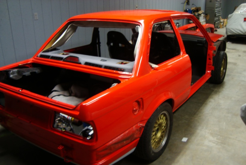

          Well it looks like I'm not going to be able to take it to school, but just as well i guess as I will really take my time putting it together. It's taking him longer than expected and I should have the car and parts back by tomorrow.

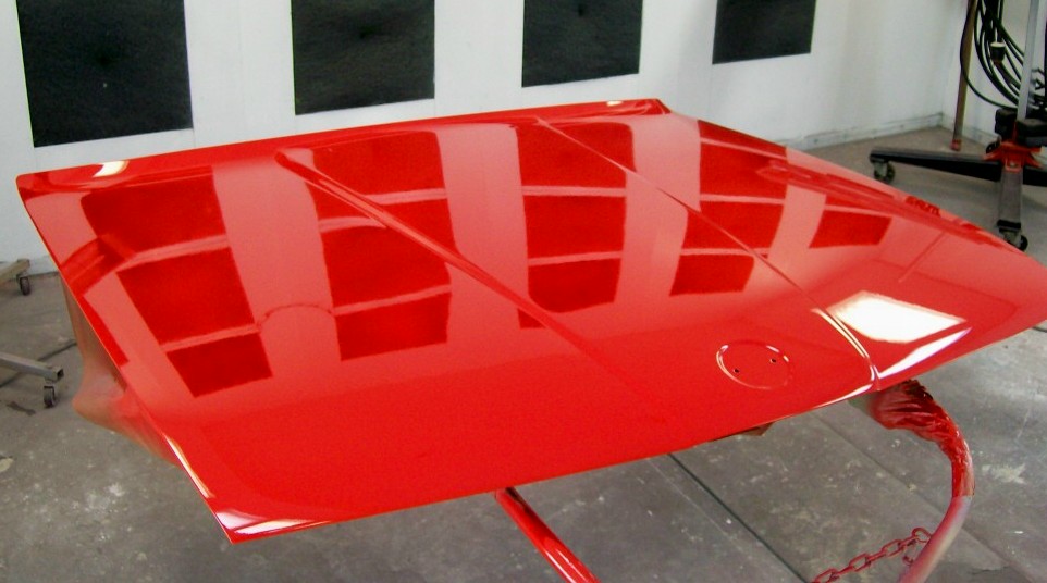

            pic of the hood! I am anxious to see the actual color, red is so hard to photograph. Its painted mugello red. It is a really rare bmw color that came on some e34 m5's and some 95 m3's.

              That looks beautiful man, can't wait to see the rest of the car.

                I like the color, a lot actually.

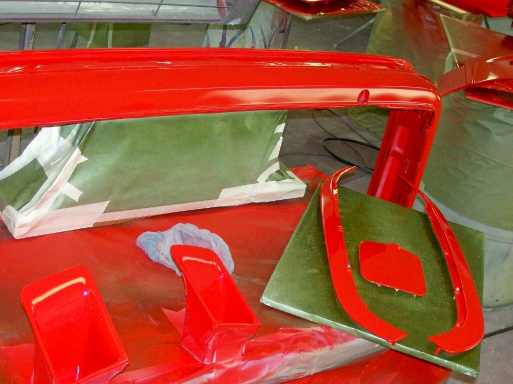

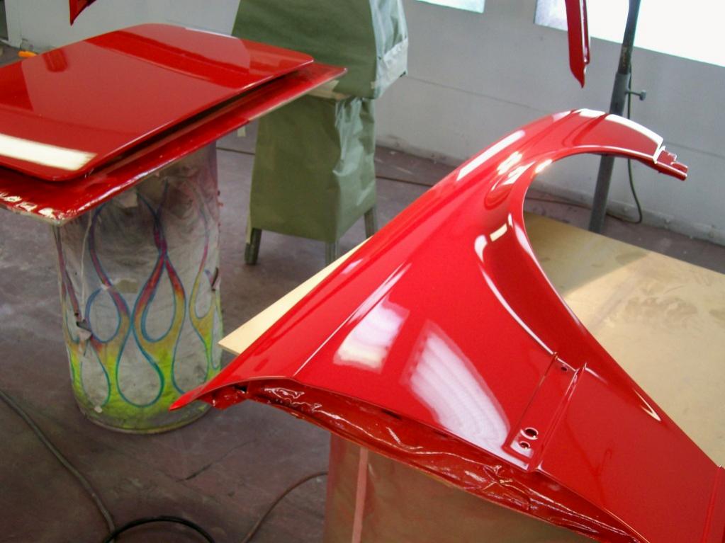

                      well, he ended up needing more paint so its not going to be all done till tomorrow. He has all of the parts painted, just the unibody to go. Cant wait to see it in person, this picture quality sucks!!!

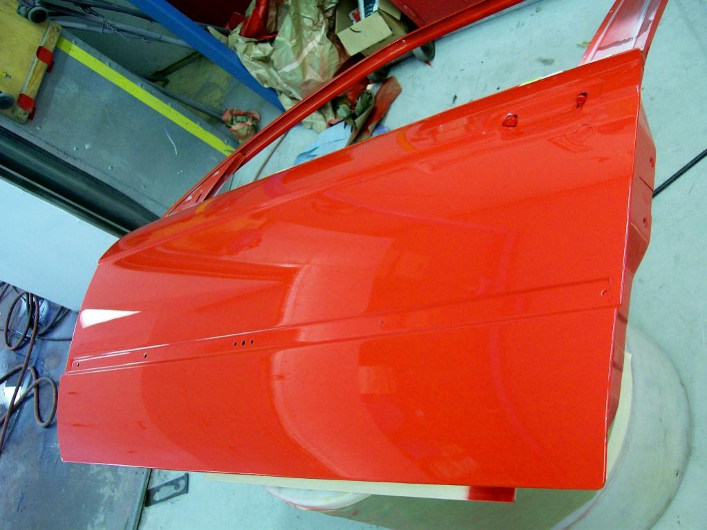

                        he sent me a picture of a door out in the shop, god i love this color!!!

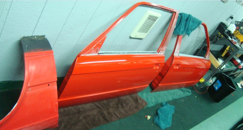

                          The doors, next to one of the old fenders thats seen better days
