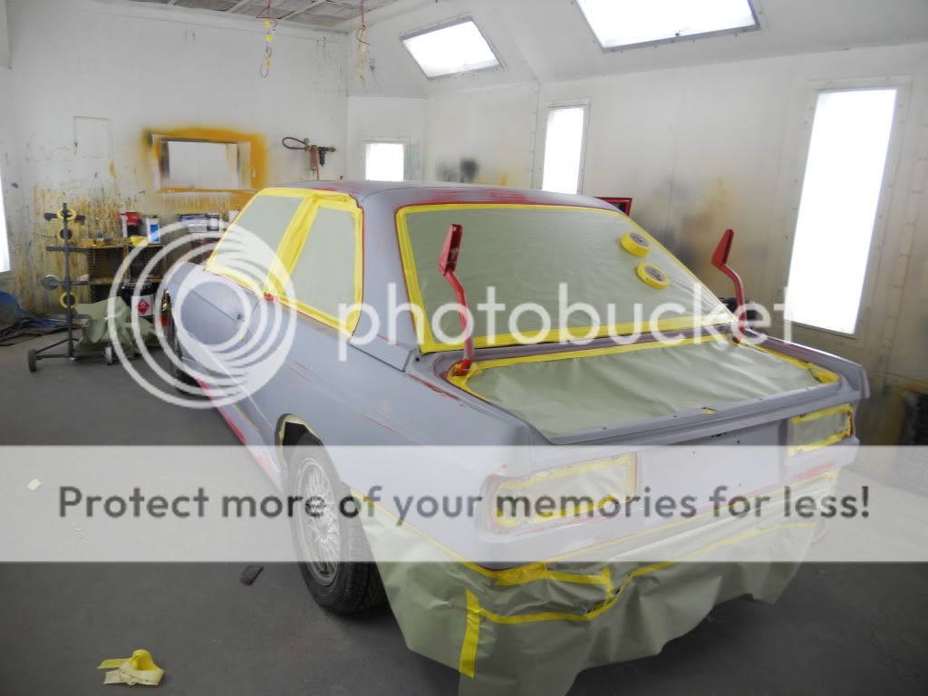

      ok here is the Henna paint code 052 and mix..also use 400 grit sand paper and then prime..
      DMD1608 LF ORANGE
      DMD1677 RED
      DMD648 WEAK BLACK
      DMD1684 WHITE
      DMD665 YELLOW RF
      DBX1689 CLEAR
      for the reducer use a I think its DTC 885 which is medium temp reducer or you can go DTC 895 which is a lil slower..
      The clear is DC3000 and hardner is DCH 3095 its a 4-1 mix ratio.
      Good luck..

            how is coming along with the DIY paint project..
