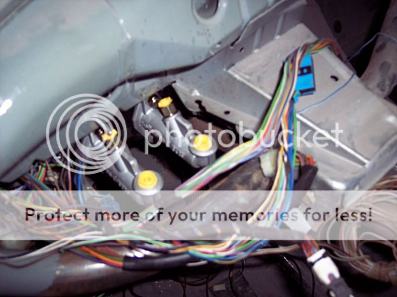

    Decent sized update today, but it's more parts arriving, than work being done, but hey, it's progress! I got my master cylinders(yes, plural, there's 3 of them) and my bias adjuster from Wilwood today. Picked up the coolant reservoir I'm using, it's from a Mercedes C280 and I started modifying the coolant crossover manifold, since I now know where the reservoir is going and I don't need the outlet for the heater core, since there won't be one, haha. Pics...
    3 Wilwood 5/8" bore MC's and the Wilwood proportioning valve
    2 shots of them mounted to the pedal assembly, for reference
    One from below
    And from above... the third one is just out of sight under the column support, to the right
    The coolant reservoir I've decided to use
    And the crossover manifold mods... still need to TIG the nipple to the other side and TIG the holes up... just to clarify the pictures... the inlet nipple used to be on the left and I'm moving it to the right where I'm holding it up in the second picture, since the reservoir is going on that side. The original hole and the center hole will get TIG'ed shut
    I should get my stainless lines tomorrow, which means I can do some brake system work over the weekend and my new light connectors should be here any day also, so I can forge ahead with the harness, too...
