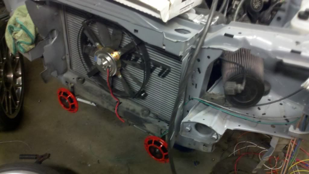

      Some more wiring today, and made the executive decision that I will sacrifice my horns by mounting them in the easiest place..where the oil cooler brackets screwed in. It will be loud up front but susceptible to rocks and things behind the valence vents.

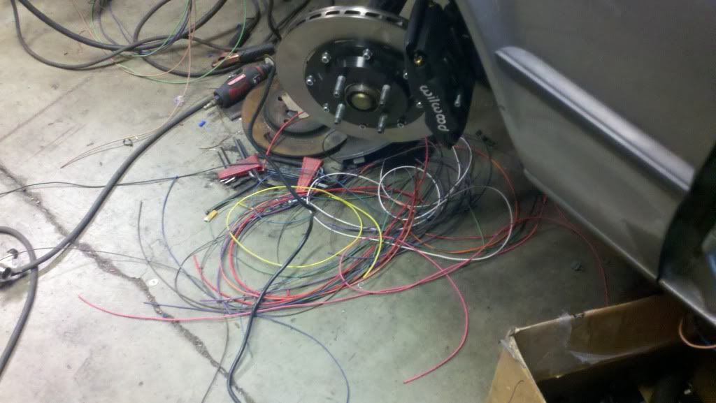

      Lots of wire on the floor from scraps, what I've cut off so far.

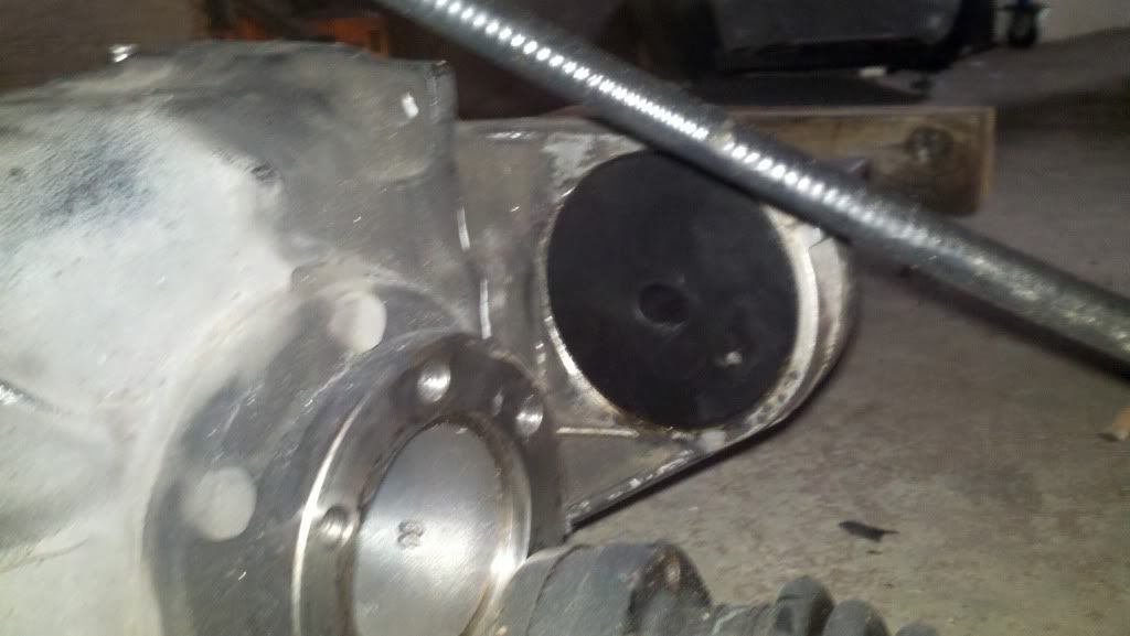

      Delrin diff bushing from turner
      About to get the arms installed..and..
      Doh! Grinding time. I have since got it clearanced just enough to take out and reinstall (harder). It took some creative prying wiggling and tapping to get back in, but its installed. Now for the other side.

        Its not the prettiest ever but "just enough" with fast removal of material with a cut off wheel. It will never be seen anyway and it did not compromise the perimeter of the top cap. Whatever, it works. I still need to do the other side, but here's the pic of what I said I did...

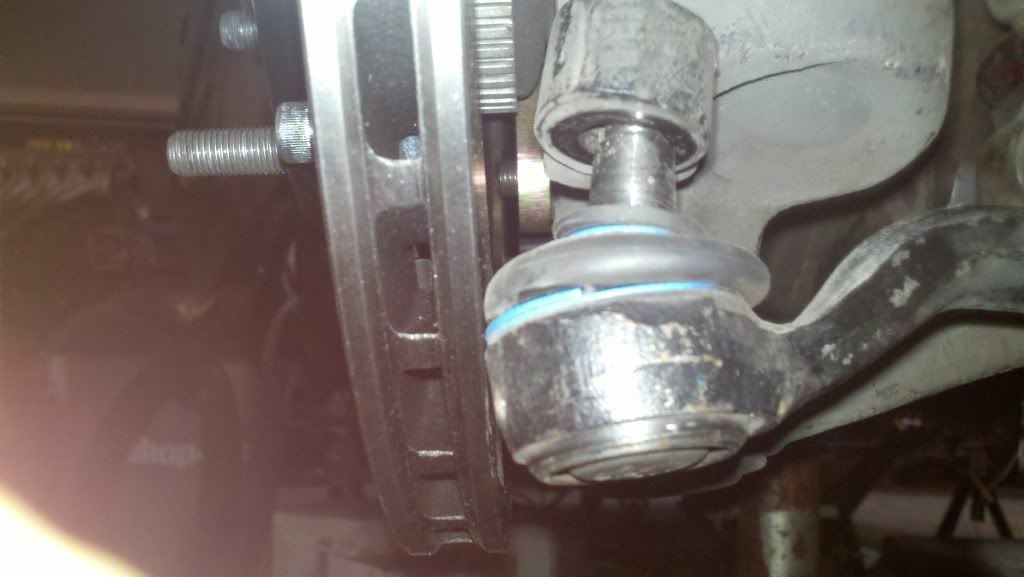

            Some notes, um .. Couldn't find the new meyle tie rods I had. Looked at the rubber boot on the ones ive got that are just a hair too fat, and right there, "meyle" !! Doh, those ARE e30 pieces! Grabbed my old original rack from my vert with lemfoerder(sp?) ends and they appear to be a little less on diameter of the cast and rubber boot. Just a hair. I hope so, because that's what I have coming to replace them.

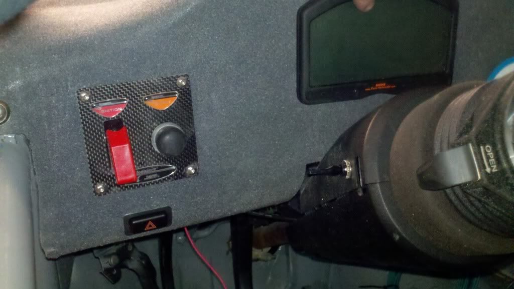

                Looking into the wiring for the switches and hazard flashers, its a puzzle for sure. The painless harness gives me a turn signal positive wire, and a hazard positive wire. The turns are easy enough to figure out with my DPDT temporary switch, positive to the two common middle switches and both right or left lights (F+R) to their respective "on" sides. One + wire in, and jumped, then 4 outputs.
                The hazard switch is a little more complicated. Figuring I will make use of the stock hazard switch for simplicity of finding a switch that will keep all four turn outputs isolated until one switch contacts all four together with the positive emergency flasher wire.
                Looking into the etm on the hazard switch internals, it APPEARS that I can use pin 3 (usually hot all times, hazard positive) connected to the hazard + wire. For the 4 outputs to the signals, they will go on pins 2 4 6 and 8; the switched outputs on the other side of +In of the light inside. Pin 5 doesnt go through the light, but connects to pin3 when on. Idk if ill have to, but may jump past the internal lamp after I try it. If so, I could put a 12v lamp on pin 5 that will light up when the switch is on.

                  Ok, got the dpdt temporary on blinker switch wired up, complete with flying leads that i will be connecting to the hazard switch as soon as I get it here. Same for the wiper motor, I jyst need the plug. I will most likely will mount the hazard switch below the ignition switch panel.
                  I might add a short stick on the end of the switch to make it easier to get at, but still out of the way.

                        Went to pick n pull today for some parts, including a new battery cable and got that installed. I also got the lemfoerder rods on and daaayyuum they are close, but clear by maybe the thickness of a credit card. The rubber boot is closer, but still has air gap. I wonder how long these will last with the heat :) Oi.. I also brought the front valence down that I am glad never made it on my vert..
