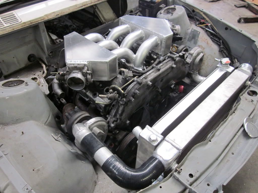

    Done some shiz on this thing after a bit of a break.

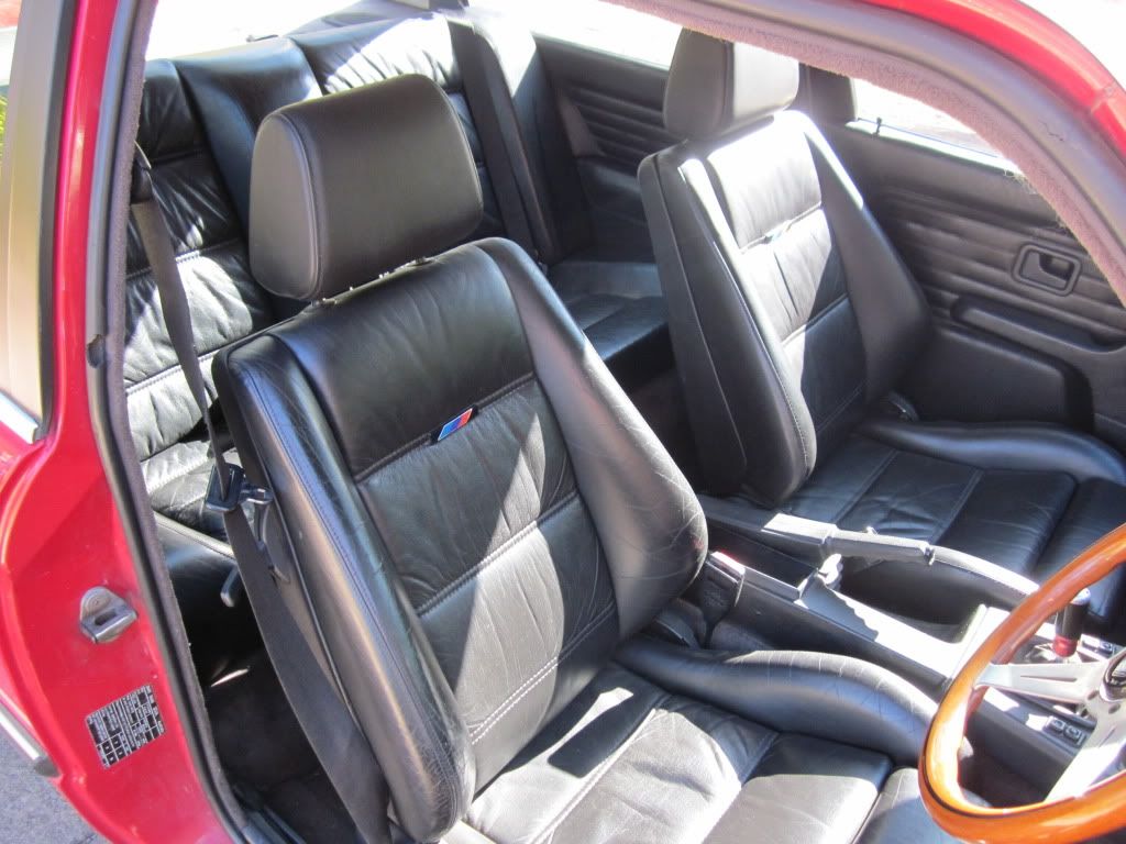

    Bought and fitted an M3 Leather interior. Is nice.

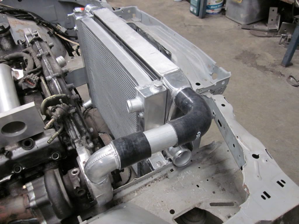

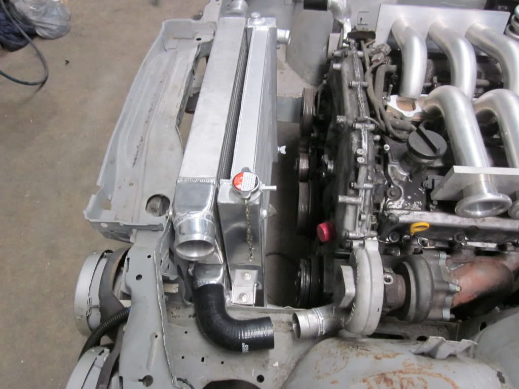

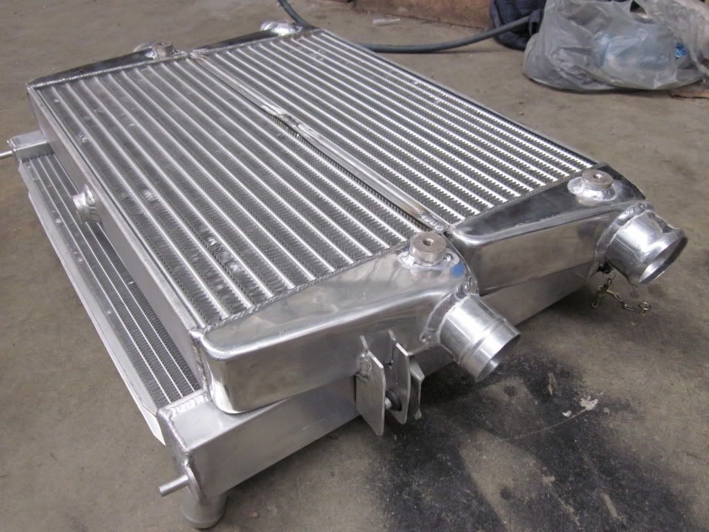

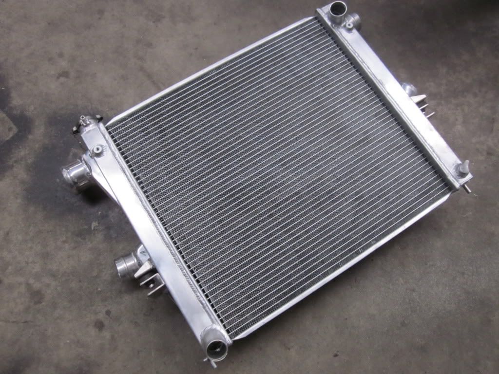

    And did some more work on the intercooler and radiator.
    Mounted the intercooler to the body and soft mounted the radiator to the intercooler.
    Also changed all 4 intercooler outlets to get the correct sizes and direction.
    Welded 90's onto the compressor housing also. This side will have to have the gay joiner.
    This side I will extend the comp outlet so a 90 silicone will be the only joiner.

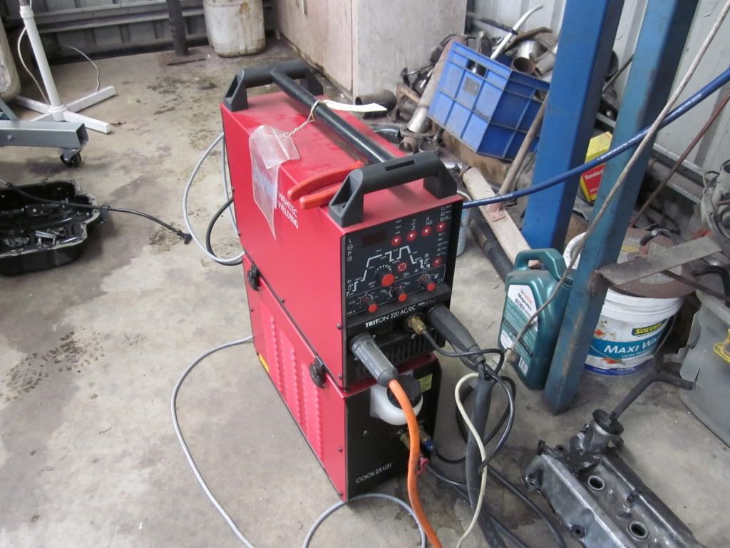

      Done a bit on the manifold while we are quiet at work. New welder being a fag didn't help but came out ok so far.

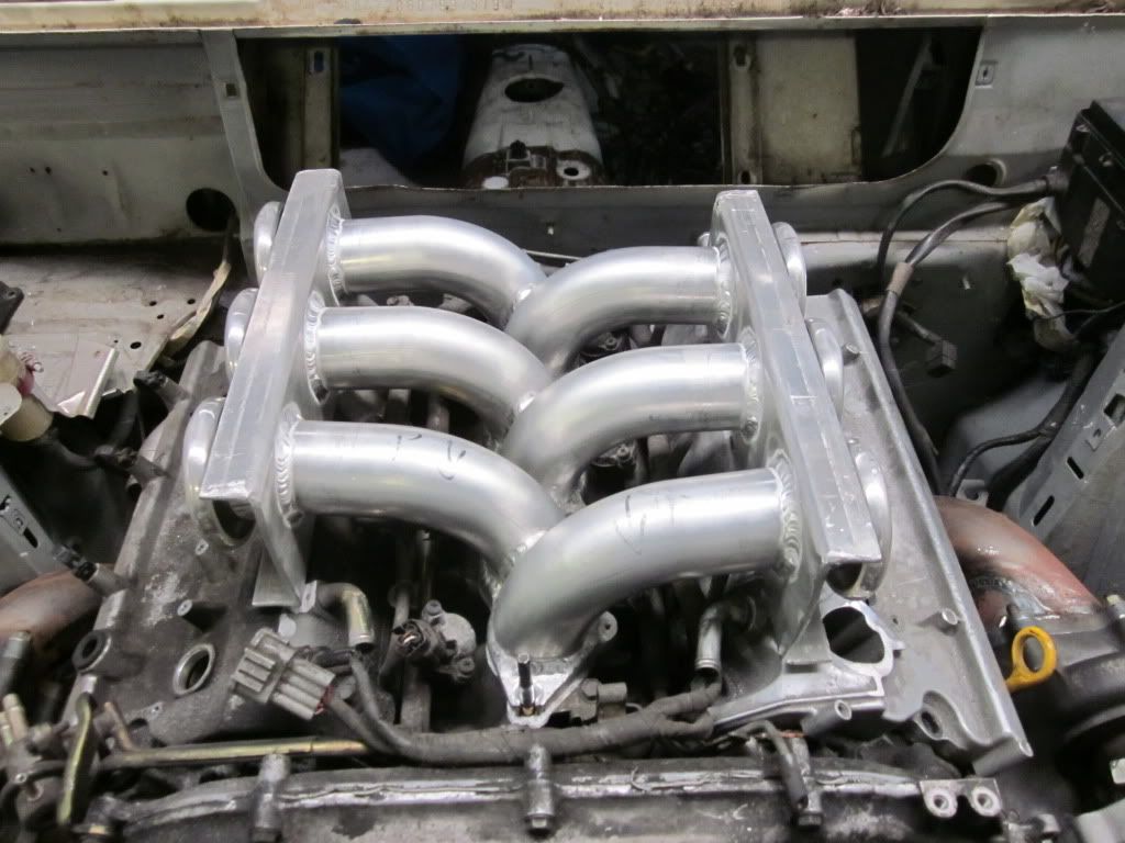

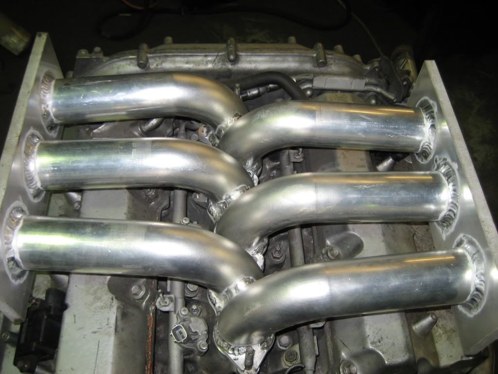

          Lots of hours on the torch yesterday and this morning and I have a manifold that fits under the bonnet. Yay. Spent the last week shortening and modifying the runners and plenums because of a severe lack of bonnet height.
          Runners and backing plates.
          Internal welding of plenum.
          Throttle body flanges on.
          Blast it all up with this bad boy.
          Done(except for lots of fittings and crap and a balance pipe.)
          Gotta work out the gear shifter now.

            Welds look GOOD
            preheating the parts?
            Cant wait to see this thing finished, im sure mad skids will de done
