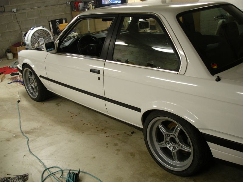

                      Dropped her down on the ground for the first time in a while. Played with ride height for a bit then bled the cooling system. Maiden voyage tonight or tomorrow!
                      013-3 by Bob Cooper, on Flickr

                          Tire size? I did mine in the same color, can you give us a perpendicular shot to the side. Never mind I could make 215-40 on the other shot. Those run wide Didn't think Kumho MX ran that wide.
                          I have some 215-40's on 17x8 and they are silly stretched hate em.

                            Just curious, the GC setup you have doesn't have adjustable camber right?

                              Yeah, the MX's run wide that's why I ordered the 215's. They look just right on 17x8.
                              They actually do. Hopefully they are quieter than my old camber plates.

                                Those wheels look fantastic. That color provides just enough contrast from the paint.
