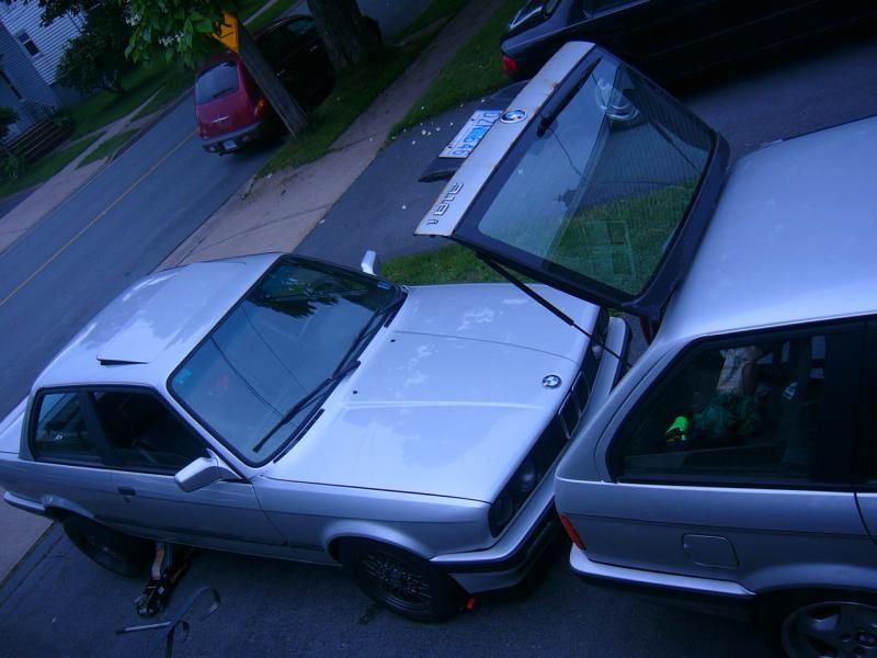

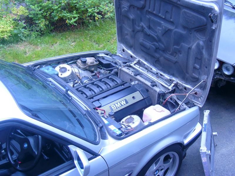

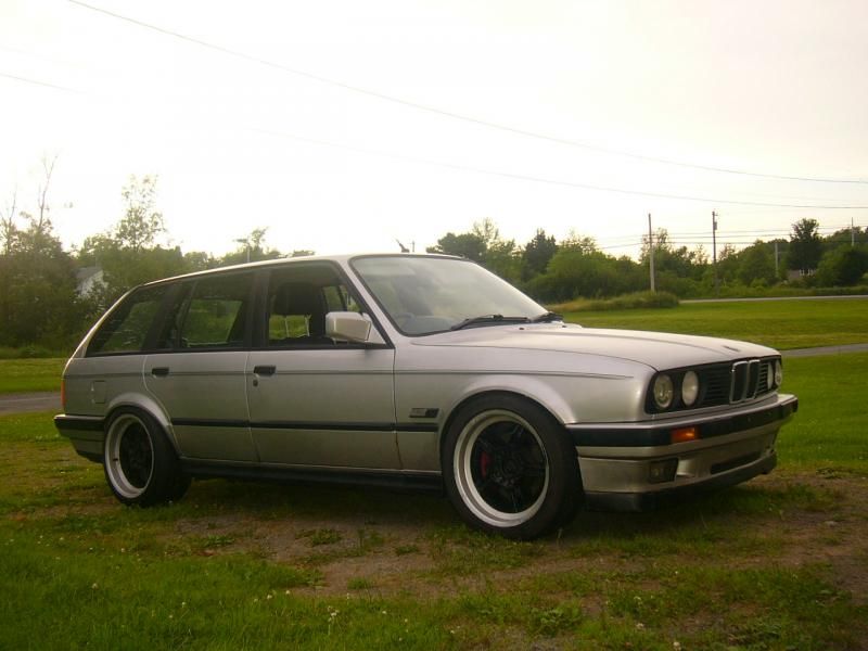

              Dear God it's been almost two years since I updated this. Crazy how much has changed. Here's a pic from last week.
              And from yesterday
              I'm not good with photography, deal with it. The main points:
              M50tu swap. What a PITA that was. Had to do it when the timing belt on the M40 broke. Work space was an hours drive away and I had no car in the mean time. I ran into more than my fair share of problems doing the job and it took like a month of weekends. After a year later I'm just now starting to think it was worth it.

              Staggered M-Systems 17x8 front and 17x9 rears, 225/45R17's all around.

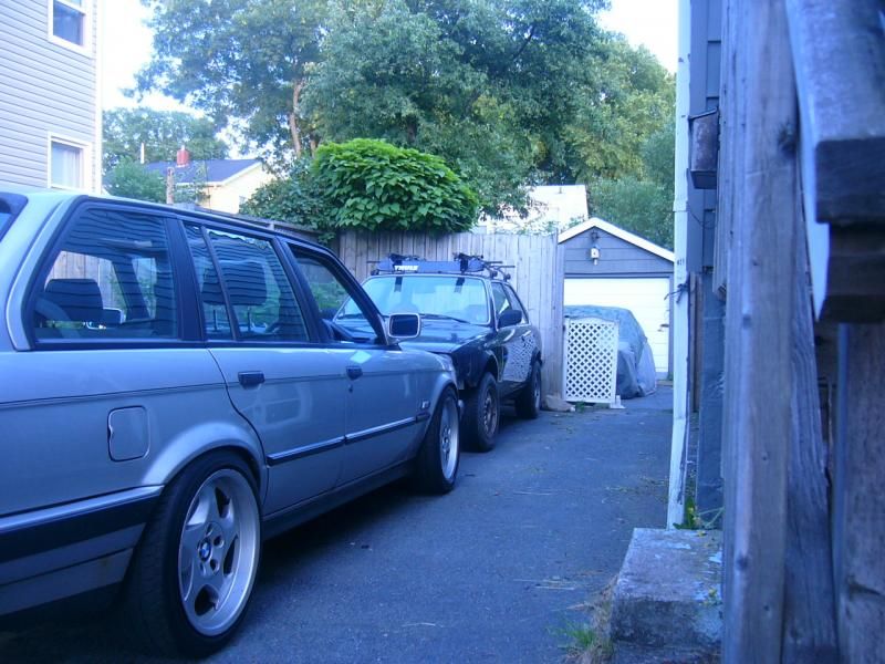

              BIG thanks to Blunttech and especially to Terry (username Northern) for helping me do the clutch line and a new master cylinder in the pouring rain and for letting me camp out in his spare bedroom when my GF broke up with me and kicked me out. You can see his weirdo model iX in one of the pics above.

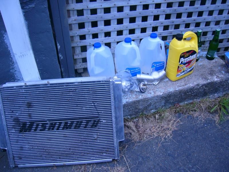

                          Plans for this weekend are to install new aluminum thermostat housing, 80degree m20 thermostat, new water pump and used m20 Mishimoto radiator. Also going to clean up the wiring for the electric fan that I had to completely add in. This car had no fuses or relays for an aux. fan as it was a 4 cylinder without a/c. I added in a relay, jumped power from one 7.5 amp fuse and one 30 amp and used an e36 318i temp sender in the rad. Comes on right at half way and turns off at about 3/8ths. The wiring looks ugly right now but it's better than just having the fan run constant off of the ignition.

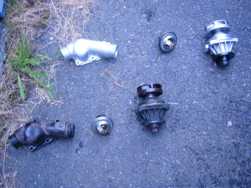

                              Did most of the cooling system re do last night until (and a little after) it got dark.
                              Getting started
                              My room mate (Northern) working on his e brakes
                              (Mostly) new cooling system parts and needed suplies

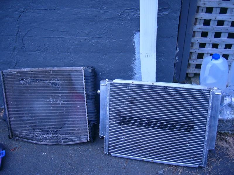

                              Old rad (don't ask) vs. not so old rad
                              All the old stuff off vs the new stuff

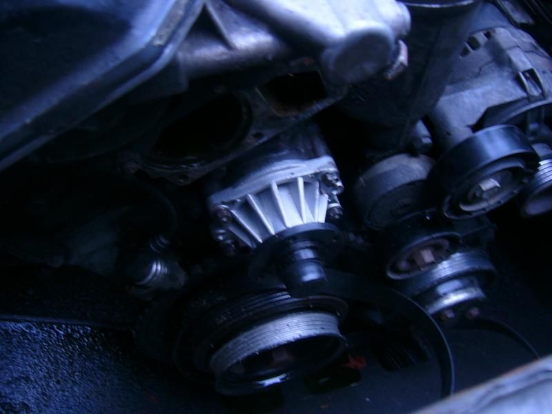

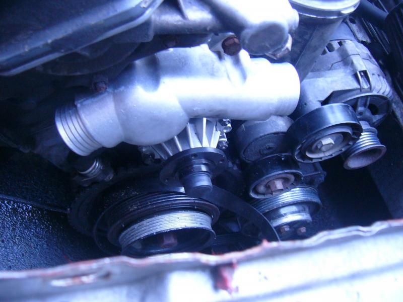

                              New water pump on. I was prepared for the old one to be stuck on but a few whacks with the rubber mallet and it loosened up nicely and out she came, along with a river of coolant...
                              Yay! M20 80 degree thermostat installed behind an aluminum t stat housing and metal impeller water pump. That along with the mishimoto rad should alleviate the temperature creep I had been experiencing.
                              Installed the rad and hoses and bled the system last night. I'm just about to take it for a drive to see how well I did. Will post more underhood shots of the shiny radiator and maybe some shitty pics of nice things depending on how far into my little cruise I get.
