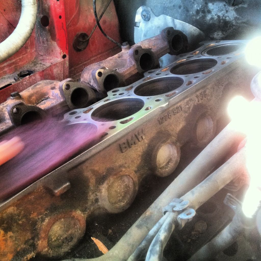

                    • Pantless Spency
                      It's McRib time!!!
                      • Feb 2011
                      • 7283
                      #220
                      its getting there...
                      • LJ851
                        • 7919
                        #221
                        Clean everything Really, Really, Really well after using a scotchbrite (silicon carbide) pad like that.
                        Lorin
                        The M30 is God's engine.

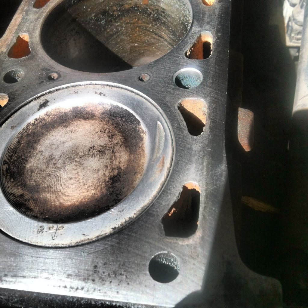

                        • Pantless Spency
                          It's McRib time!!!
                          • Feb 2011
                          • 7283
                          #222
                          oh yes. its in like every crevice hahaha i will be purchasing an air compressor and blow out everything.
                          if any is left behind it would score the shit out of the cylinder walls.
                          bad news if that happens haha.
                          • Pantless Spency
                            It's McRib time!!!
                            • Feb 2011
                            • 7283
                            #223
                            in this one you can some what see the residual fuzz from the scotchbrite.
                            • Massimo
                              • Jan 2008
                              • 3207
                              #224
                              I poured kerosen down the holes. With the oil pump and filter removed I then blew air down then seemed to removed all the crap.
                              • LittleBimmer
                                • Aug 2007
                                • 61
                                #225
                                do you feel it would of been cheaper and more effective to just pull the whole engine have the machine shop do the work your trying to do effortlessly and put new bearings in? when i had my twin turbo stealth 6g72 engine rebuilt it cost me 150 to hot tank the block <~~was sparkling clean 350 for two DOHC heads to be cleaned decked and new VSS installed, and 150 to turn the crank. assuming it would cost you less on the head since your only taking them one you would be looking at roughly $500 for engine machine work and another $400 assuming you use your old oil pump which i would not recommend. and reassemble everything yourself, patience and you can do it. but i understand its hard with a $400 bi weekly paying job with bills, lack of space to work and the wrong tools (no engine hoist)
                                good luck though, i am looking forward to seeing you make this engine start :)
