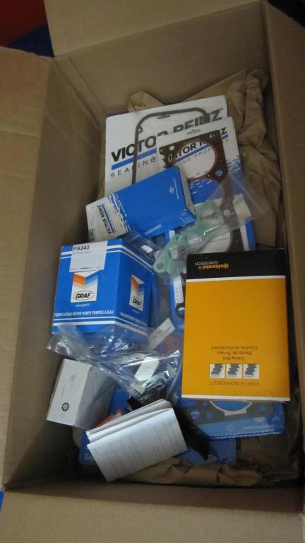

      just got this in the mail.....
      anyone in the bay area or sac area wanna give me a helping hand? I'm not quite the motor contisure yet :/ but hopefully i will be an m20 class Jedi after this 8)

        also just ordered:
        spark plugs :)
        brake pads
        throttle body gasket
        oil pan gasket :)
        and the gaskets for intake on cylinder 1,2 & 5 (i ordered one of these already, thought it was a set for all 4, only got one for cylinder 6 LOL)
