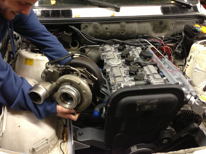

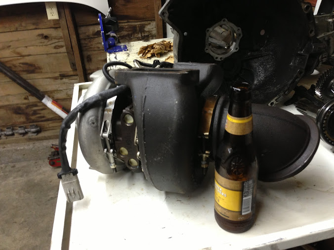

    The turbo is now mocked up at work on a spare motor, i will take the water pipe and motor mount there tommorow and bolt them on so i can use them for mock up. Will proballyh start on making the collector tommorow and figure out the plan of attack.

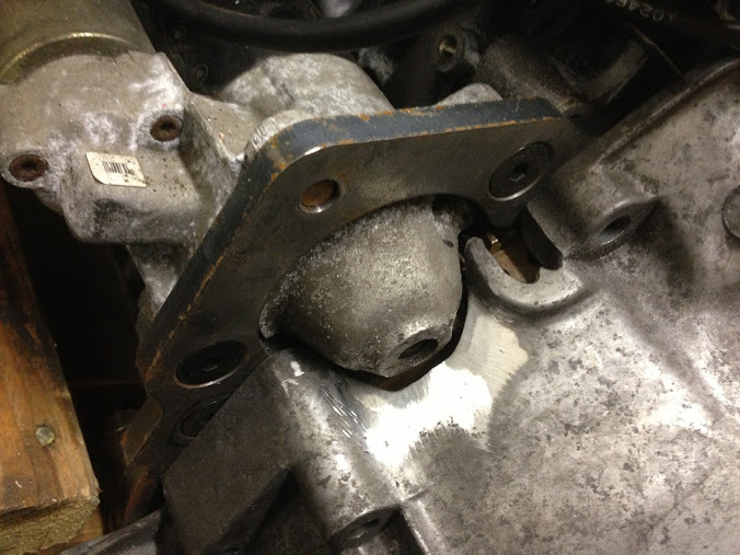

    Today i had a second shot at modifying the bell housing to fit, this is what i came up with...much better than before! Still want to do some welding to clean it up but im much happier
    Clearance for starter, crank position sensor and heater hose coolant port.

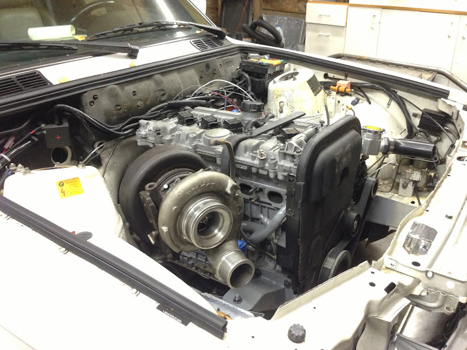

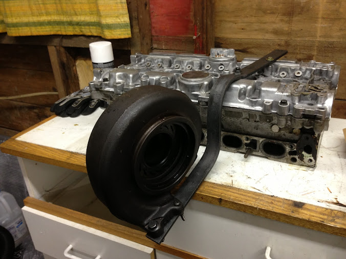

    Aquired one he351ve turbo, this has the variable vane turbine and when the vanes are closed allows for 5cm2 and when all the way open 25cm2! Just need to be able to control the vanes which is possible mechanicly or electronically, will be setting up a manual controller at first.
    Also finally split my space g260 so i can do a nicer job of modifying the bellhousing
    Decided the position of the turbo and made a simple jig to hold in place so i can bolt it to a spare head and block and build the header at work.
    This makes me so happy, i love big turbos :rofl:
    and yes i accounted for the 1/4" lower that the turbo will sit because of the jig.

  • Vtec?lol
    replied
    Bolting that on looks like it's going to suck!
