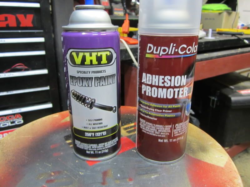

      Originally posted by irish44j
      After significant use of scotch-brite pad to get rid of the sheen, and adhesion promoter, did 3 coats of NHT epoxy paint in matte black on the entire chrome frames, mirrors, b-pillars, ...
      I'd like to know more about the adhesion promoter and the epoxy you used.

        ask and ye shall receive
        bought at local auto parts store

          Aaah, now I see. VHT = Very High Temp... I think it said NHT (typo?).
          I looked up NHT Epoxy, and it was some sort of industrial pipe coating.
          It looked like it was made to be really thick, like truck bed liner stuff.
          Thanks! I need to do the window trim on my 318i.
